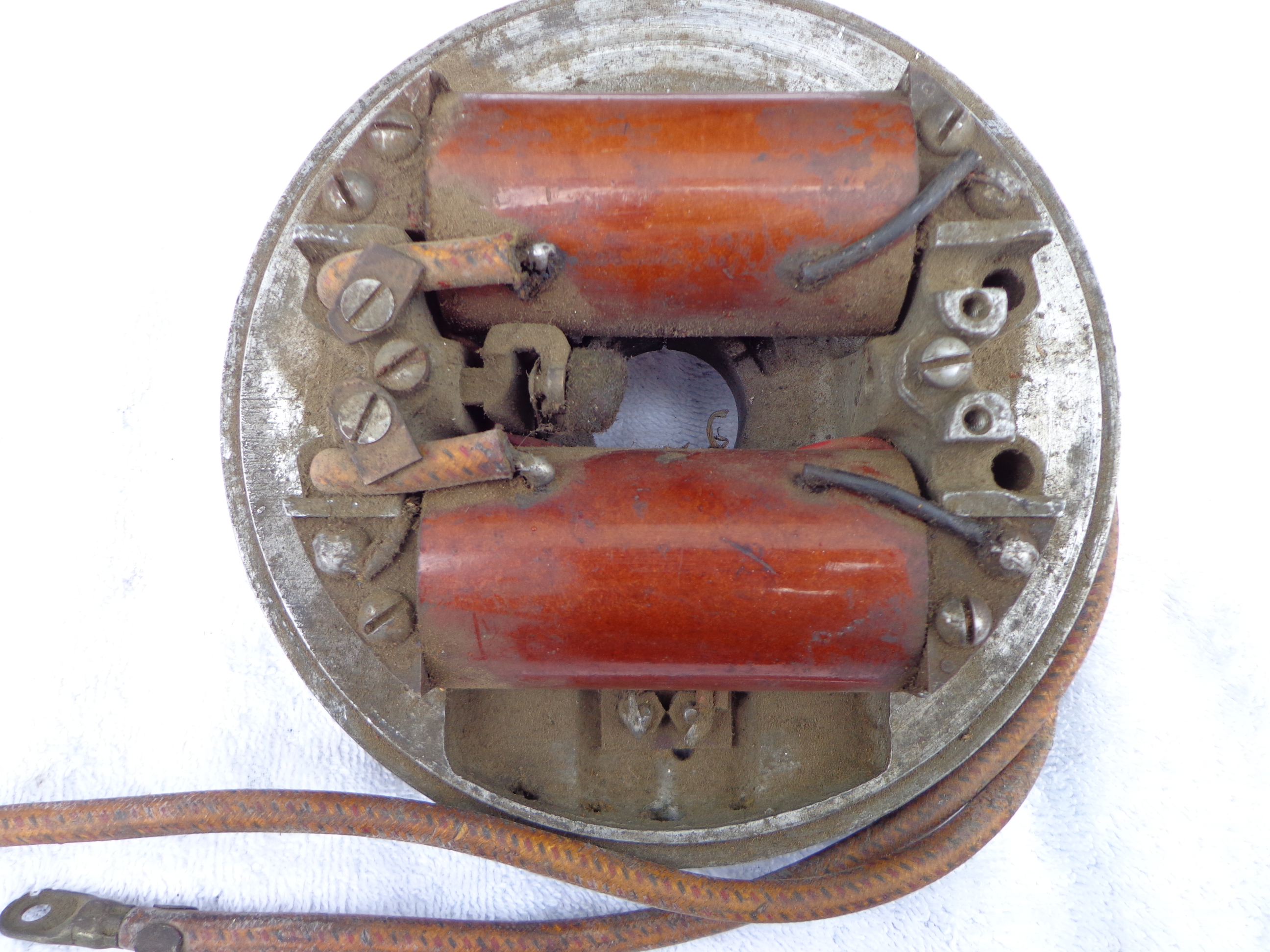

        #84692
          That’s exactly what was done with this mag and I’m betting it delivers a real hot spark!.
