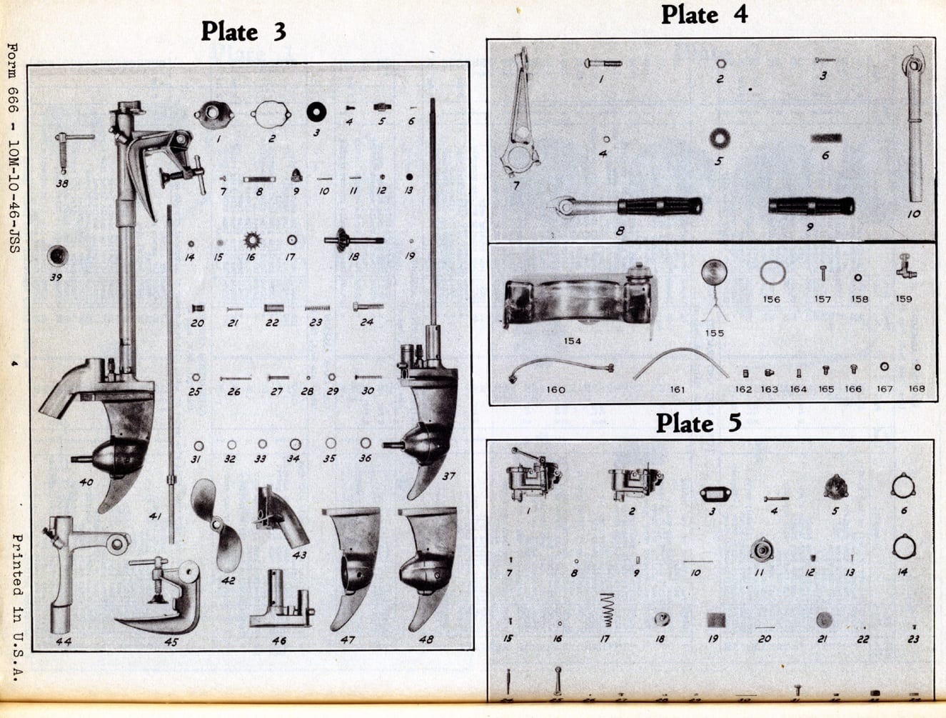

            #232709
              This is a 1937 Handitwin. I believe some of the later ones had the gas cap
              in the middle. Where’s yours?
              37-Elto-4212-parts
