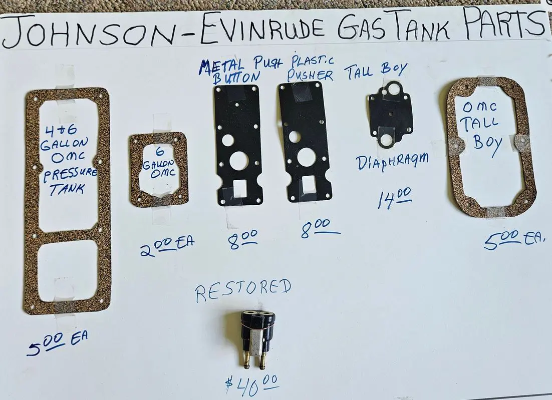

January 27, 2026 at 9:52 pm #303963I got mine from Elton Duffy, aka “The Gas Tank Man” on facebook.
https://www.facebook.com/groups/49655829434/user/100084502405741/
Snip of his parts pic:

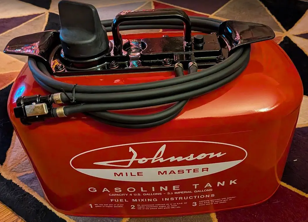

Here’s mine, restored very recently using parts from Elton:
