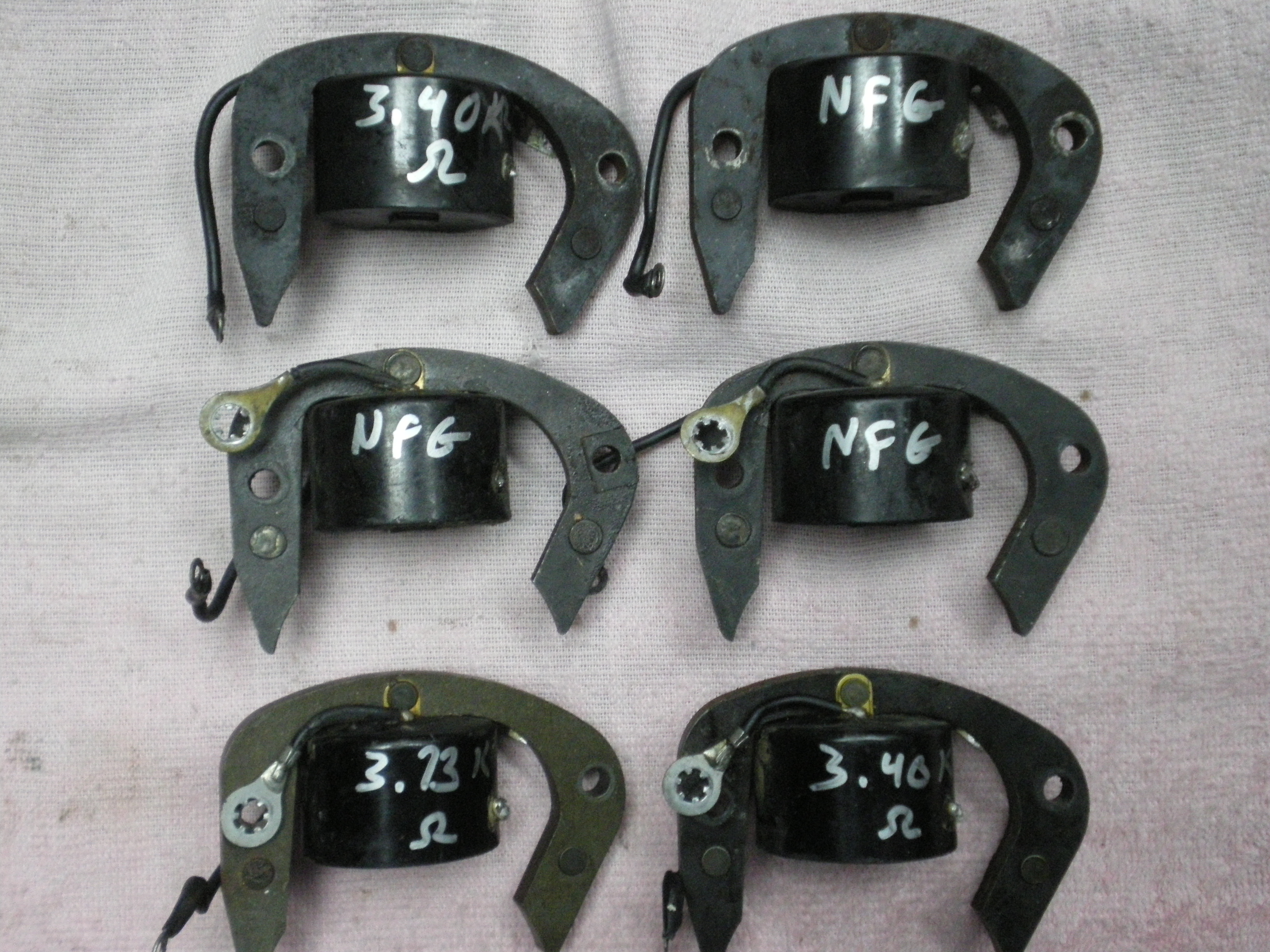

                      It might be your coils and not your meter. I was batting 500 the day I checked these HD coils.
                      #54904
                      fisherman6
                        NFG = No Finish Grind 😆
                        NFG = No Fit Gauge 😎
                        -Ben
