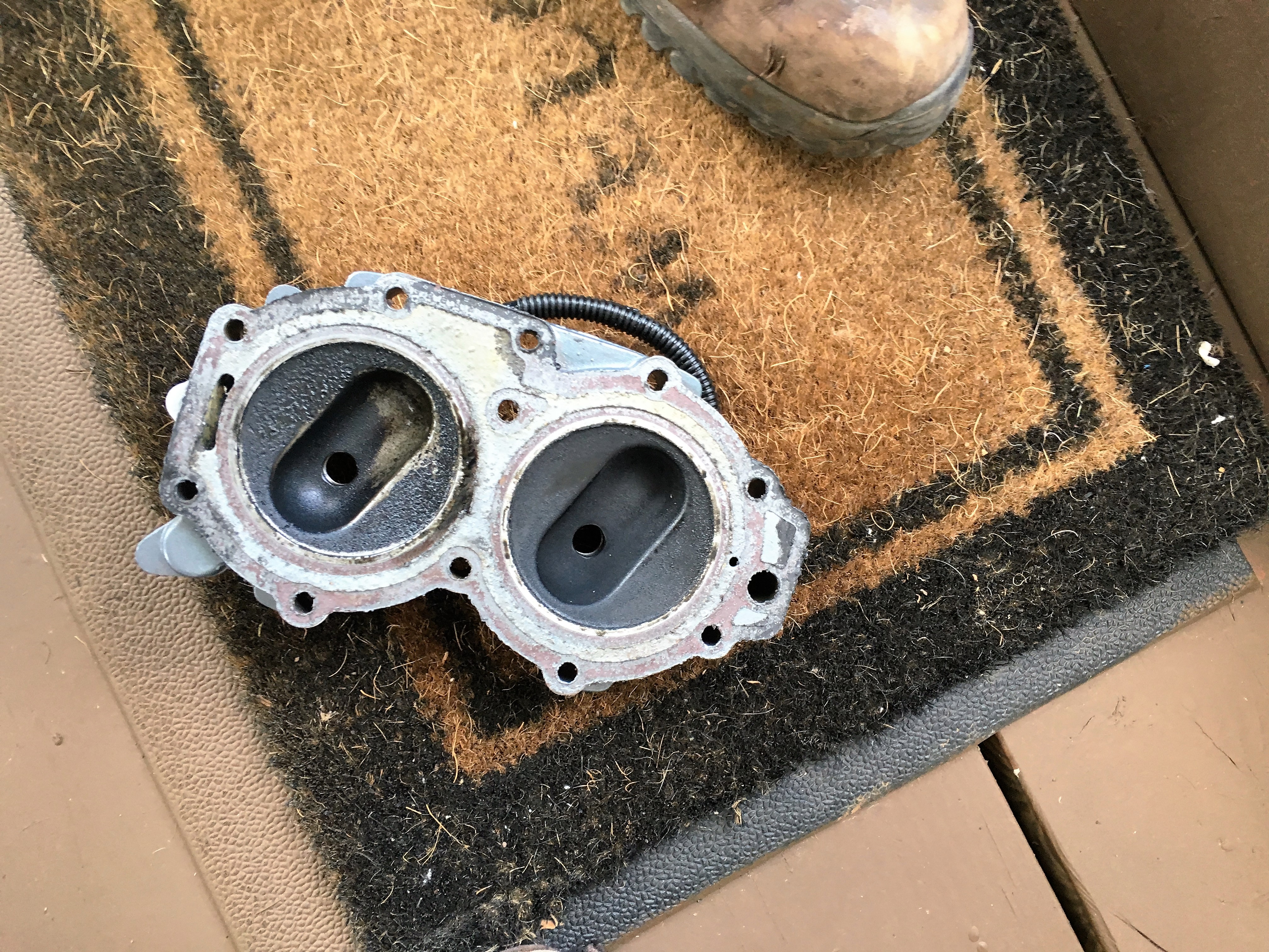

June 1, 2016 at 11:29 am #37514I took the inner exhaust plate/s off yesterday and they looked to be o.k gaskets looked good with no visible signs of a leak on them. That will eliminate them as my problem of water getting into top cylinder. I am now waiting on my used cylinder head to see if that will hopefully fix the issue. Has anyone ever had a cracked cylinder head on an outboard that was letting the water into the cylinder ?? I have rebuilt this motor because it had thrown a rod and this cylinder head had been damaged with metal debri where the piston had gone up against it using the debri. The motor had ran fantastic for about 12 hours run time until about 1 week ago it lost a lot of power and won’t run high speed so that is when I suspected the cylinder head. I took a picture of it so someone that knows can look you may have to zoom in on pic.

June 1, 2016 at 12:04 pm #37516Not a Yamaha expert by any means…
But, you mentioned this engine had thrown a rod, so there is the possibility of cooling system damage caused when the rod went thrashing about inside the block…
BUT, I am not convinced you have a water leak. I am assuming that the combustion chamber on the left of your picture is the top/problem cylinder, correct? Yes, that cylinder is misfiring/not firing for some reason, but I am not convinced water intrusion is the problem. Do you see actual water droplets on the piston cylinder/head, or is it possible that the cylinder is just being washed clean by excess fuel?

Again, have little to no Yamaha experience, hopefully someone who does will chime in….June 1, 2016 at 12:17 pm #37517Your right I have been driving myself crazy looking for a water leak. I am not convinced it is either. I did not see water droplets on the piston nor cylinder head when I removed it. I was also thinking that excess fuel might clean the head off. This is when the problem started. I was putting sound reduction material inside the cover because it had none. Where the hole for the air is in cover to be sucked through to run engine I thought I would make the opening like a 1 inch square hole and make it bigger if need be to eliminate unwanted noise it should have been like a 1.5 inch by like 3 inch hole. When I placed the cover on the motor is and tried to start it is when the problem occurred. Do you think I might have bent a reed valve/s or caused a leak between the case halves? I also read that a bad fuel pump can push fuel into the engine? I have had an engine in the past that did have a head leak and it would run out of water right not in water as you mentioned. I have the boat on water right now it may be time for me to trailer it to confirm or eliminate the water issue. Thank you for your help.

ps your right the top cylinder is the one not firing correctly. Looks like it has been cleaned.
