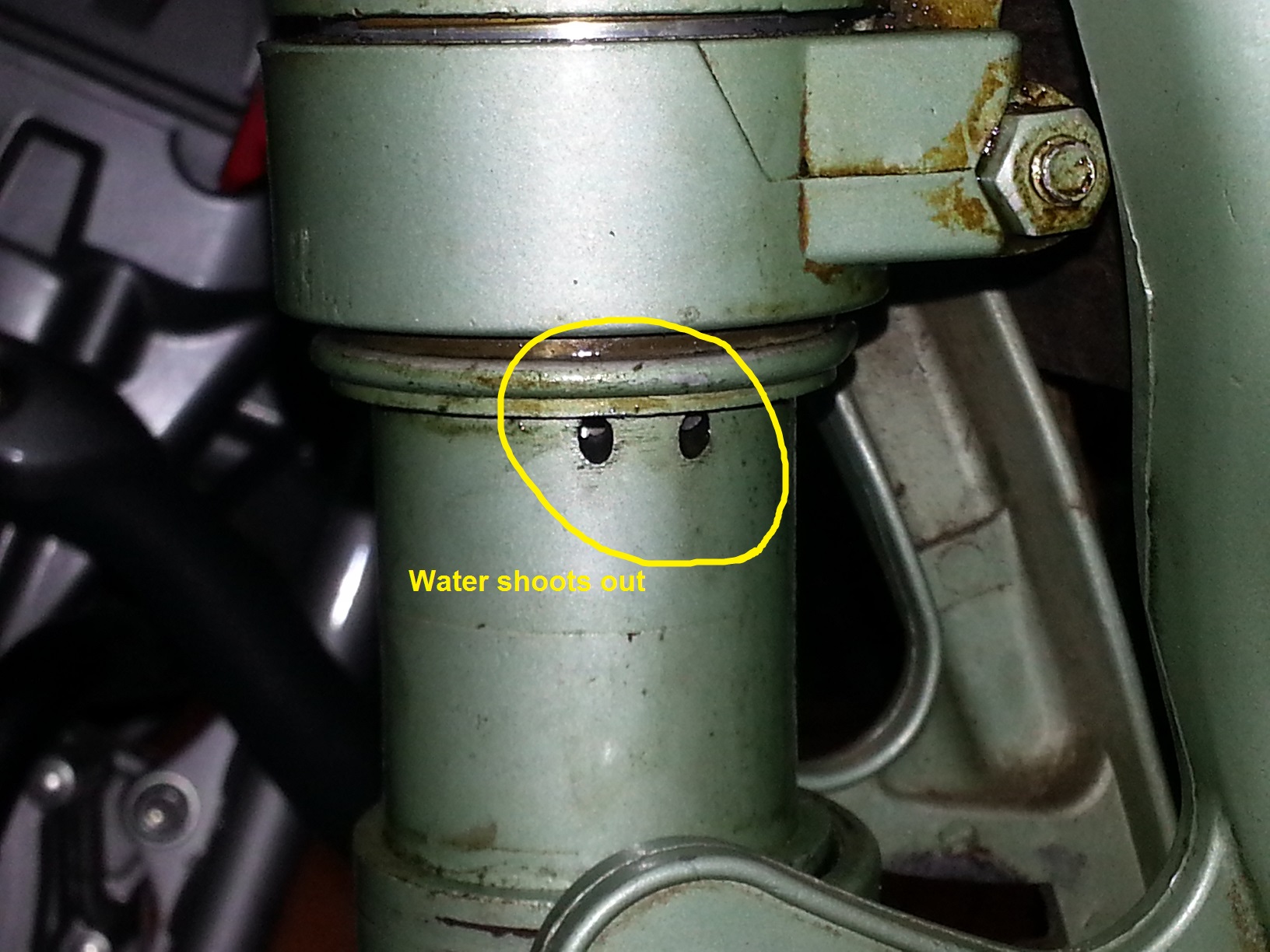

I’ve been resurrecting a 1950 TN26 that’s been sitting for 49 years and it now starts and runs on one pull. It spits water out of the tell-tale. It has two issues:
Once it’s been running 5 minutes or so, it starts to run roughly and spit out the slow needle port. If I put it in gear and throttle up, it will start to bog and will stall within a minute or so. (running in a barrel)
Also it is spitting water out of the top of the driveshaft tube through two small slits on the side of the tube. I don’t think that’s supposed to happen.

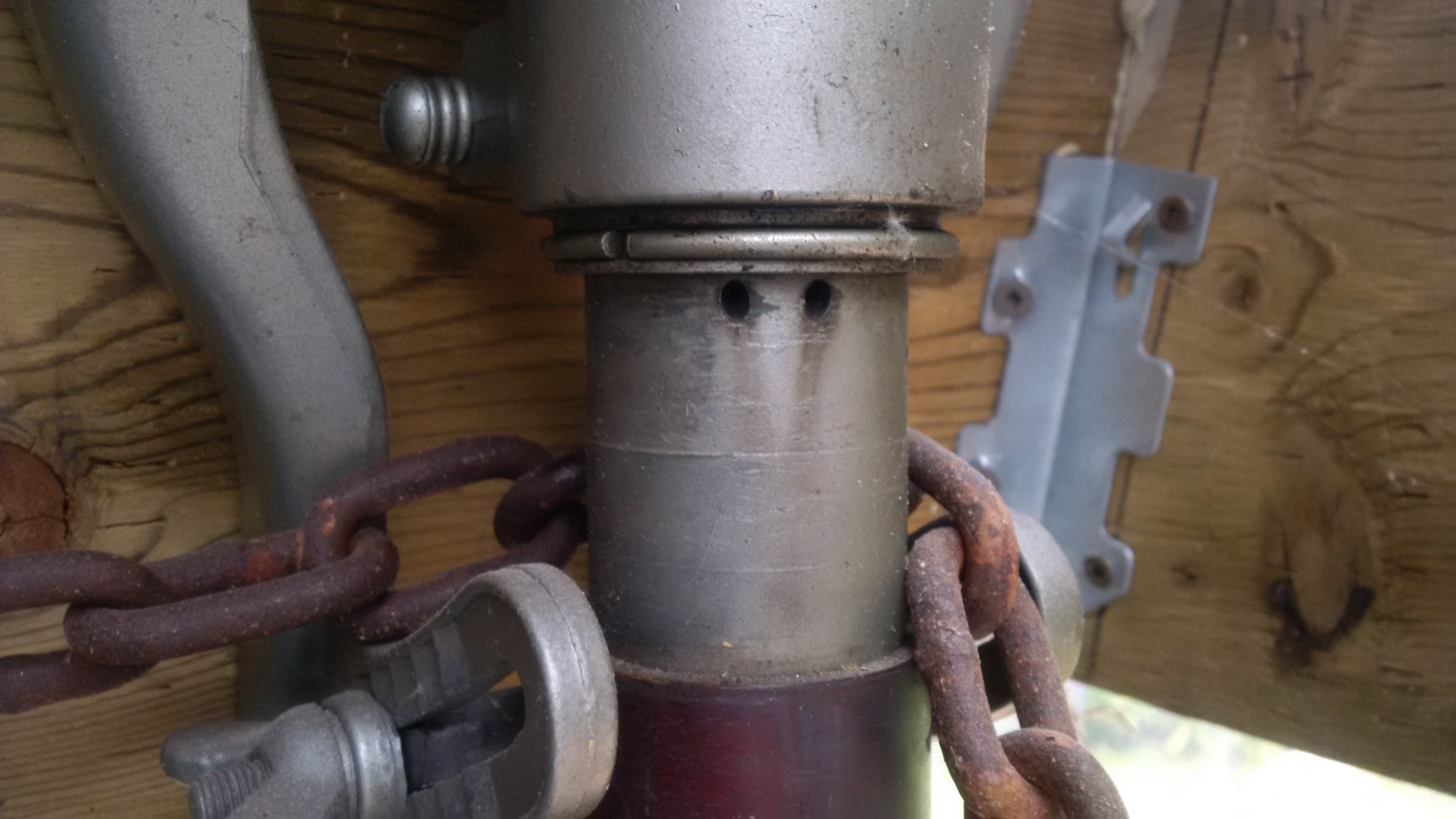

I’m not sure what slits you are speaking of, but it probably is normal. Probably exhaust relief ports. Spent cooling water goes out with the exhaust. Perhaps somebody with a TN can look and confirm.
July 8, 2016 at 1:43 am #39840July 8, 2016 at 1:56 am #39842July 8, 2016 at 2:15 am #39843Sorry, It’s been a while since I’ve had this one running so I don’t remember noticing water coming out those two holes. š³
July 8, 2016 at 6:53 am #39848Idle relief ports?
July 8, 2016 at 10:20 am #39854Exactly, they are exhaust relief ports to reduce back pressure for easier starting and better idle. And the cooling water that has gone through the powerhead and done it’s job does blow out those holes. It was on it’s way back to the lake anyway.
July 8, 2016 at 11:09 am #39856Frank over the past few years I have learned so much from you I just want to thank you. You remind me of my Hudson mentor in 1961 (Al Wolf) who took me as a kid under his wing, showed me the ins-out of Pre WWI Knox, Hudsons etc.He made me the 1948-54 Hudson expert that I became . Now I have downsized and gone to the outboards. Take care but your knowledge lives on to all who want to learn.
July 8, 2016 at 11:14 am #39857Water spray from the exhaust relief ports is 100% normal. It would be of concern if there was no water coming out of those ports.
