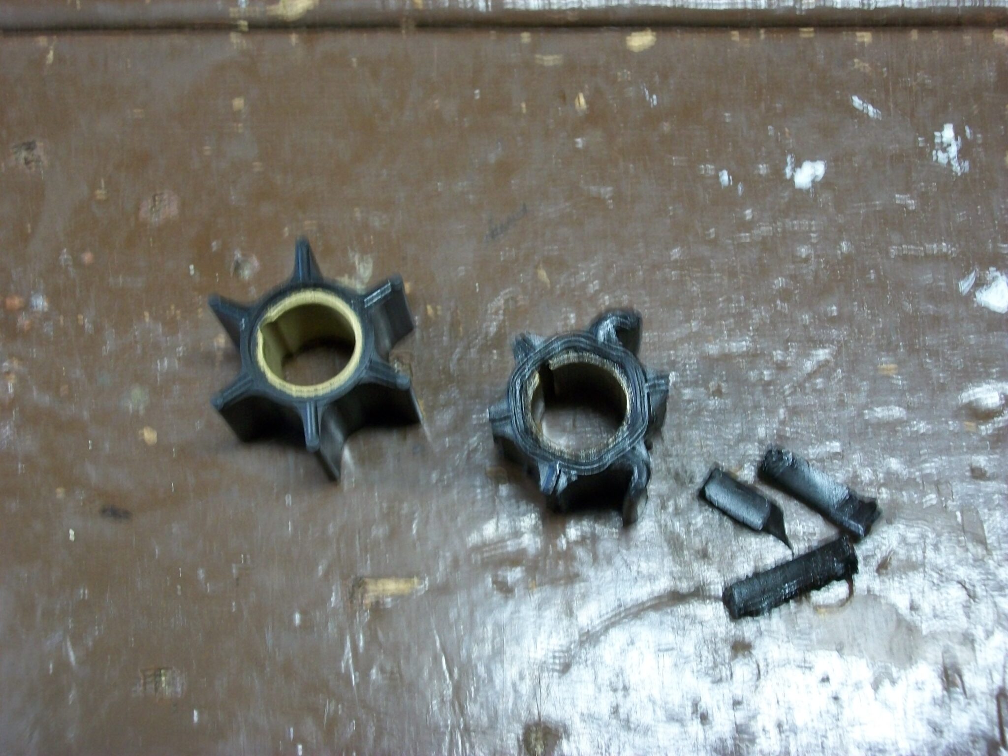

      Doing the infamous impeller replacement on a ’58 Mark 10.  Yep, the one that takes about 50 times longer than the same job on a 10 hp OMC of the same year.  I’ve pulled the bearing, water pump housing, liner, impeller, and washer out of the tower housing.   The impeller housing has an O-ring that goes around its outer circumference.  Does anyone know where I can get one of these O-rings, or what the dimensions are for a modern equivalent?   Might also consider replacing the driveshaft seal that’s pressed into the end of the housing if one is available.   Looking forward to getting the motor on the water.  Powerhead is healthy with low hours and was test run for about 5 seconds.  Nice clean original; badge on the front is immaculate.  I think it’s the original impeller.  Got it from the original owner and from what I can tell, it was frozen in time maybe around 1970.  It still had the period-correct Quicksilver Aeromarine grease in it.

        Hello and welcome!  I have one of those Mark 10’s also.  The water pump is a real problem for sure.  Elmer K’s parts list are barely readable and in my opinion not much help.  I would suggest checking the hardware stores and maybe harbor freight for an O ring.  Hope you found an impeller.  Someone on here will probably chime in for one of those.  I found an impeller that I had to file the key way a little and if my memory serves me correctly I had to ream it out a little.  These motors run good and remember to be gentle when you shift it.

          I actually already have the impeller, the same one you do.  It’s from a Mark 28 and it works if you file the keyway from what I’m told.  It actually fits pretty good just jammed over the square key, but I don’t know if it would tend to wallow itself out and eventually spin.  Going to fiddle with it a bit with some keys that we have in our stockpile and maybe custom file a key to fit instead of the other way around.

            mark 25 etc had the same impeller but the keyway was round. that is the one to file. make sure the impeller is loose on the shaft, or it will not center and burn. make sure the water is above the lower Dyna Float to cover the pump..
