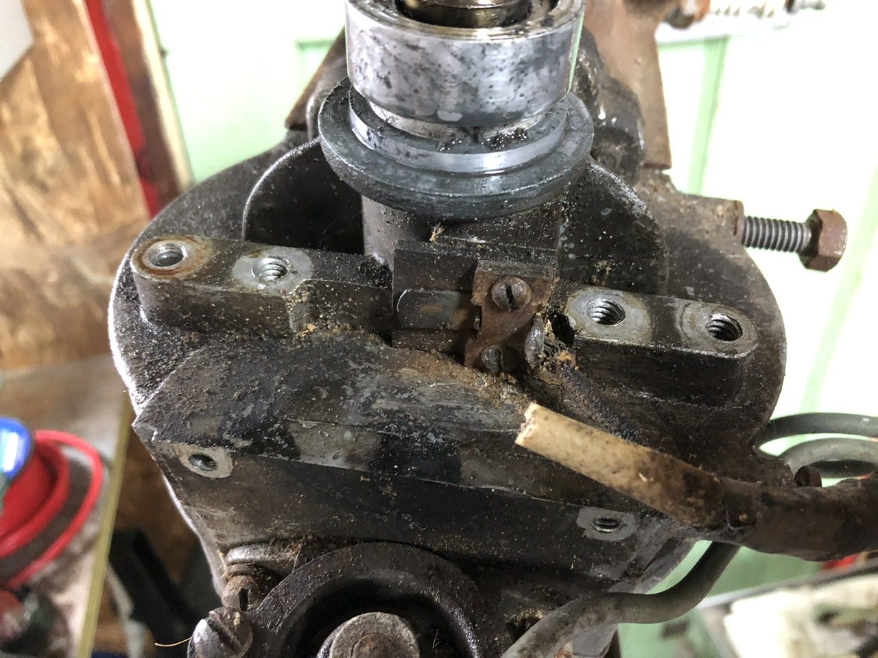

      I disassembled a 1939-ish Waterwitch Mae West Single and can’t remember how the kill wire is hooked up. It appears to have a contact mounted to the front of the crankcase below the magneto and something must bump that on the slow end of the throw for the plate. Then a wire goes up to the points to short the mag. But what hits the kill contact?
      I’m lost!
      Greg

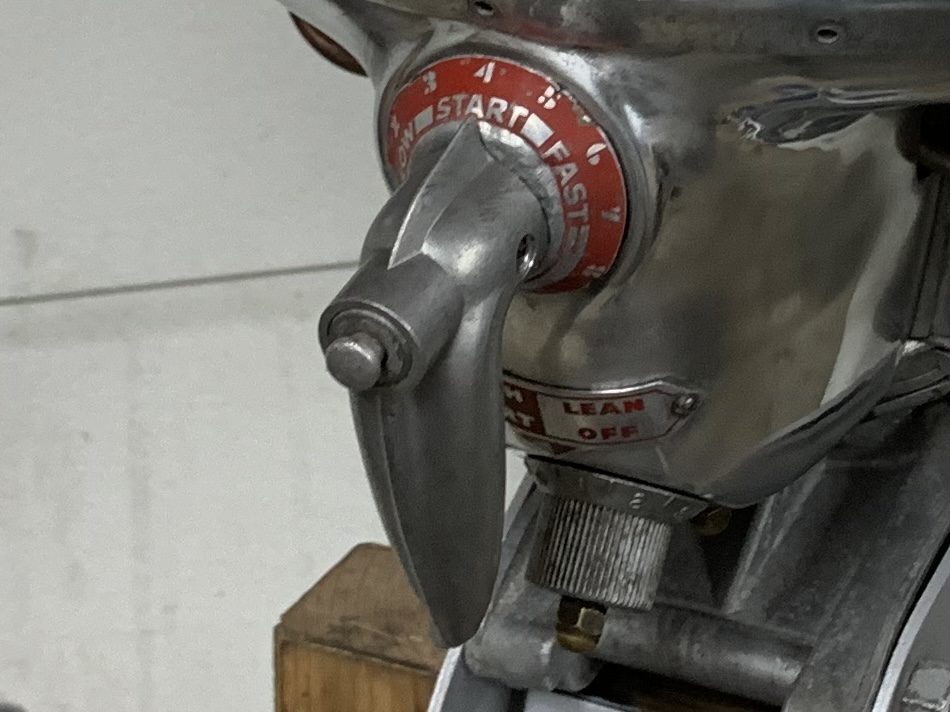

        Button on the end of the throttle lever when pushed will ground the magneto.

          Thanks. I was bbq-in burgers and looked over and realized how it works. Brain-fart I guess.
