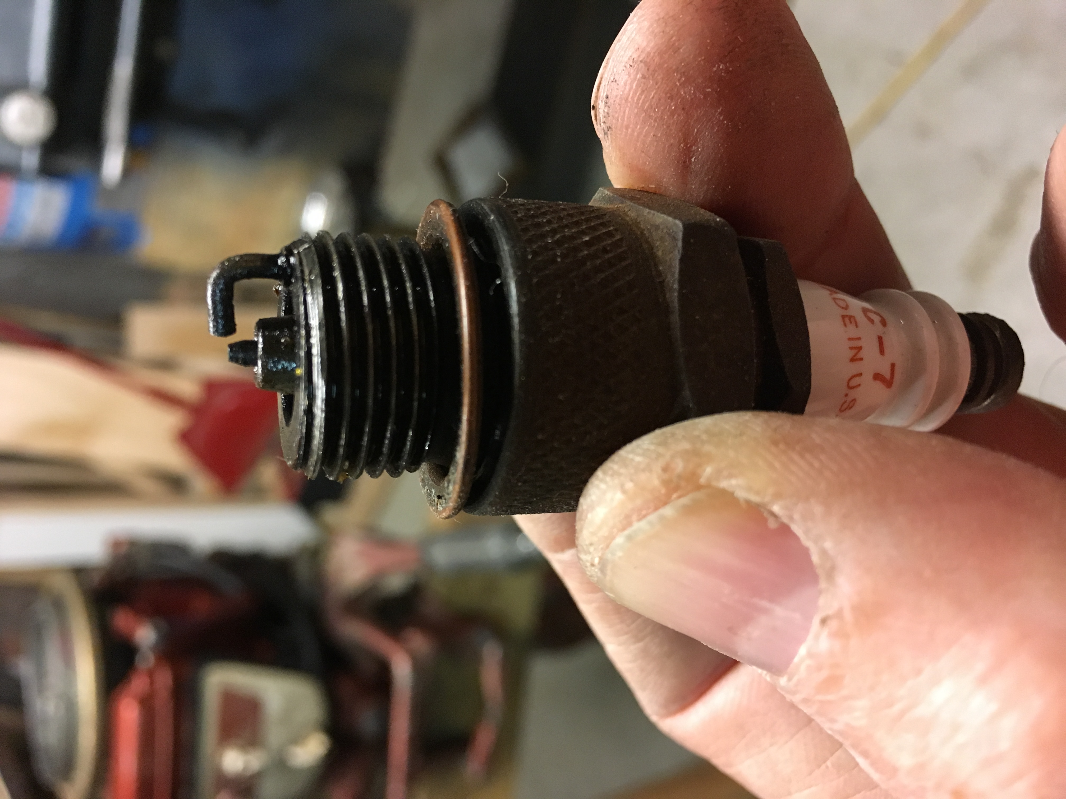

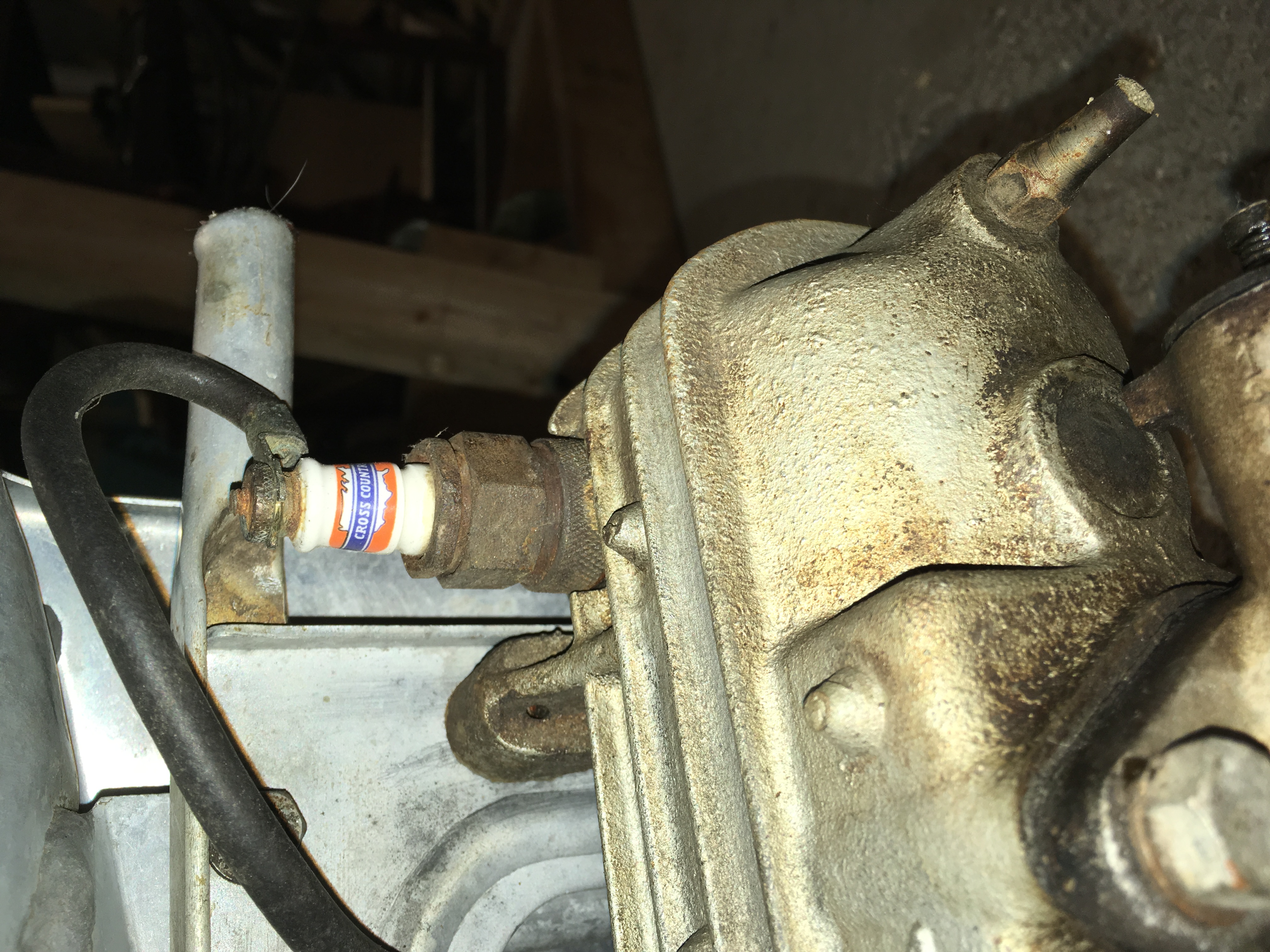

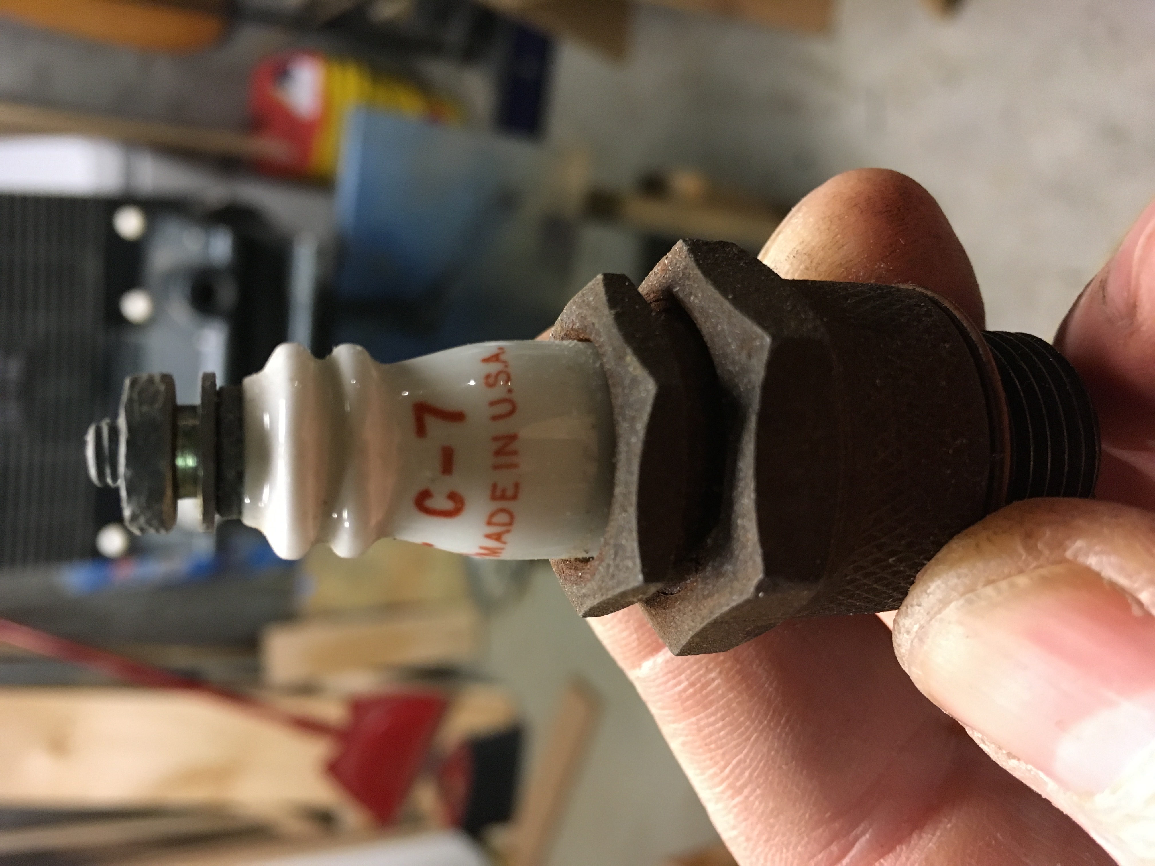

          david-bartlett
            I have a C-7 and a Cross Country in mine.
