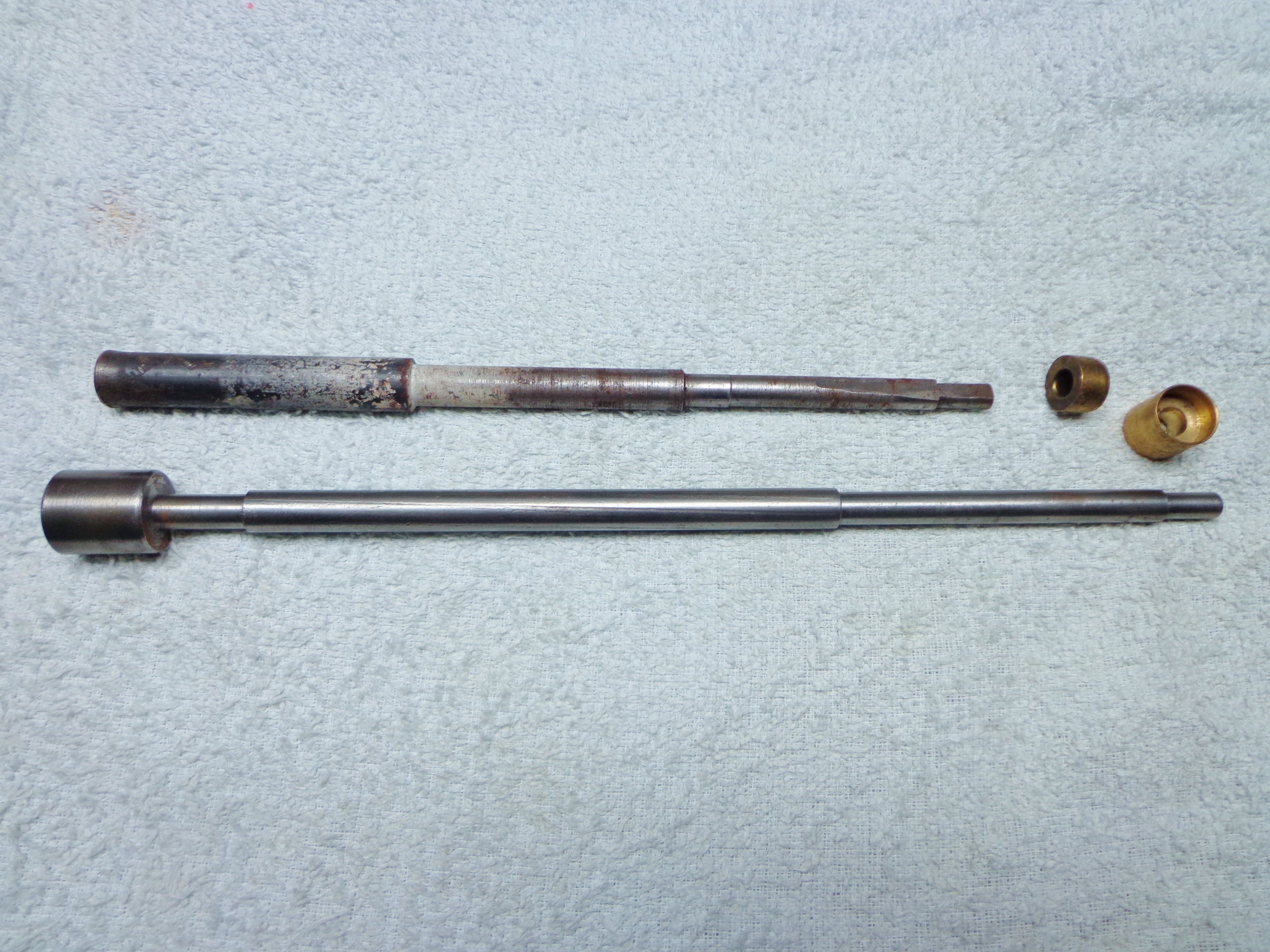

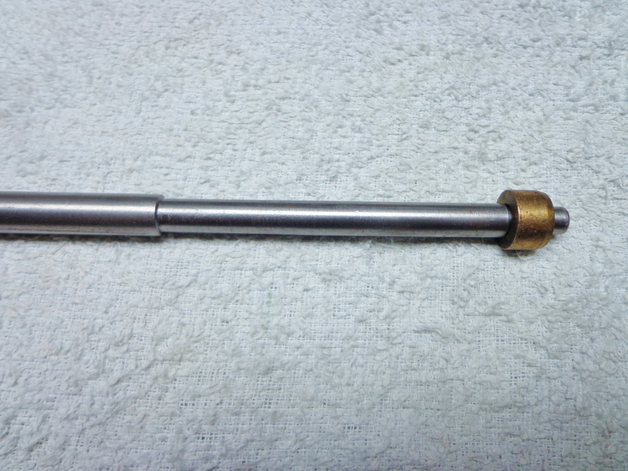

        My go to tool for this is my Starrett 5/16” pin punch. If that doesn’t do it, then tap the bushing a few turns with a 5/16 tap. Screw in a bolt and tap it out by tapping on the bolt from above.
        #69546
        aquasonic
          Frank Robb has some great information on his website: http://www.franksoutboardtools.com
          Improvise-Adapt-Overcome
          #69551
            If you can turn or grind down a bar of steel to use as a punch, you’ll be all set.
            #69554
            fisherman6
              This is assuming, of course, that you have the powerhead removed, shift rod disconnected, lower unit removed from the midsection, gearcase drained, skeg removed from the gearcase and all the internals out of it.
