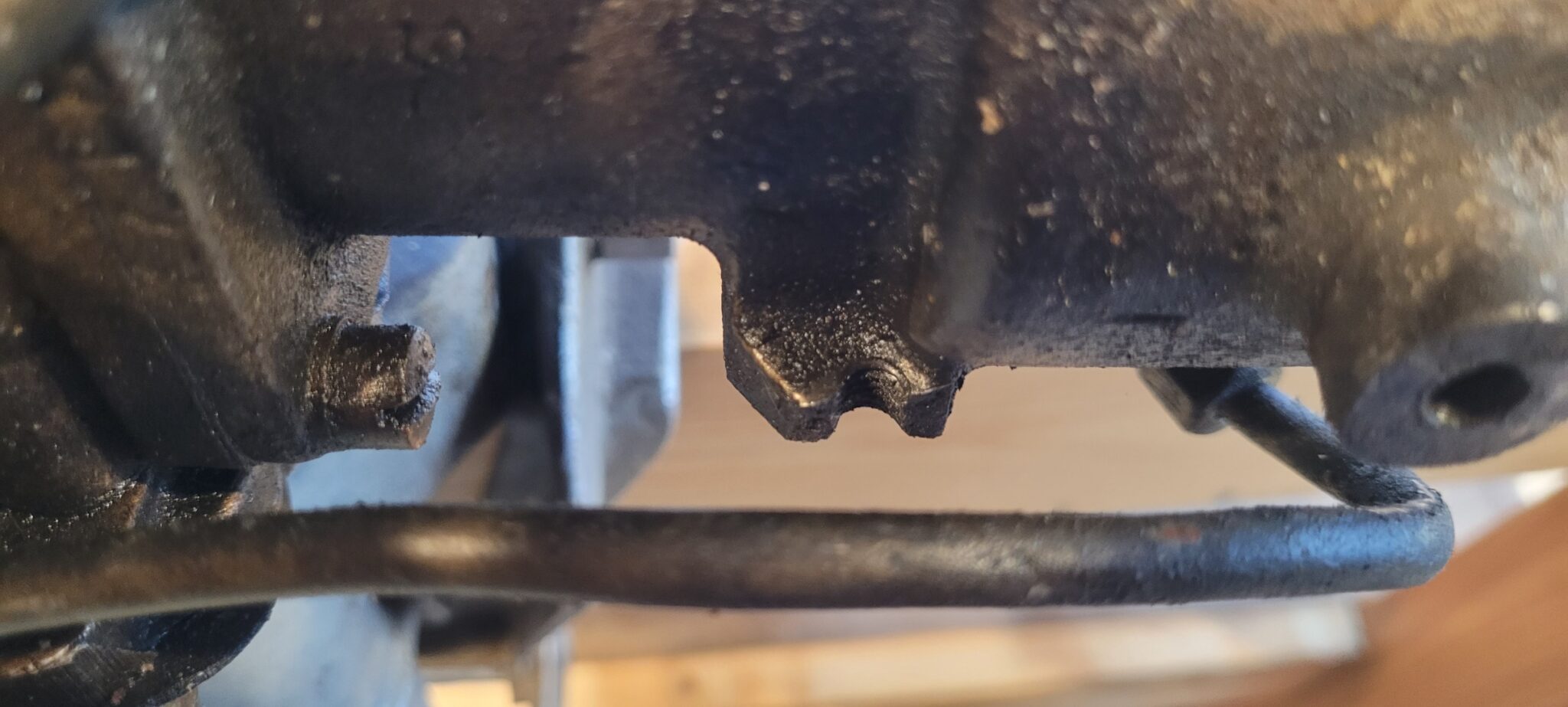

I recently made the same repair.
Mig weld around the copper tube
then drill it out when your done.
Do a little on each side till you
bring it together to avoided melting
the tubing.
February 11, 2024 at 11:39 am #284834Like the way you went about this.
Also answered my thought of having to pull the jug off to weld.
Looks good!
