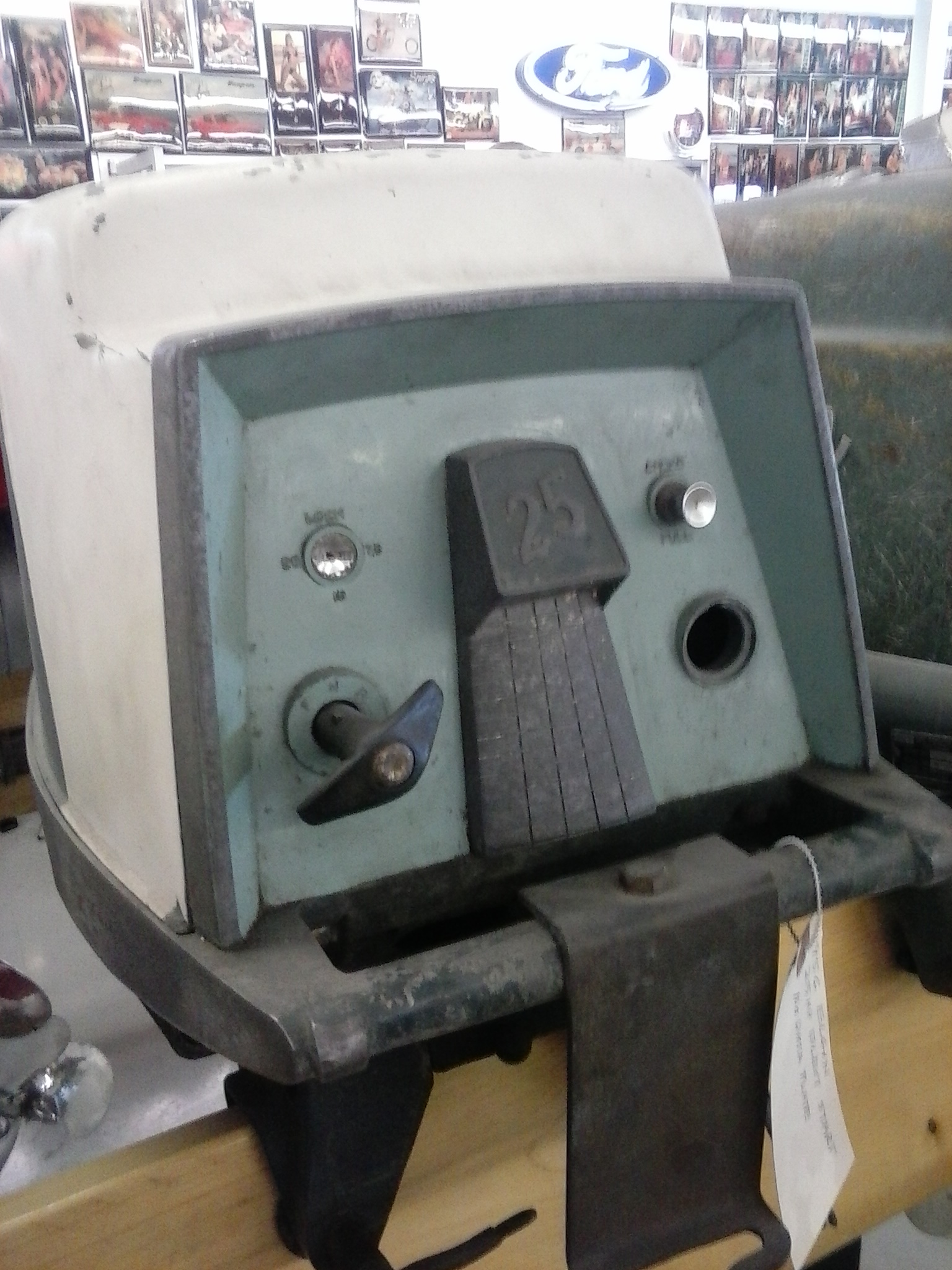

              jerry-ahrens
                I’d take a couple of those plastic gears. I’ve got a 12 hp elgin that has one of those. Mine had a freeze damaged lower unit, but a local member helped me out and sold me one. I’m anxious to get it on a boat!
                Ever seen a 25 hp model? I’d love to find one of those.
                #39517
                jerry-ahrens
                  Here is my 12.
