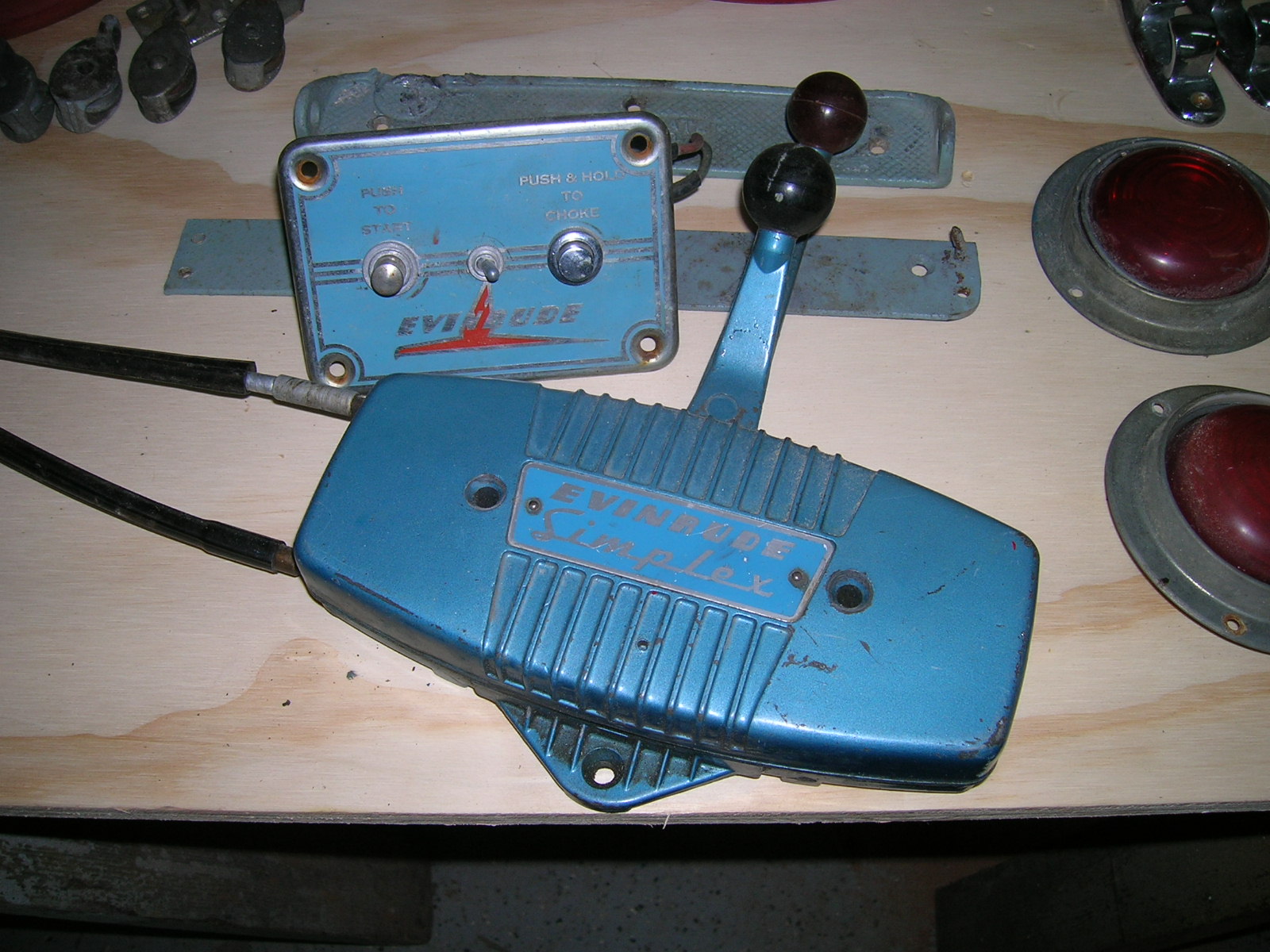

      I will need to find a ignition plate and all the associated stuff for that. What goes with it? Does anyone have a couple of good pictures? Part numbers? Shoot, I’m not even sure what they are actually called.
      Also, where can I find longer control cables for the throttle and shifter? I have a 50’s Evinrude box, but I’ll need cables probably 8′ long or longer. How much slack should they have? (meaning, what’s the minimum radius they can function at long term)

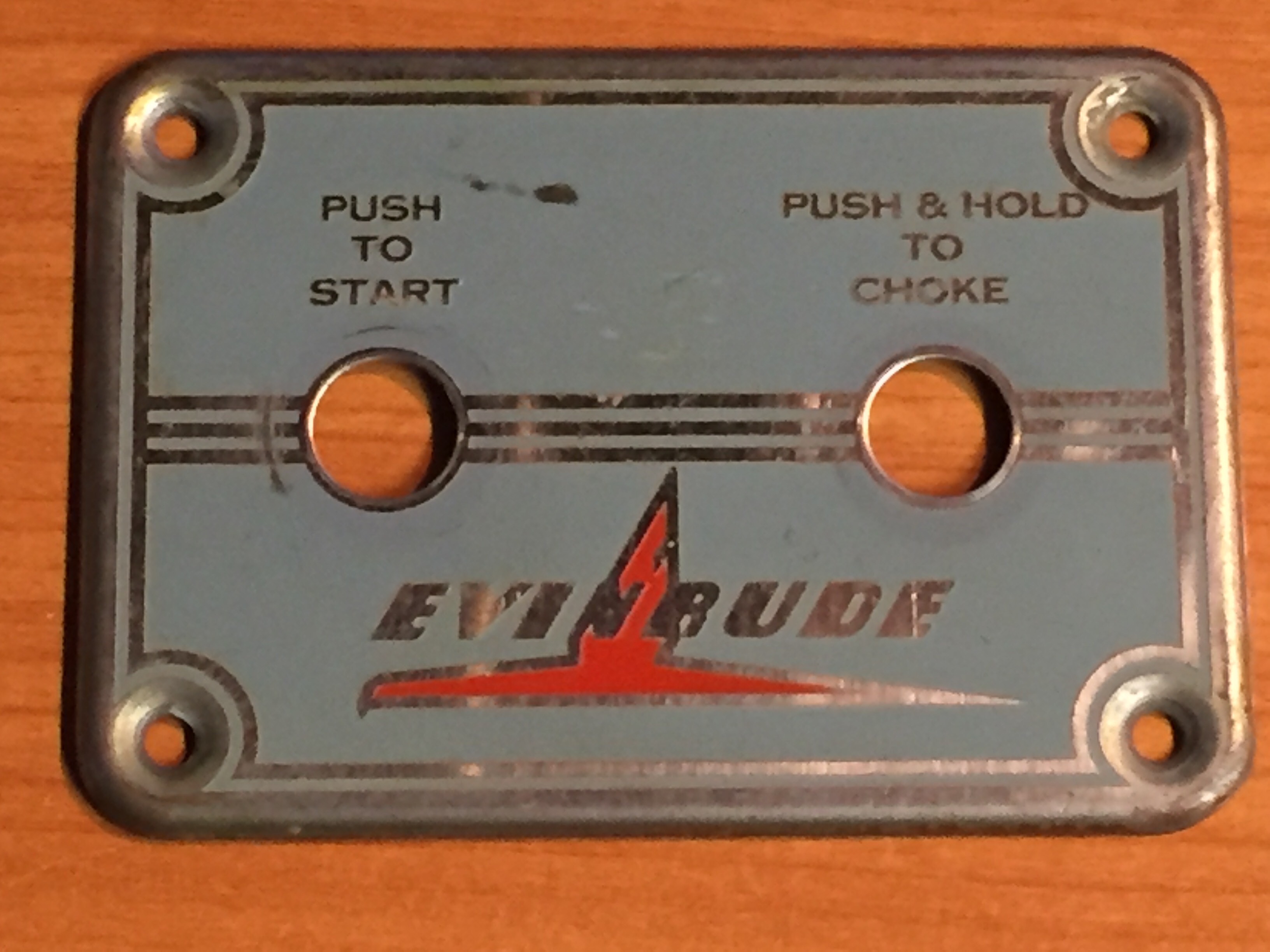

              This is the evinrude dash plate that would match those shift/throttle controls you have in your picture. It would be the correct plate for 1954 and 1955 evinrude electric start models.

                And this would be the correct dash plate for the 1956 evinrude electric start motors. 1956 year only.

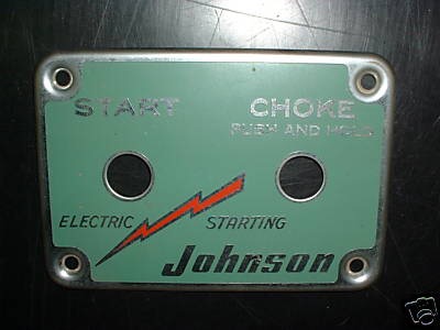

                      Would LOVE to find a Johnson version of this……

                        quote Richard A. White:
                        quote opposedtwin:
                        Like this one? They’re out there. Saw 2 at tomahawk this summer but yikes are they expensive!!
