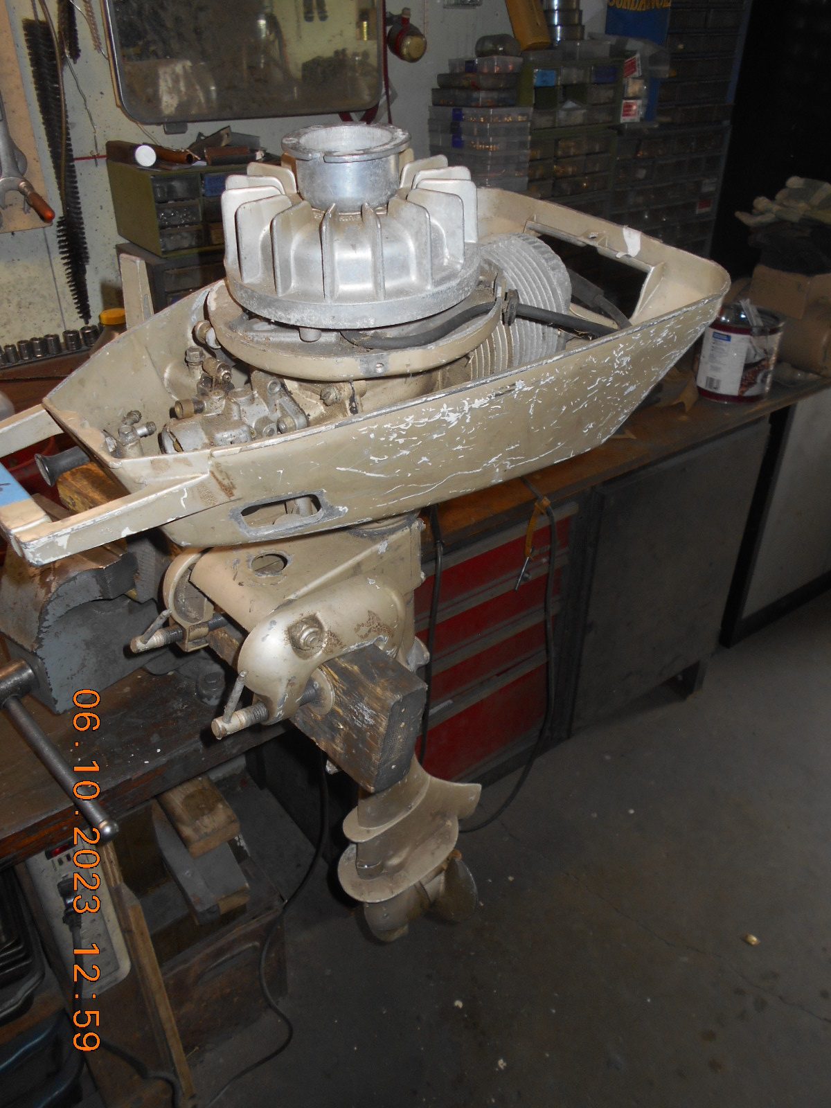

I’m scrapping rock bottom for different outboards to work on,
so I pulled this parts motor off the rack to check out.
No idea what year it is, or the “brand” for that matter.

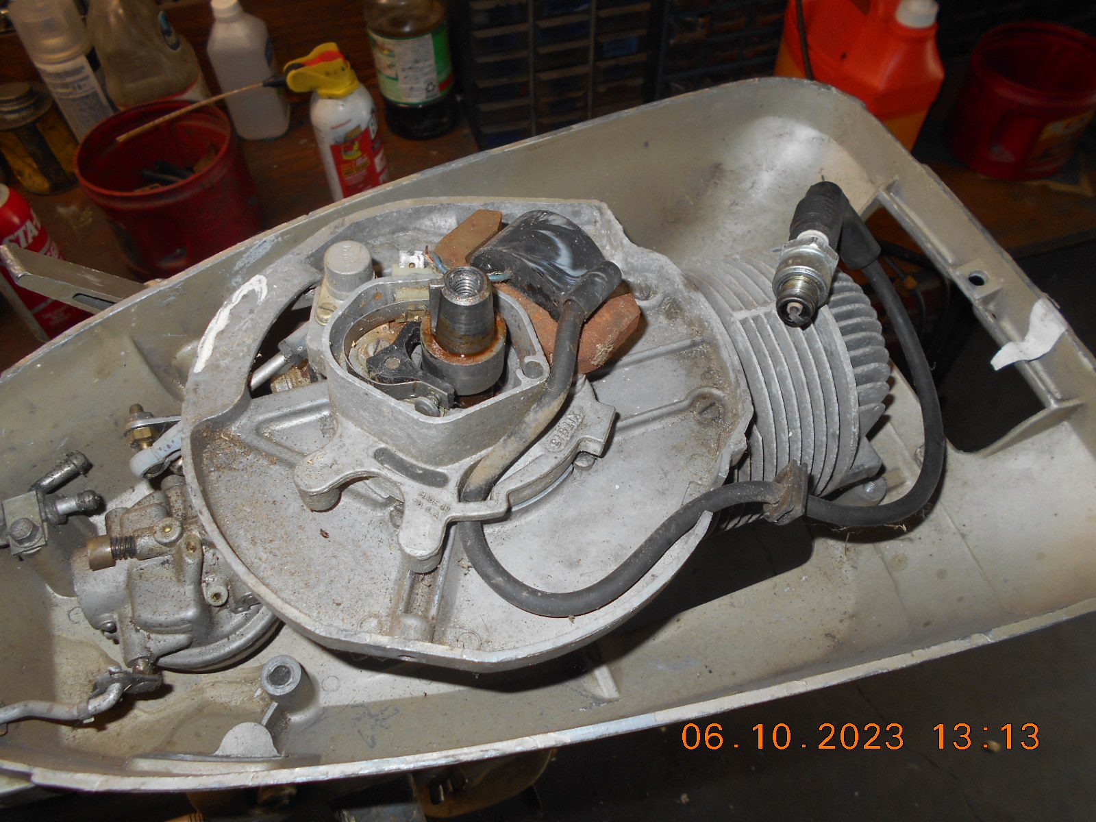

I cleaned the points, and got spark back, so I squirted some fogging
oil in the carb and it looks like it’s a “runner” parts motor, so the price just doubled, lol.Anyone recognize this model, and approximate year?
There’s no hood for it which doesn’t help.
It’s air cooled, one cylinder.
At first I thought it had a shift handler on the side, but soon realized it’s
just the throttle…… strange.VIDEO………
https://youtu.be/RWuxCxfmA0cPrepare to be boarded!
June 11, 2023 at 9:30 am #276933My first knee-jerk was Clinton, but that isn’t correct. I think it’s a West Bend, but not one I’m familiar with.
June 11, 2023 at 9:33 am #276934Thanks Frank, after a bunch of YouTube searches, I’m thinking it’s
a 1970 ish Chrysler 3.6 hp.Prepare to be boarded!

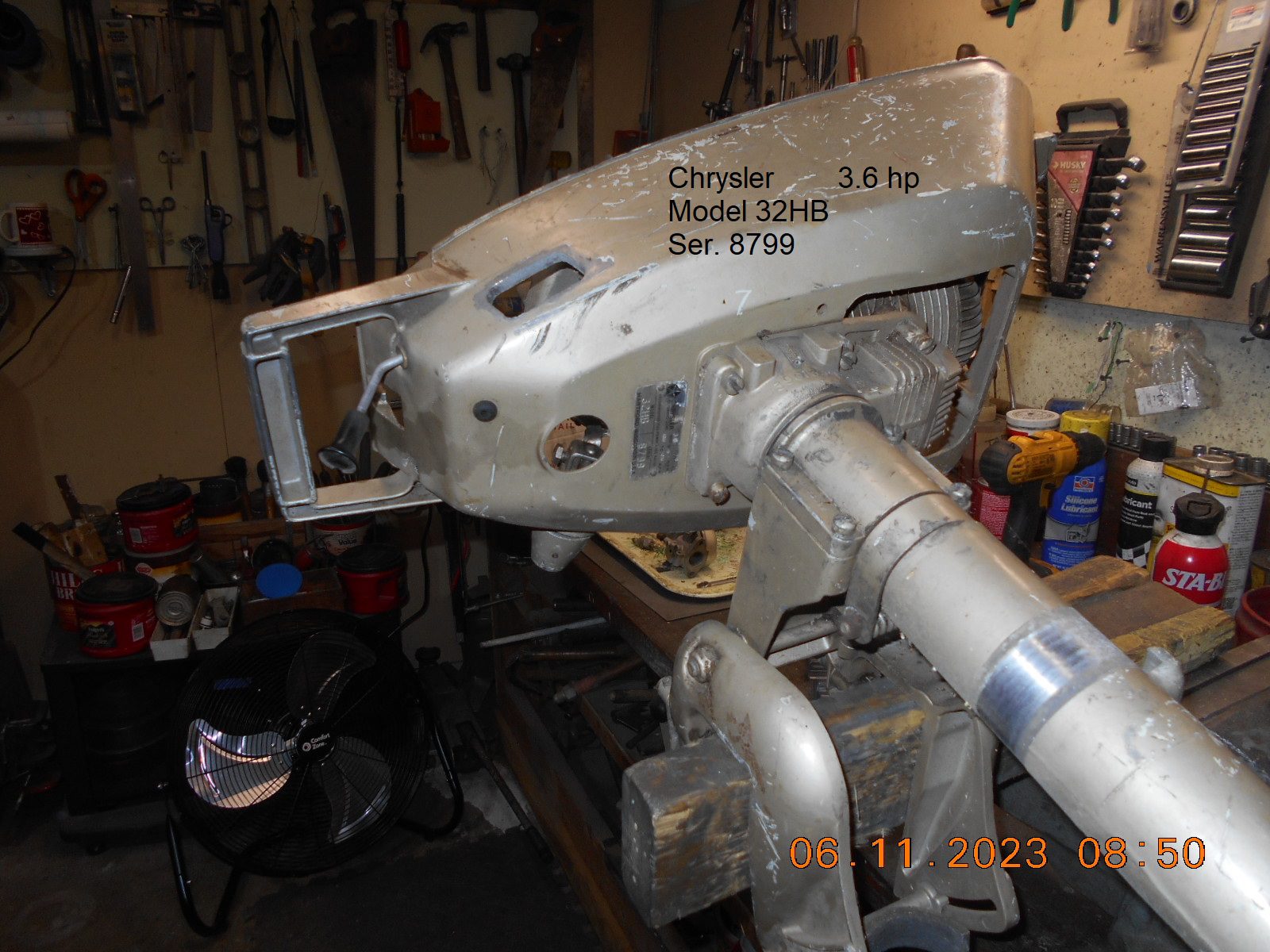

June 11, 2023 at 5:35 pm #276959Slim pickings on the racks for anything “new to me” to work on. Decided to check out this parts motor.

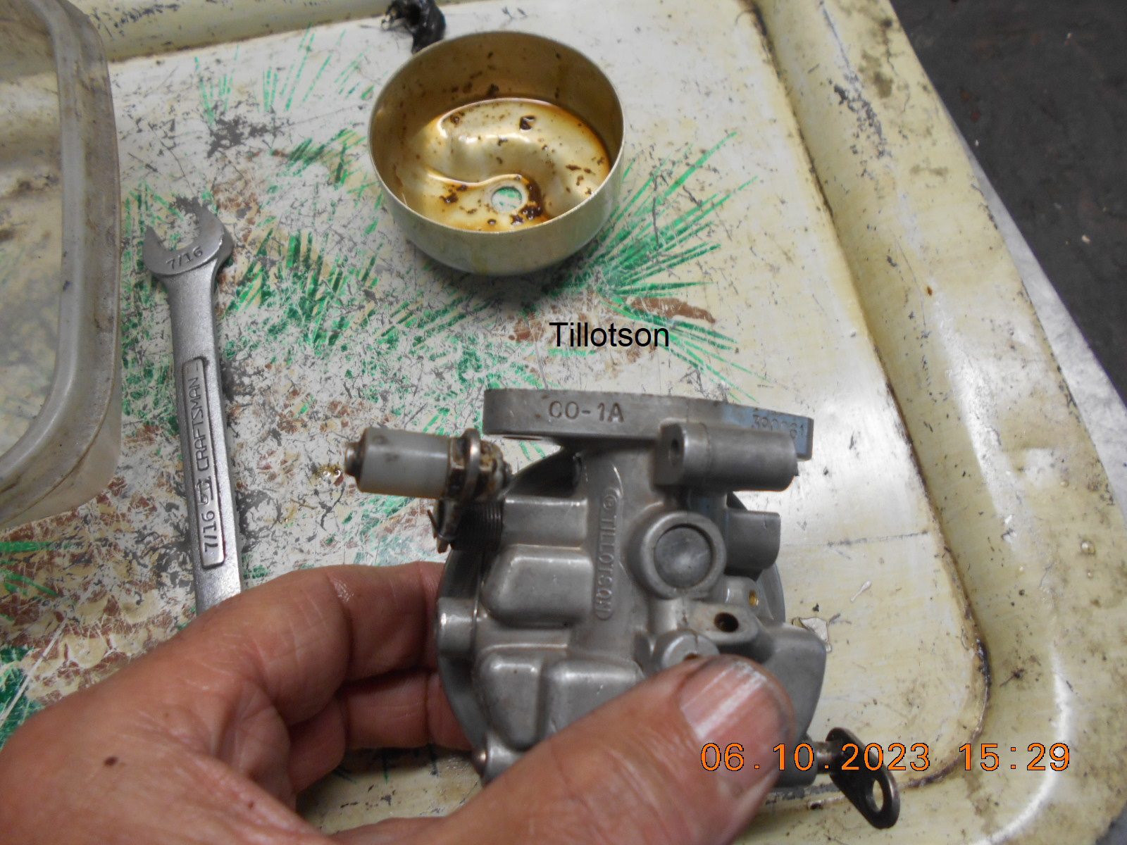

Gas tank, upper engine shroud, and hood are missing. Cleaned the points and carburetor, and it runs.
Good running parts motor for someone.When I first dragged this motor into the shop, I looked in all the normal places
for a data tag. Lo and Behold, when I tipped it way up to put grease in the lower
unit, I found the tag.From what I learned, it’s 1971 – 73 Chrysler, Model 32HB, Serial # 8799.
No idea on who actually made this air cooled powerhead.
VIDEO of Running Part Motor……
https://youtu.be/pTgrRW4DBo0Prepare to be boarded!
June 11, 2023 at 5:58 pm #276961It does look “Clinton-esk” … Power head reminiscent of the Sears Ted Williams air cooled motors
Joe B
June 11, 2023 at 6:09 pm #276962It does look “Clinton-esk” … Power head reminiscent of the Sears Ted Williams air cooled motors
Joe B
Thanks Joe!
June 11, 2023 at 7:25 pm #276965Nope, should be a West Bend powerhead. Derived from the West Bend kart engines that used to tromp my Clinton powered racing kart.
