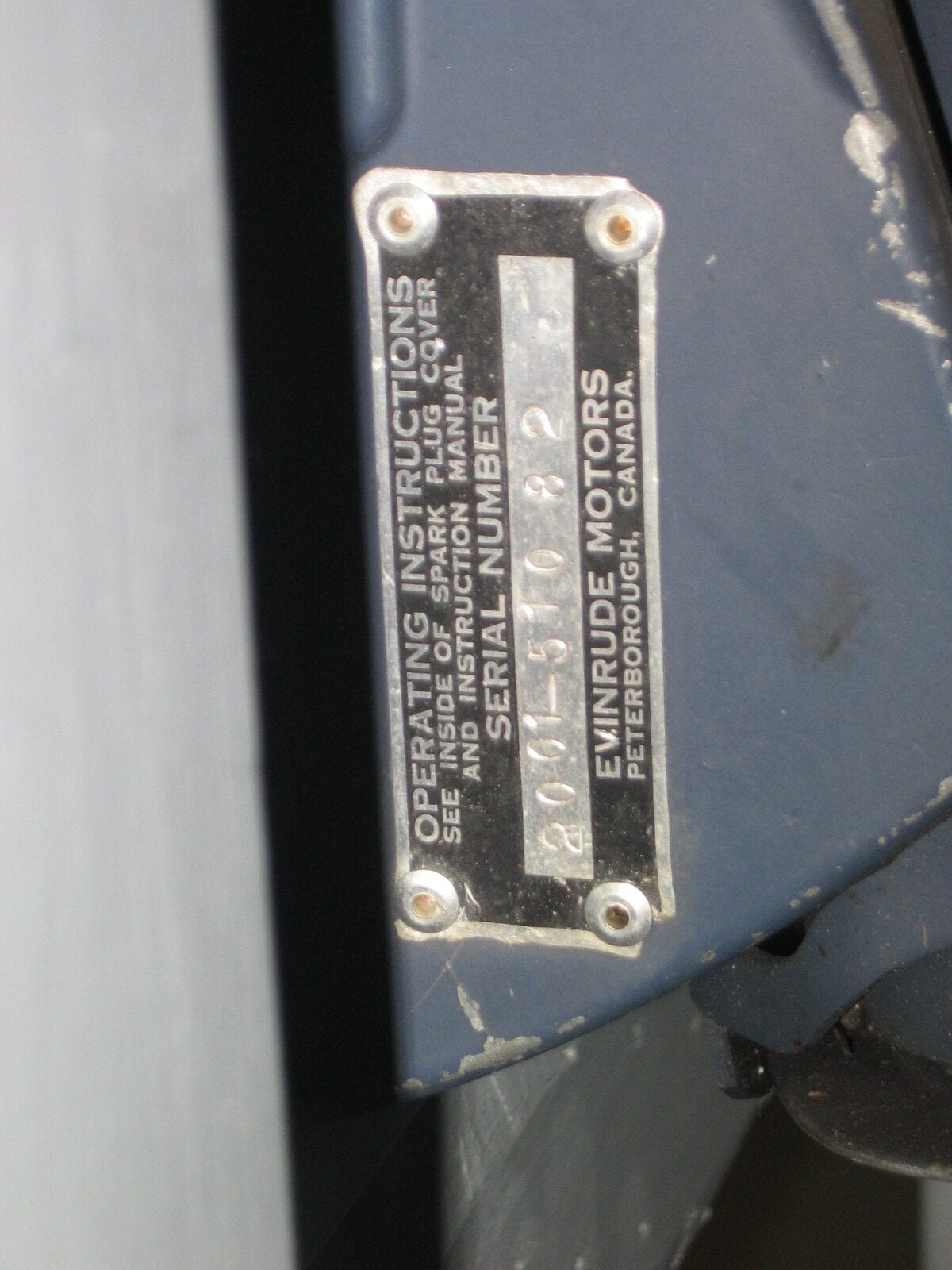

      can’t find a yeard # for the plate ID hood says 4 hp
      plated switched maybe… but what is it ???

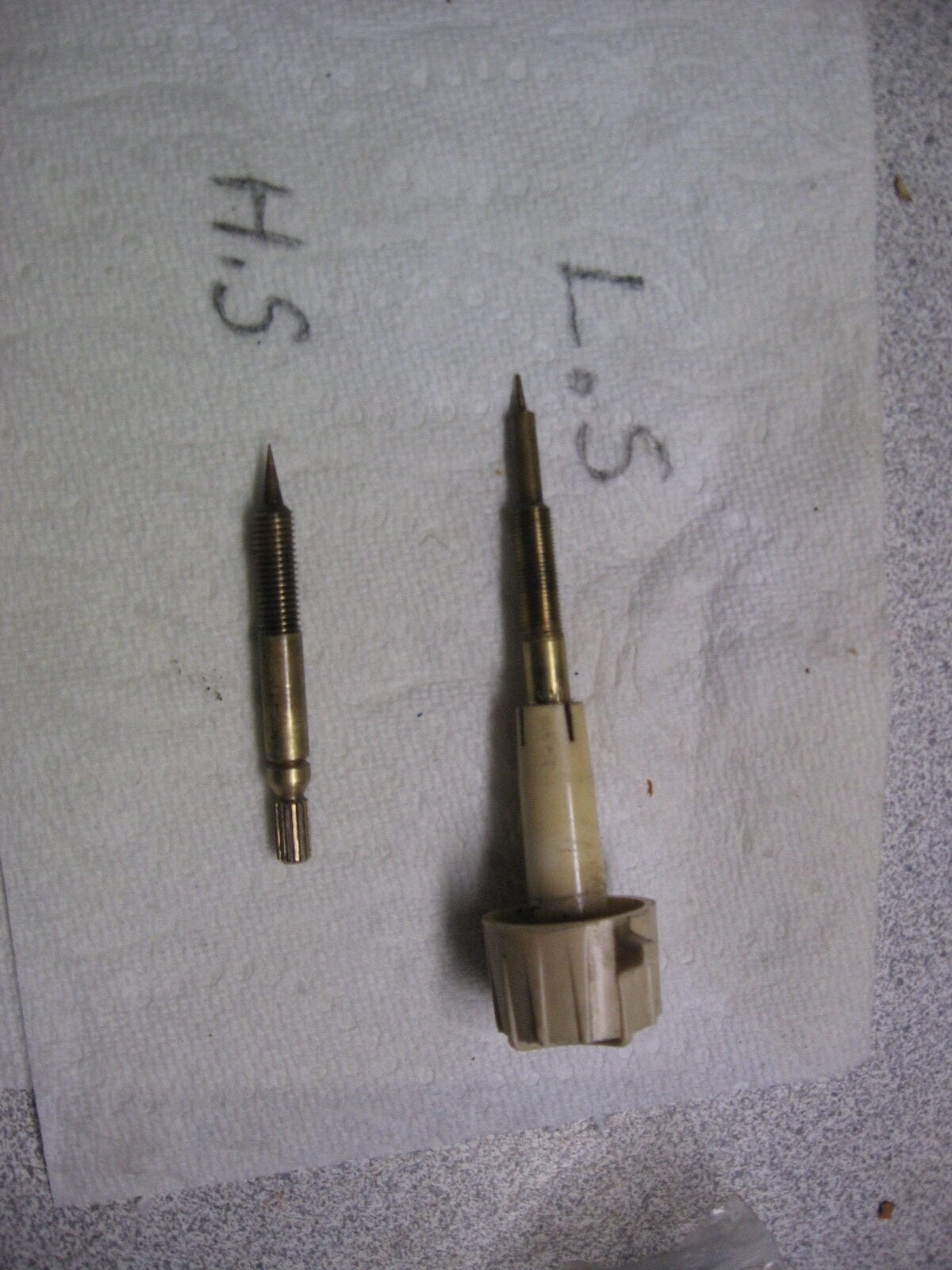

          bottom HS speed neeedle is pointy like a LS needle ??? usually they are much blunter (maybe someone installed the wrong needle & it is missing the front knob πŸ™ )

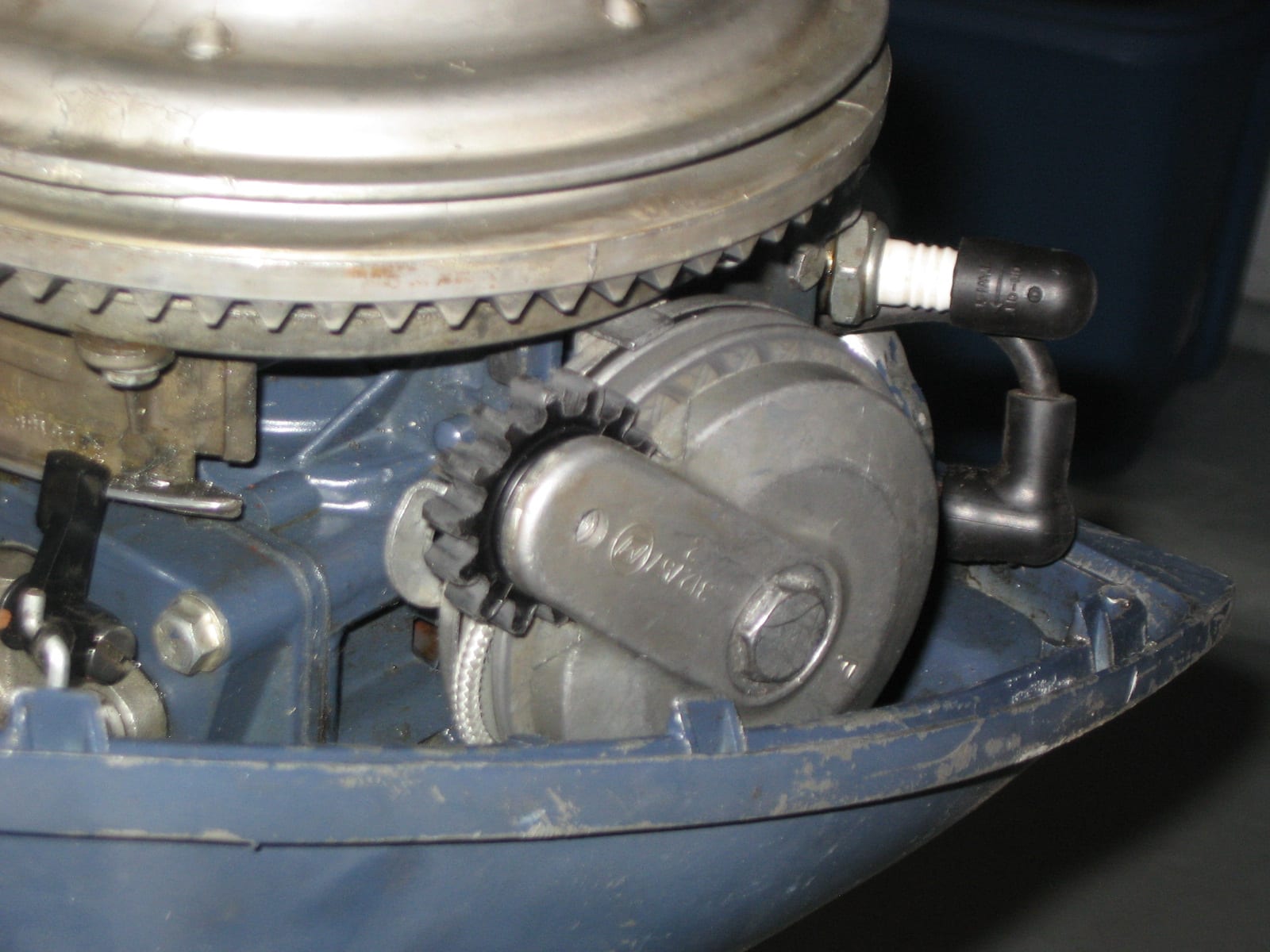

          it has the round recoil spring on the side of the PH like a 4hp

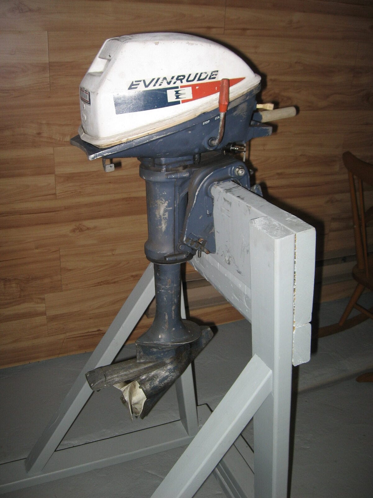

            Post a picture, the model number you gave doesn’t seem right..
            #229747
              see pics

                see needles btw serial# plate is chipped on a corner…. maybe it was tappered with

                  Well, isn’t this interesting as your motor is a ’71 four horse and it has the correct needles but the 2001 model number identifies it as a ’51 – ’52 25 horse. It looks like the tag has been pop riveted on to so this motor may have a shady past.
                  Take a look at the Welch plug on the block and see what numbers are stamped on it, if the plug is still there.

                    ho well it is mine now to play with before ice out πŸ™‚ glad to hear the needles are kosher HS one looked funny

                    hood logo is correct… and I scanned all of those 4hp years and did not spot the 71 logo identical to mine. good eye Mumbles

                      Yep, that is a 71 4hp Lightwin, and that ID plate sure looks like it has been pop riveted in place….
