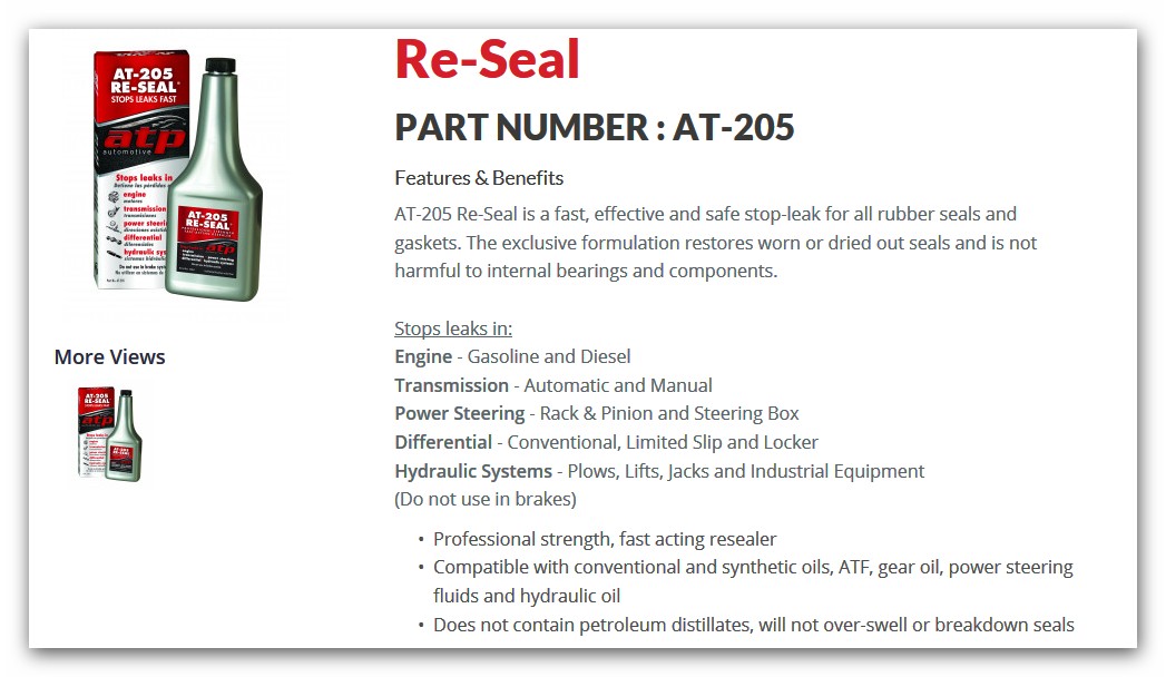

            Here is what I use for old rubber. I spray it on.
            Bob D
            https://www.youtube.com/watch?v=-wSVr4I5PLE

            amuller
              Interesting subject. My impression is that the "reseal" products–often sold for use in automatic transmissions–are solvents that are absorbed by rubber and cause swelling. They can cause a beneficial reduction in leakage (not usually permanent) but aren’t plasticizers and don’t do much to restore flexibility.
