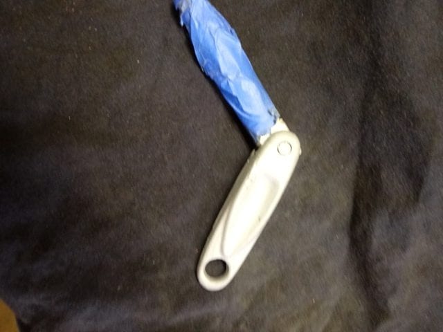

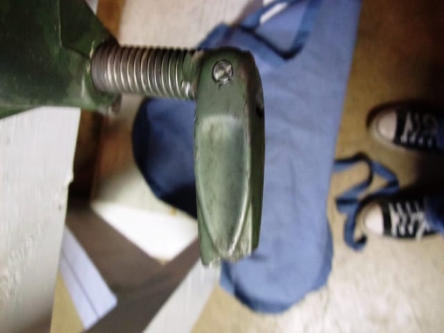

      I would like to drill out the pin and replace the broken handle with another handle
      The replacement handle that I have does not have swivel plate (pad)
      What kind of pin should I use?

        I use 3/16″ aluminum rod stock for a replacement pin, cut to length and peen the ends.
        1982 Evinrude 25hp
        #220843
          if not overly comesticly inclined …
          I just take JB epoxy putty and stick on the end of the handle pushing some inside the hollow handle when hardenned I just file and reshape the tip smooth
