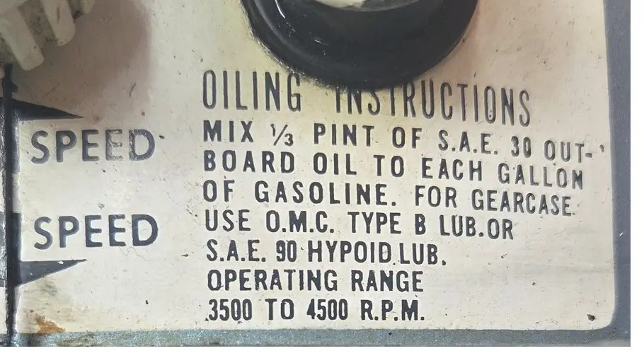

May 23, 2026 at 11:03 am #319703Most importantly, this motor should only be run on a 16:1 fuel mix due to its internal design. Any less oil mixed in with the gas is inviting trouble.
May 23, 2026 at 3:17 pm #319721Stephen, apart from a check over of the motor if you go to see it, I reccomend you ask the seller if they’ve ever ran it themselves and what is the fuel mix ratio for the motor. Then keep in mind Mumbles’ comment if they did run it themselves.
May 23, 2026 at 9:02 pm #319748
If that motor is in running condition, I feel he would find a lot of interest up to $175.00 from those looking for one. If it has been sitting for the last 50 years, it will need at least coils, carb kit, and impeller, which depending on the quality of parts, will be over $100.00. Because of the condition of the motor, I feel I wouldn’t have any problem getting $125.00, not running, at a club swap meet. It’s not hard to get more in these than they are worth. For most it’s a hobby, like golf. You may have to pay a little to play from time to time. The factory oil recommendation can be found under the choke knob. 1/3 of a pint would be 24 to one, not 16 to 1. I have 59 & a 61. I’ve had the 61 -19 years. I’ve had the 59 – 55 years. Because of the improvements in oil, I run 3 oz of oil per gallon (42 to 1) in them without any trouble. Video link below. Not a recommendation. My experience for you to use to decide how much oil you would be comfortable with. Video Link – https://youtu.be/r1vVMls8OU4?si=255PdIjuKDI9-_vj
May 24, 2026 at 12:58 am #319776Because of the improvements in oil, I run 3 oz of oil per gallon (42 to 1) in them
That’s with full synthetic oil though, right?
May 24, 2026 at 8:16 am #319809I just run my oldies at 1L/25L fuel 25/1 maybe a bit lean for some and rich for others but no problems so far.
