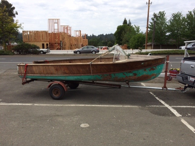

      I am starting a restoration on a 16 foot ’57 Wolverine Wagemaker runabout that I hope to run on Lake Tahoe.
      It calls for up to a 50 hp motor and must be a 4 stroke to use on Tahoe.
      Are there any favorite 35-50 hp vintage motors you can suggest for me to look for?
      I’ll need to know the motor before I install controls, cable, electrical, etc.
      Thanks again for sharing your knowledge, experience and advice.

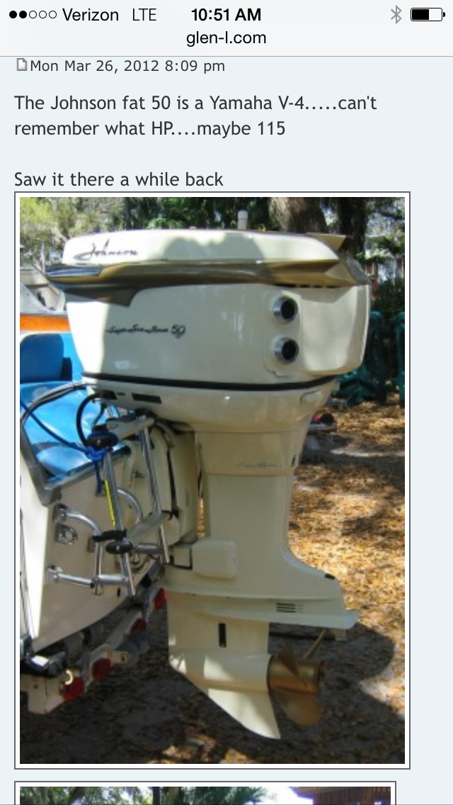

          I can’t suggest a motor,but I wonder if any of the forum wise men can come up with a way to put a vintage shroud on a modern 4 stroke motor?

                It is possible to put a classic shroud on a modern engine. I have seen several such conversions, and they can look very good. However, each combination of modern and classic has its own requirements for all the many dimensions, mountings, colors, connections etc. There is no "book" for doing it.
                Try putting out the inquiry to the group by asking for those who have done it to respond to you.

                  No Antique or Classic motor would meet the emission requirements for Lake Tahoe. HOWEVER The "Fat Fifty cover can be adapted to many of the compliant outboards. I have a picture of one, but I cannot currently post it here.

                      One of the Carolinas chapter members describes what he did:
                      I purchased on EBay a cowl with the "fat fifty" shape. I remember the price was $50 but the shipping was very high (weigh and size). The real trick is a V4 shape can completely cover a modern straight inline 3 cylinder engine.
                      The "conversion" was that I put it over the new engine (3 cylinder Yamaha) and it almost fit. A sawzall trimmed some metal away and darn it fit. The new engine still has its original cowl. The old cowl has enough weight so it will not bounce off. The old cowl had form sound deadening inside so there is no metal to metal contact. There was maybe 30% of open space on the sides between the two so air can get into the modern engine but you can not see the space unless you are looking up from ground level. I also painted part of outside cowl the same color as on the new motor’s bottom.
                      #37651
                      GARY
                        This pic is from the Glen-L forum
