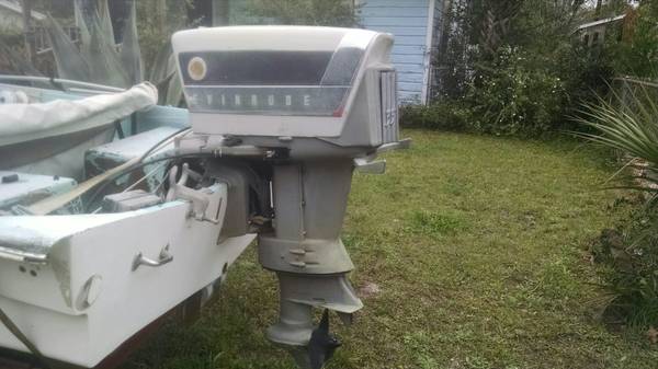

      Looks like it has a 35 on the back of the cover. Doesn’t match any of the marineengine.com parts catalogs that I can see. Was this a short-lived model?
      Wondering if I should go take a look at it tomorrow in the daylight.

        #33925
        retiredoz
          Well, the ’58 had a clamshell cowl, and the ’60 was a 40-hp. So that leaves ’59 ? the 355xx version, I believe..
          #33929
          oldelto
            Cover is 1958.
            #33931
            cron78

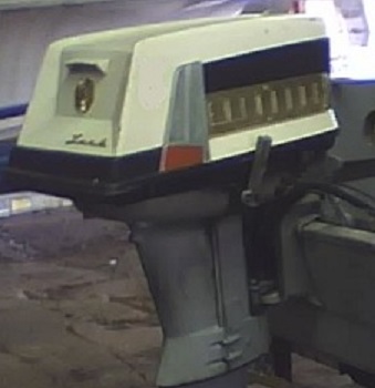

              Still looking for info. See lots of photos of this version of the ’59 35 Golden Jubilee, but not so many with the first type cover (photo above). Is the one above another version of the Golden Jubilee? Any other differences between the one posted here (that matches all the parts manuals that I have come across) and the one posted above with the different cover?

                r-c
                  It is a 1958 35 hp Lark. Model number should be 35514.
                  #33935
                  cron78
                    Thanks RC.
                    With the model #, now I can find more info and 1958 is good news. Now it makes sense why the cover is different from the ’59 Erude 35. Marineengine.com doesn’t have the 35514 in their catalogs.

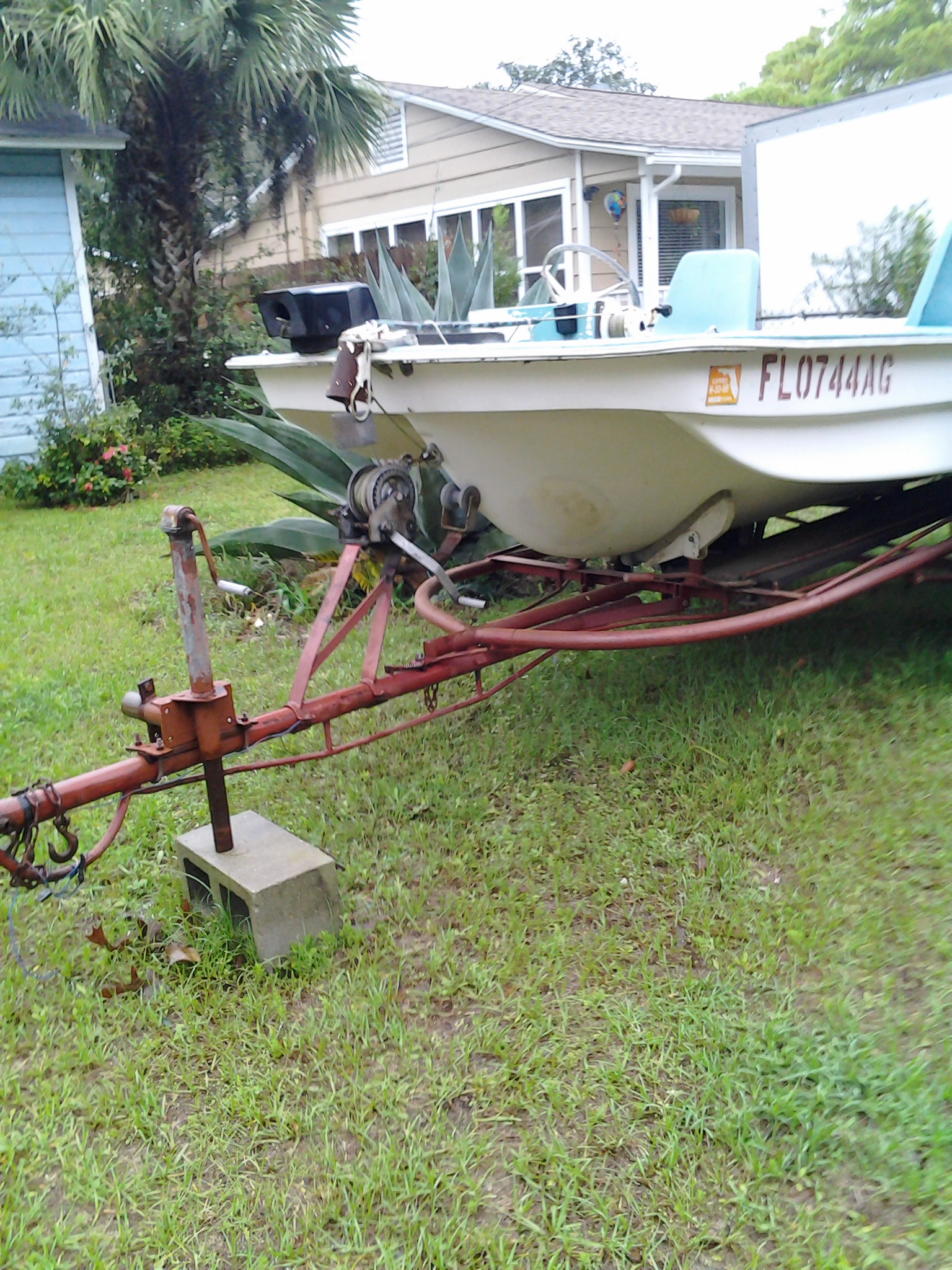

                        Okay, so I threw down $250 and picked up the combo. I figure that the complete exterior harness is worth almost that to me… making the boat, trailer and motor almost free. Junction box inside is clean, clean, clean compared to what I’m used to seeing.

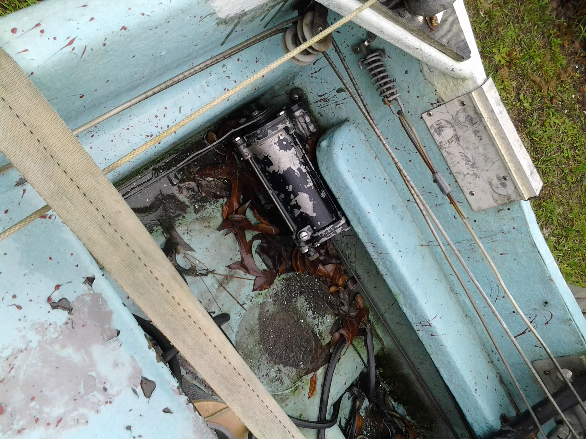

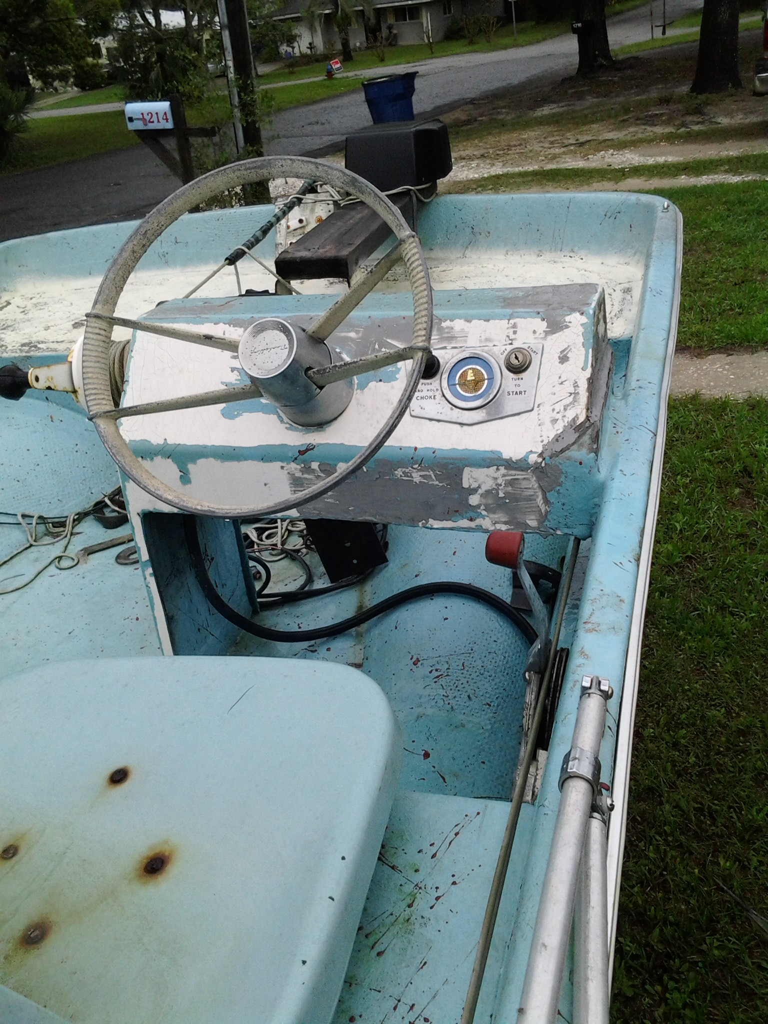

                        Initial question is on the controls. Single lever has a cable to a pulley on one side of what looks like a hydraulic cylinder. The cylinder then has two tubes to two cables for the F-N-R linkage and throttle. What’s this called. Is it worth keeping? it seems to work and may just need some adjusting.
                        Motor is likely locked up, didn’t get to spend enough time with it to know. It has rained here steady for three days. Inside the cylinders didn’t look bad, though. No oil in the foot, so maybe that is the issue. Will start to tinker when the sun returns to the Florida panhandle.
                        Don’t know the make of the trailer or boat, will have to work on that. Let me know if any of you have any suggestions.
