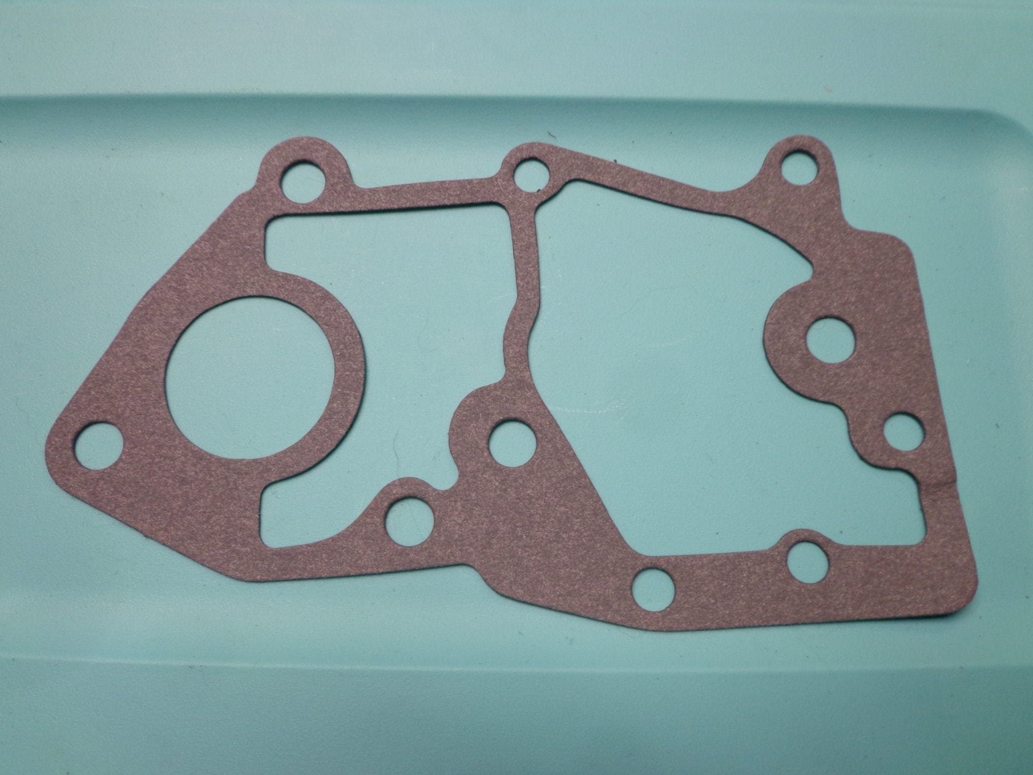

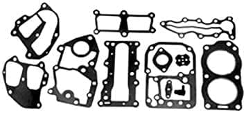

      It’s always included in the 18-4306 (394546) 9.9/15 horse powerhead gasket sets and doesn’t fit any 9.9 I’ve ever worked on. I believe the P/N is 18-0112 (324717) and wonder if it is meant for a commercial model?

        It looks like one for a 10 hp
        #166823
          Yeah, I have often wondered the same thing, have seen pictures of those kits with that gasket included. I honestly feel it is a mistake…..
          #166864
          bayham3261
            In the 90’s I recall seeing Johnson brochures for 15A and GT10 race motors. Could be related to those.
            A little information is a dangerous thing!
            #166866
            johnyrude200
              Looks like it’s for a commercial 14hp model.
              Those models use the older fastwin housing, but with the use of a intermediary adapter on top of the exhaust housing so the 9.9/15hp powerheads will adapt.
              If you did a search of that model on M.E., you might find that it goes to the commercial models.

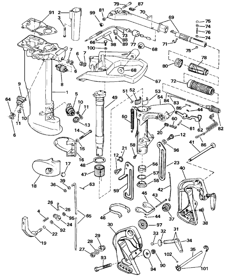

              #166915
              DAN ANDERSON
                We have a winner. JohnnyRude nailed it. I looked at 1989 14hp. Midsection area. Reference #91.
                http://www.marineengine.com/parts/evinrude-johnson-parts-diagrams/JOHNSON/46804.gif
                Dan in TN
