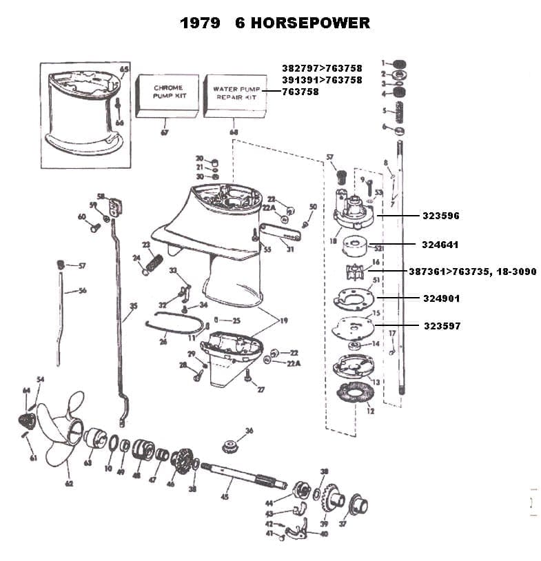

      Is there a “where used list” for OMC part numbers like there is for Mercury numbers? Someone put a later water pump housing on my 1959 Evinrude 5.5 hp and I have no idea as to what impeller is used with this housing
      #171553
        OMC did print such a list—sort of. But not like Mercs
        But the updated 5.5hp water pump kit actually is the 1979-up 6hp pump.

          Thanks for the info. That is what I needed.
