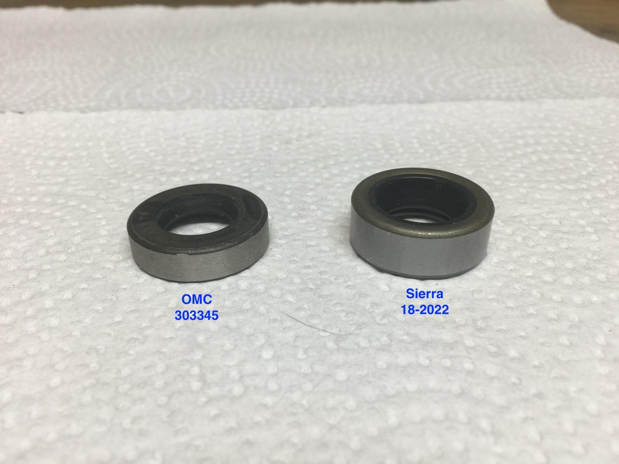

      So after discovering the cracked driveshaft seal plate on my Johnson QD-20, I found a good quality used replacement plate. I have 2 different oil seals for this plate, one being an OMC 303345 that was included in my water pump kit and the other a Sierra 18-2022 that came in the gearcase seal kit. Both seals have the same ID and OD but the OMC seal is 1/4″ depth and the Sierra seal is 3/8″ deep. The seal bore in the plate is 3/8″ deep so either seal will sit flush with the top edge of the bore. Does it make any real difference which one to use? I actually like the apparent quality of the OMC seal better. Any opinions on the quality issue?

        Use whichever one you like the best. The thinner one might give you some wiggle room depth-wise to possibly run against an unworn area on the shaft. Otherwise, makes no difference.

          the smaller one may give you some room to slide an extractor under the inner lip next time…. you change it 🙂

            I would use the OMC/OEM seal, I have never seen that deeper seal used in any of the upper seal/bushing assemblies.

                Thanks to all for the input – I’ll go with the OMC seal.
