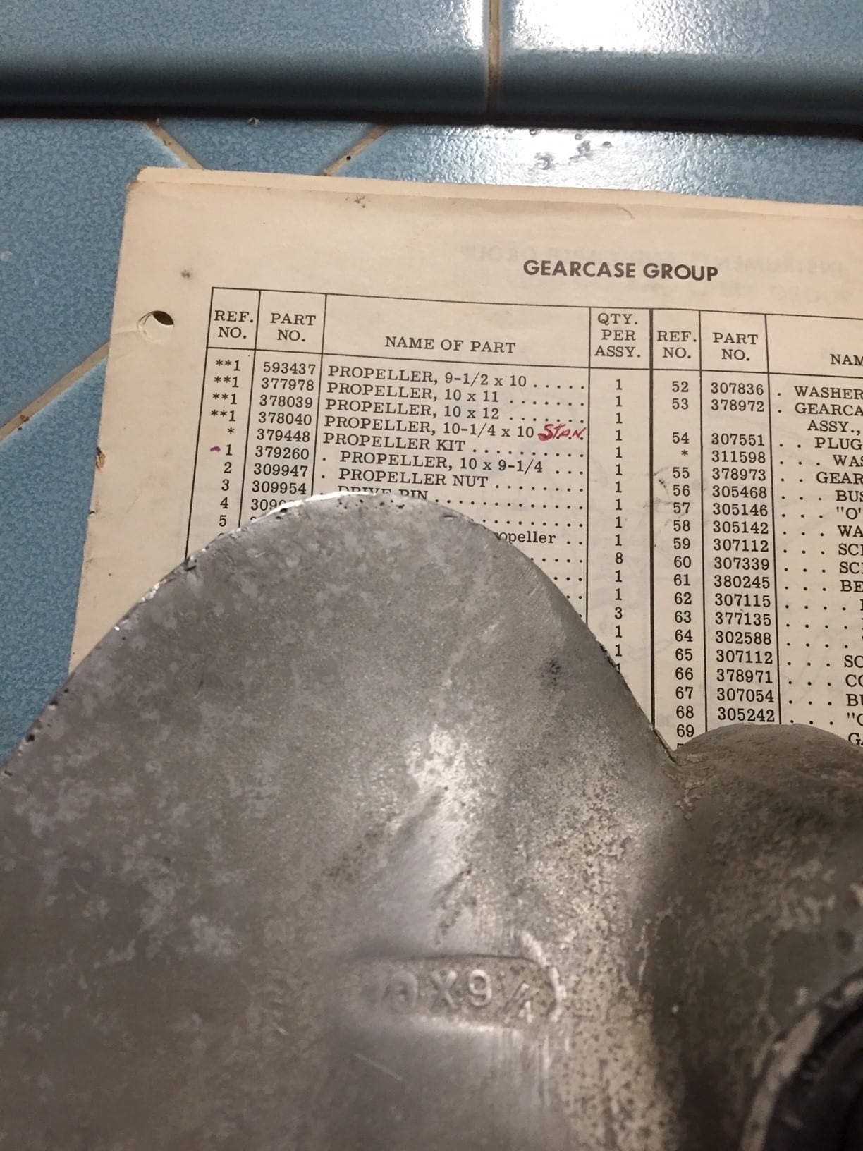

      The one I have is not listed as an option in my factory parts list, and the dang thing’s been slipping! One more mystery solved. Now that I look back I think it’s been misbehaving for a while, but pretty much let go today. it’s a 10X9 1/4.
      Parts list says I can choose from 10 1/4 x 10, (which someone has penned in, “stan” by; for standard, I assume), 10×12, 10X11, and 9 1/2x 10. I’ve found the pretty 10X12 I got is too big. Dag nab it. Which of the listed ones would be best for my hull? I’m not skiing, and am looking for highest top speed, I guess. Fuel efficiency, maybe.

          I would go with the “standard” prop: 378040/10.25X10″. That 9″ pitch prop in your picture looks pretty beat up, not worth rehubbing….I am assuming the 12″ pitch prop causes the engine to lug, that is a big boat, so the 10″ pitch prop will allow the engine to wind up/breath and provide good performance in most all loads…

              10 x 9-1/4 is listed on the parts list you posted as a propeller kit.
              #178760
                Does your current prop look like it is wrong for the motor? In other words, is the hub smaller than the gearcase? I believe that is the propeller kit. It was a very good prop for most cases. The other props look more like a proper fit with a flow from the gearcase, over the larger prop hub. Nevertheless, the small hub prop with the funky look works well on most boats.

                    Wow, and yes. The prop is exactly as Frank R described. It does look small compared to the gearcase. “Wow” in that I hadn’t spotted it on my parts list. What makes it a, “kit”?
                    I always keep every part that’s even close to useable, (and some that aren’t very close). I carry the bigger prop as a spare, and will hang onto the one pictured. It’s not as ugly as the closeup pic implies.

                        It is a “kit” because it comes with a smaller / shorter prop nut, drive pin, and cotter pin. That because the stock parts are way bigger in order to conform to the larger stock prop hub’s diameters. I agree that the small hub prop looks for all the world like it would cavitate like crazy, but it doesn’t.
