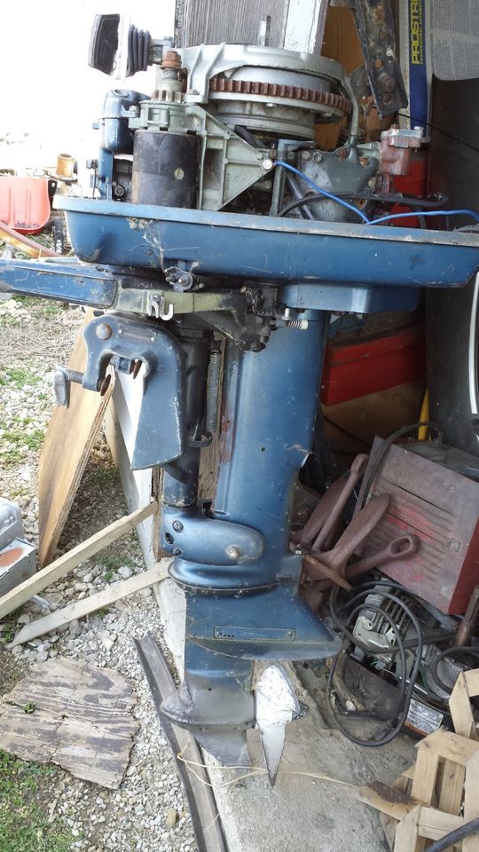

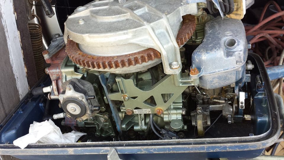

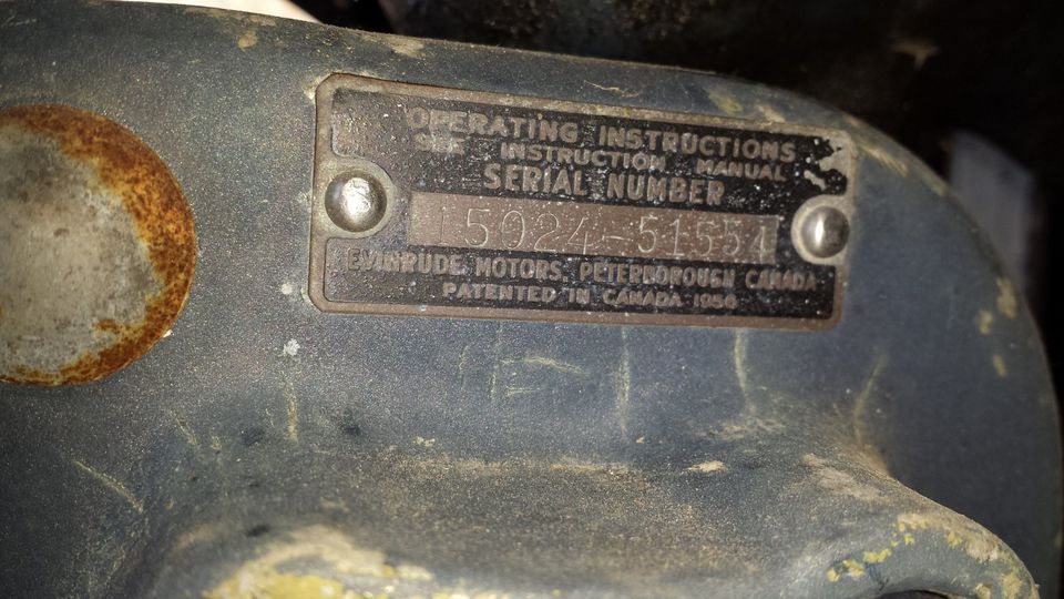

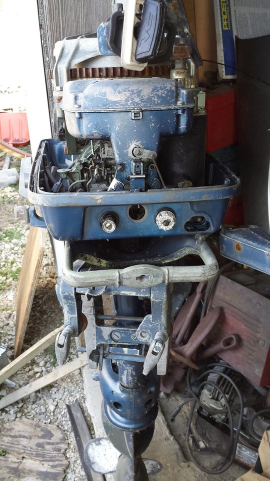

      Found a sale for this Evinrude for parts but I could not tell the year. The name tag says 15024. By google up this number, it says 1958 18HP but it looks like 1959 model when OMC changed the cowling.

        1958 name tag. Put together from various parts

          As stated, definitely a ’58 model number on the tag but the transom clamp could have been switched out over the years. Or a 59ish lower pan and hood were added when the ’67 or later Johnson powerhead was installed.
          Nice electric start system. Do you have the correct boat side harness and key switch for it?
