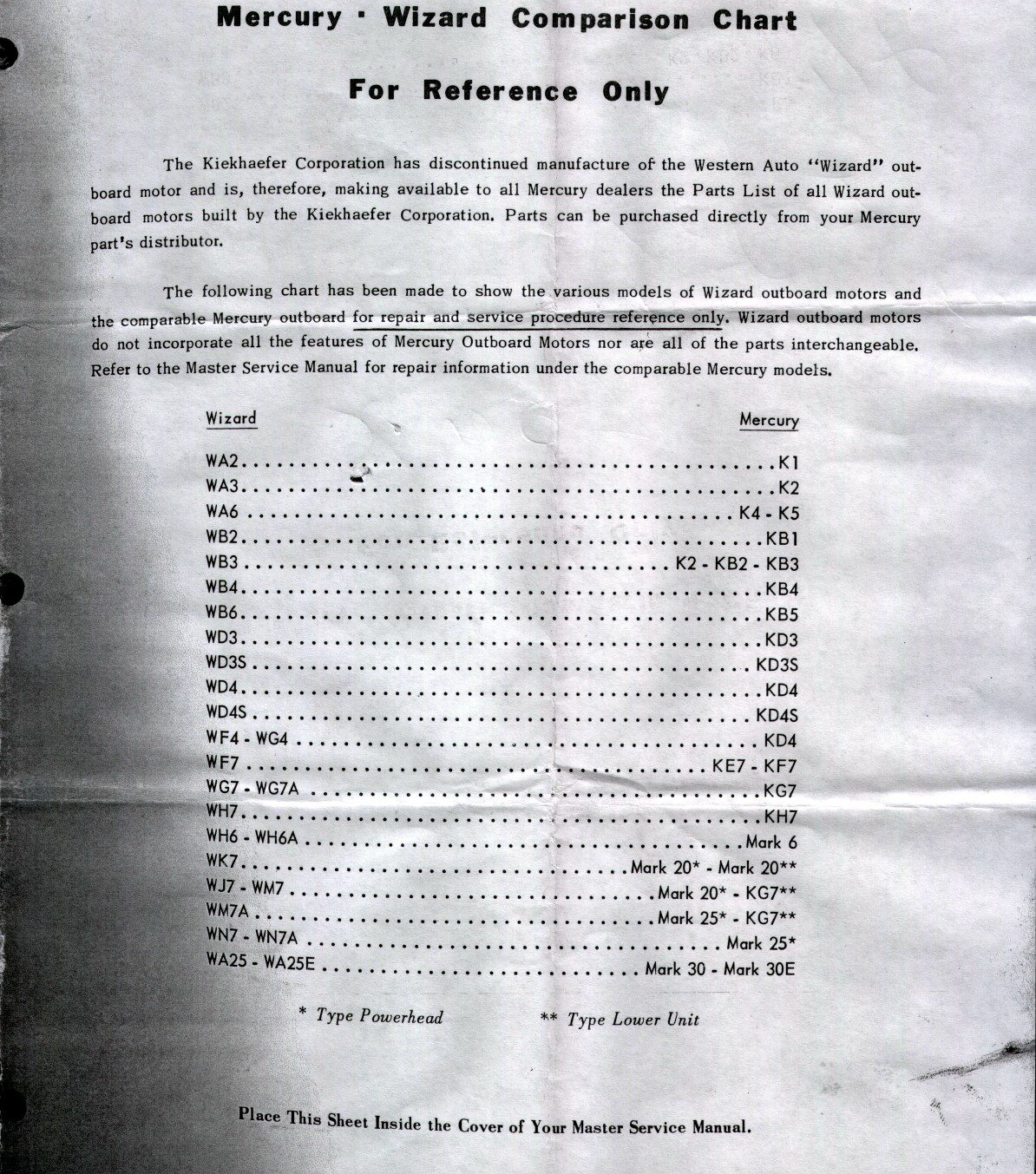

            Is the Wh-7 equivalent to the Mercury KH-7?
            I have attached a PDF parts listing for the KH-7
            Mercury-KH-7-and-Mark-15-and-Mark-20-Parts-Manual.compressed
            Merc-Wiz_Chart_50-1
