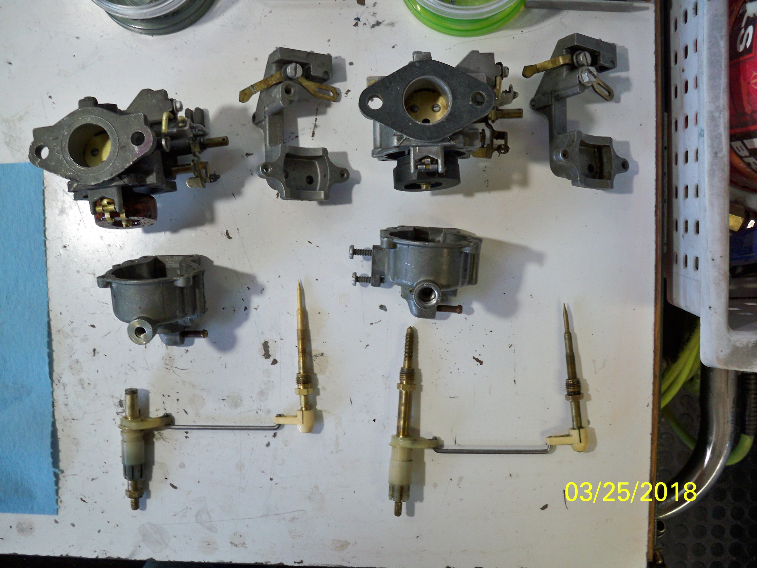

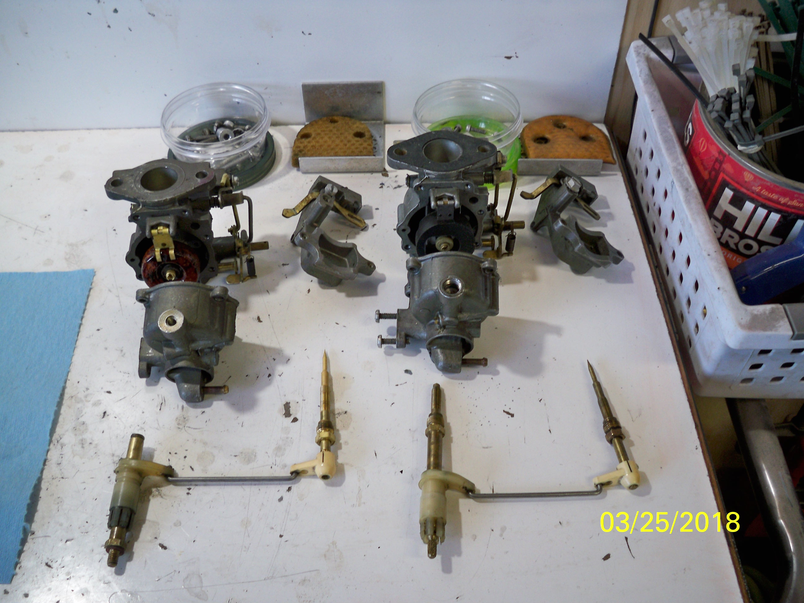

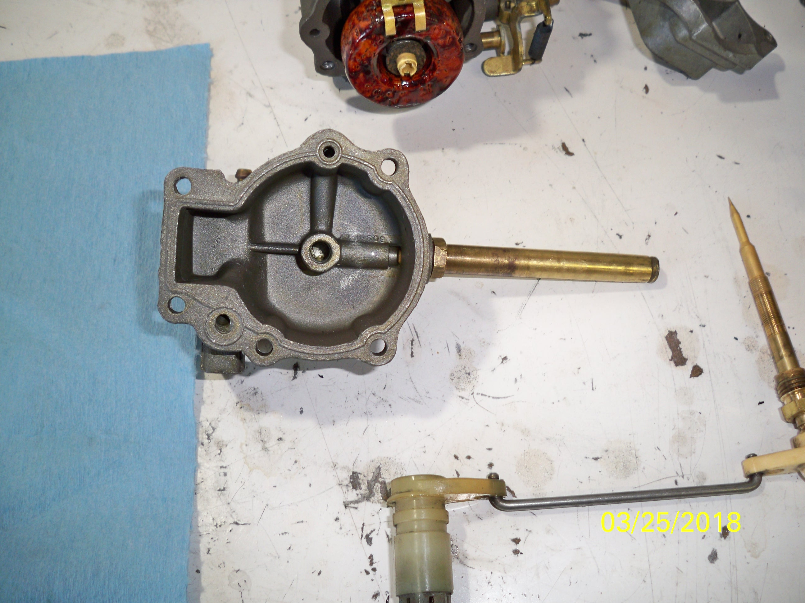

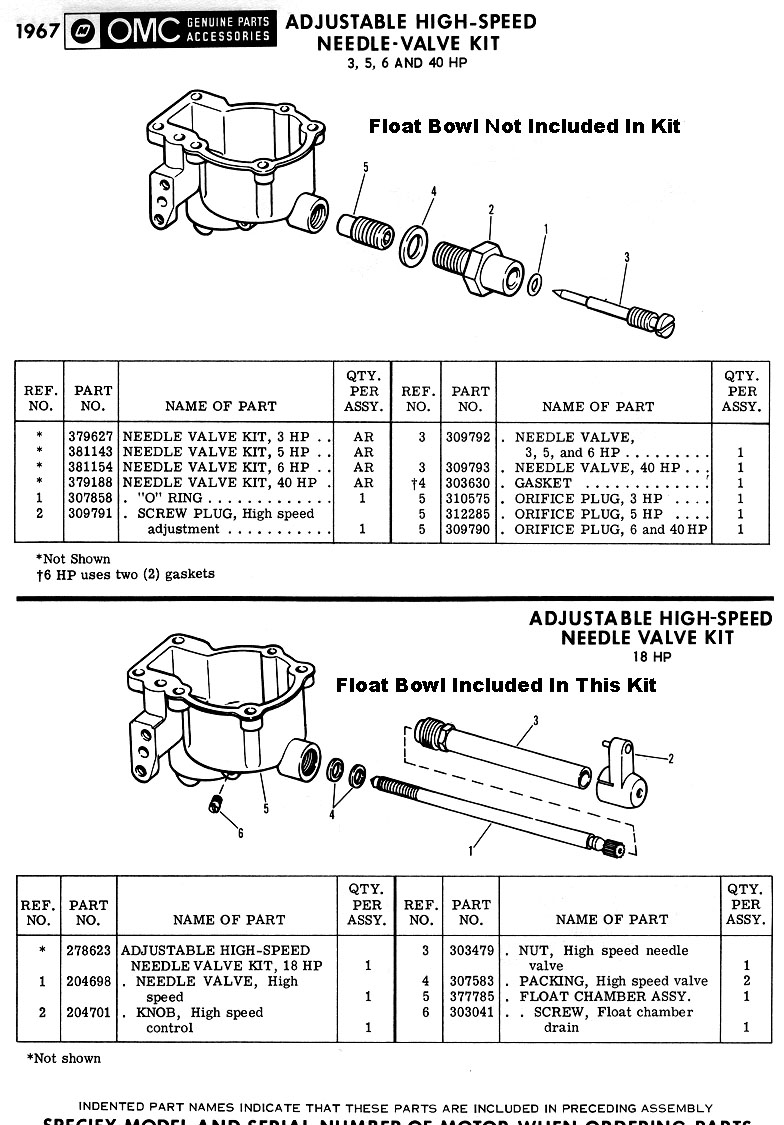

I am restoring two FD’s. a -16 (’62) and a -19 (’65). After disassembly of the carbs, I am presented with a difference that puzzles me. the carb on the right is from the 16, and the one on the left from the 19. (I see my pictures are out of order as usual) My Johnson repair manual shows a picture telling me the one on the right has the correct high speed needle assy. I have no idea what the heck is going on with the one on the left. It would appear to me that this carb does not have a high speed adjustment.

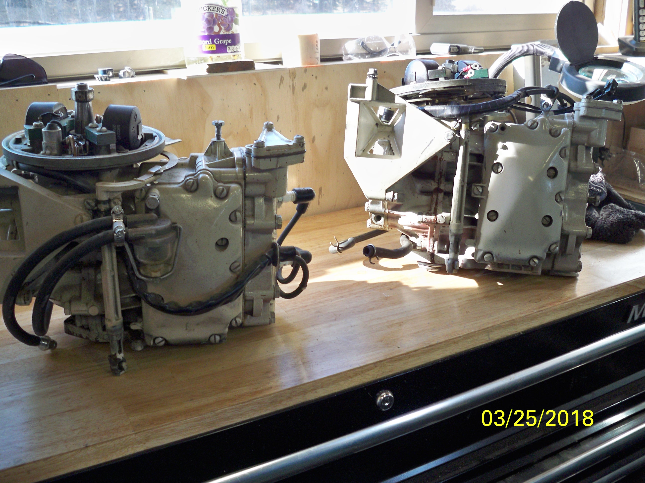

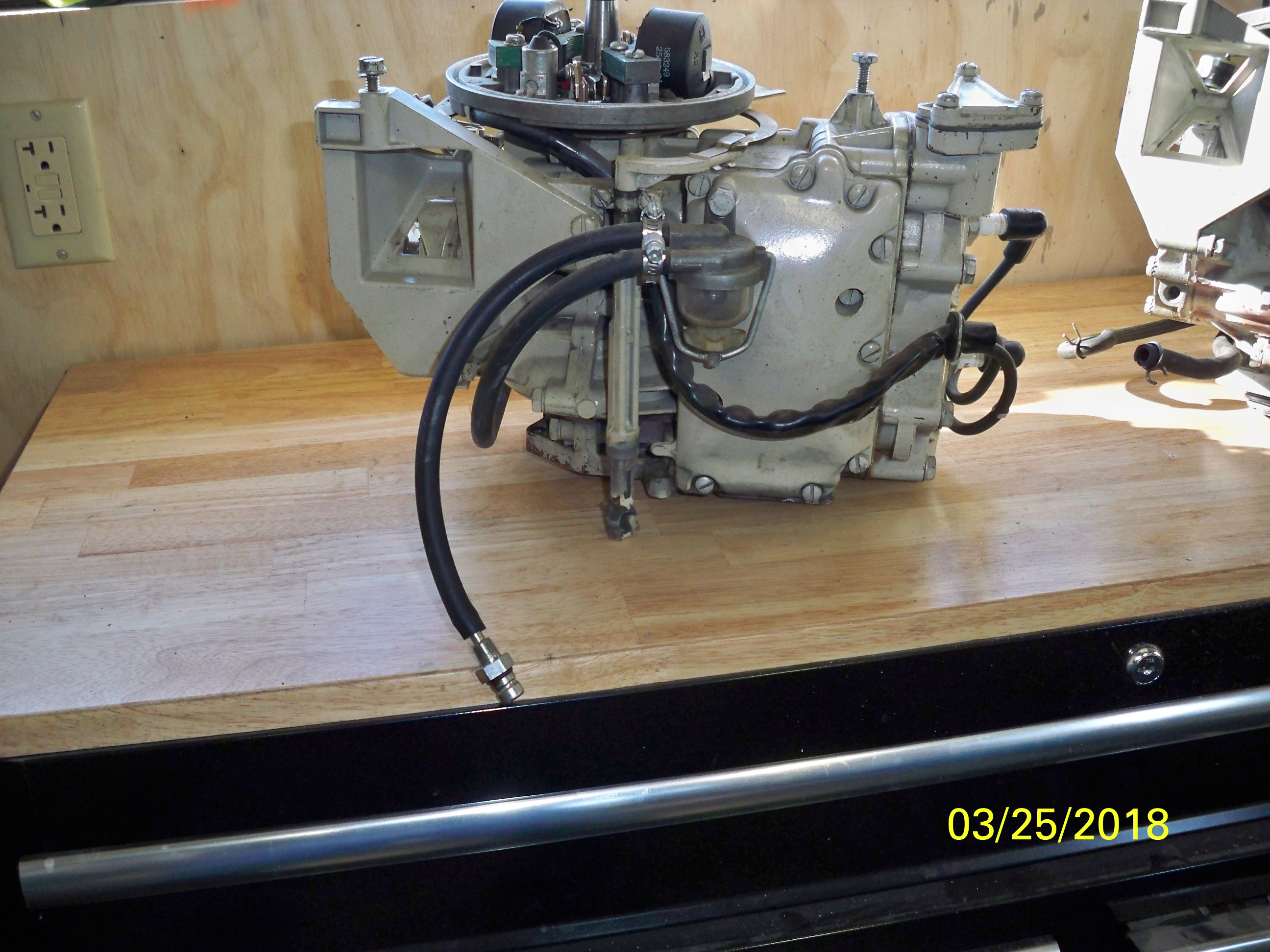

One other difference of significance between the two fuel systems is that the 16 has a sediment bowl and the 19 does not. Puzzle #2 of this post. Again, no picture of a sediment bowl on the (typical…FD-10) illustration or parts explosions that I can see.
Should I remove the sediment bowl and hoses from the ’16?
Shoulld I get a new carb bottom piece and a high speed needle that looks like a high speed needle?

920-764-0501March 25, 2018 at 6:58 pm #73023why mess with the design ?? differences are usually for performance improvements and/or… cost reduction
I doubt anything … looks like a high speed needle…if not a needle it is a fixed jet orifice
March 25, 2018 at 7:28 pm #73025The carb on the left (newer one) has a fixed high speed jet. They are not adjustable per se, unless you change them out. They require a special tool to remove. If you look in deep inside the hole you will see it in there. Not using the tool can lead to damage of the jet. I always remove them during cleaning.
March 25, 2018 at 8:18 pm #73028The fuel pumps contain filter screens. I guess at some point they decided the sediment bowl was overkill and not necessary.
