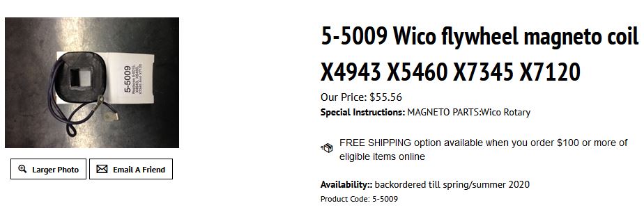

      I have a Scott Atwater 16HP engine that has WICO X7345 coils installed. They are going bad and they seem pretty elusive.
      I do have a couple of WICO X5460 coils and they are the same laminate diameter (5/8″).
      Anyone know what the difference is between these two coils? Can they be swapped?
      I see that a website (www.mcdonaldcarb.com) advertises a replacement coil that supposedly works for a variety of OEM WICO coils…..but there must be some difference between them all?
      Thanks
      WICO-Coil-Website

            Frank; I do not have any aftermarket coils; although the ad above appears to be aftermarket versions.

            #250757
            WAYNE
              The note on the website that says “back ordered until spring/summer of 2020 is not encouraging.
              Wayne
