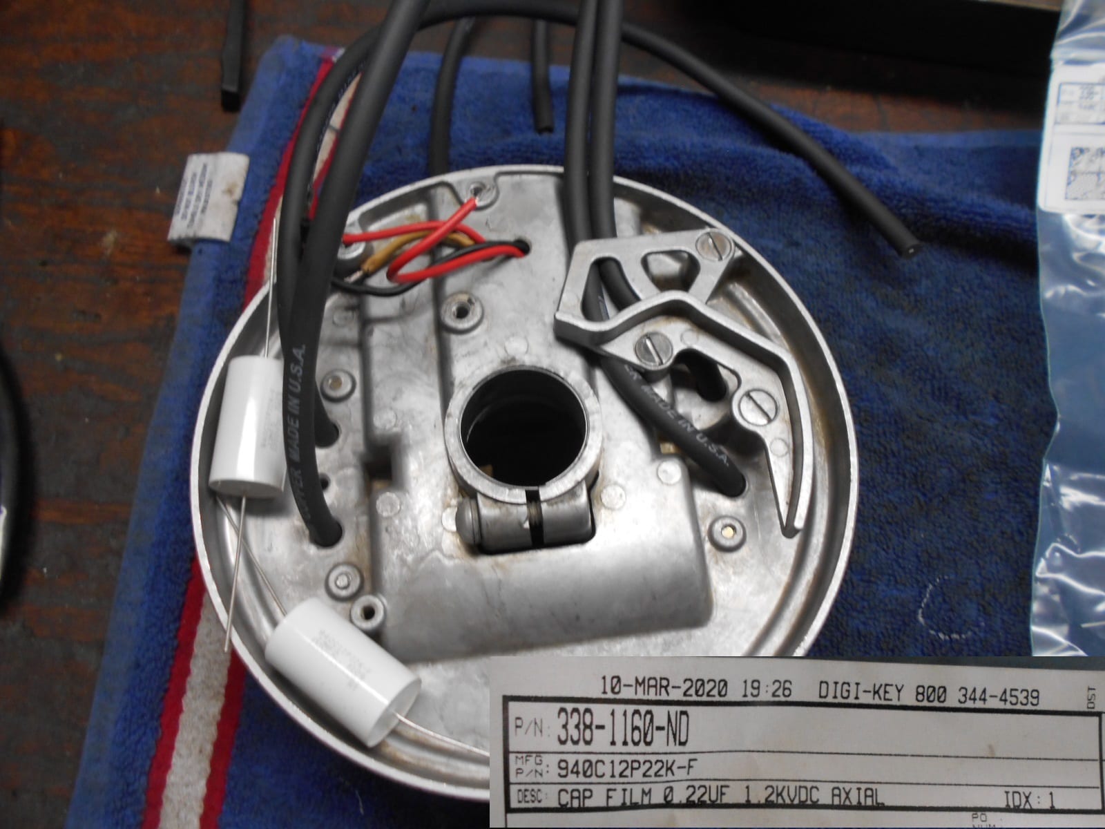

      I bought these .22 mfd caps a couple of years ago, evidently
      by mistake, as they’re huge. Probably about 3/4″ in diameter.
      They have a DC voltage rating of 1.2k volts. Considerable higher
      than the 800 volt ratings I’ve been using, but out of, and on order.
      Is there any reason other than mounting or clearance issues
      why these big caps would not work? I’d like to find a use
      for them, and “thimk” I can make them fit on this Zephyr mag.
      Thanks.

      #243284
      rudderless
        I am using the rectangle equivalent from digi-key on my 9.9/15. They work fine with 50 hours on them so far. I mounted then outside the motor on a mounting plate. Ya probably can probably find room for them inside somewhere but might need to fab hold down bracket.
        #243289
        David Stanton
          They should work fine. The higher the max voltage rating, the better!
          #243292
            mount in the old cap container.
            #243295
              any limits on their heat range ?? otherwise no reason they would not work if they test good and can be fitted .
              I built myself a test box ( W.Mohat Outboarder article) for caps and found ” good looking caps” to test bad 🙁 even at around DC spikes of 275 V .

                #243298
                  The caps are about 3/4″ diameter, hence won’t fit in the old
                  condenser cans.
                  #243299
                    The original condensers mounted on the bottom of the Zephyr’s mag plate,
                    and I have room to do the same with these big caps….. I hope!
                    #243300
                      Not sure if “heat range” is in the specs. Would that be from ambient air,
                      or heat build-up from electrical load? If the old condensers took
                      the heat, these caps should too?
                      #243301
                        I’ll try wiring them in. Nothing ventured, nothing gained.
                        And if they don’t work, my cap order was just delivered
                        a couple of hours ago, so I should have smaller
                        ones that I can put in the old condenser cans if I want.
