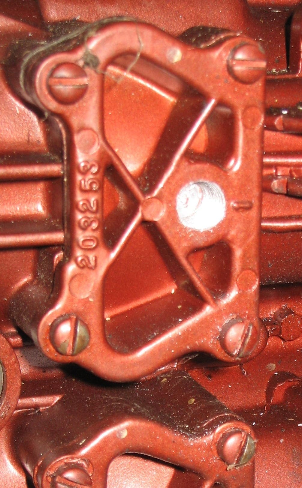

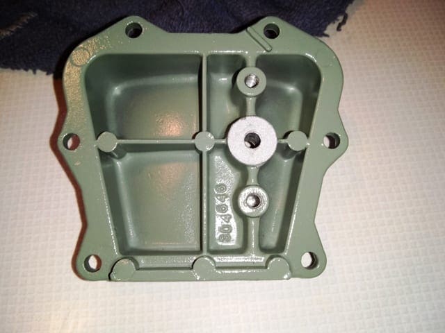

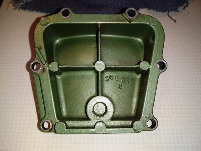

I am converting a 1955 Johnson 25 hp RDE-17 to a single line fuel system.
Will this pump work????????
I will be mounting it on the by pass cover that has the proper embossments.
As far as I know – The pump is for 9.9-15hp

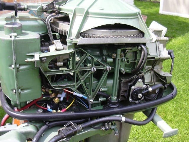

October 4, 2019 at 2:48 pm #184627The fuel demand for a 25 horse might be borderline for what the small square pump can supply as these pumps originally came on the 9.9/15 horse and smaller motors. I know they have been used successfully on the later 18-20 horse motors though. After taking everything into consideration, the price of a used pump, condition unknown, shipping costs, and a rebuild kit, why not consider a pump designed for larger motors?

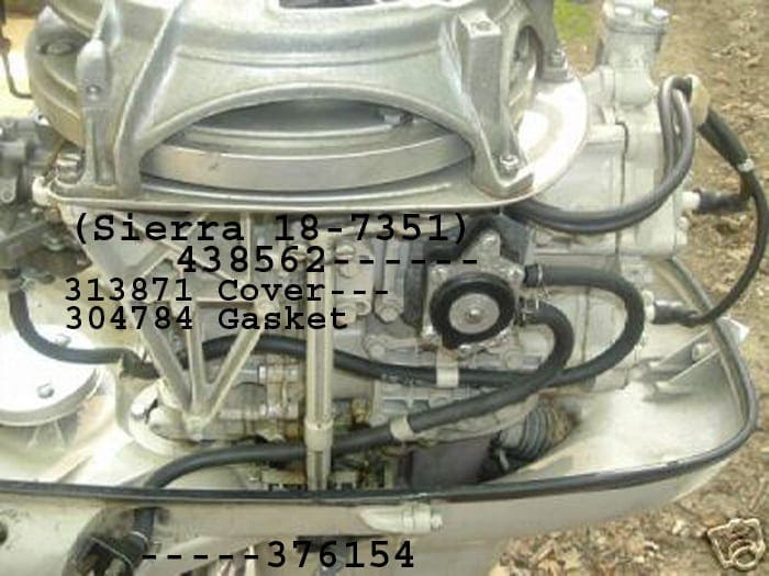

October 4, 2019 at 4:15 pm #184636Here is my favorite OEM pump. Works well, is very simple, and is easy to rebuild. Originally used on up to 40hp

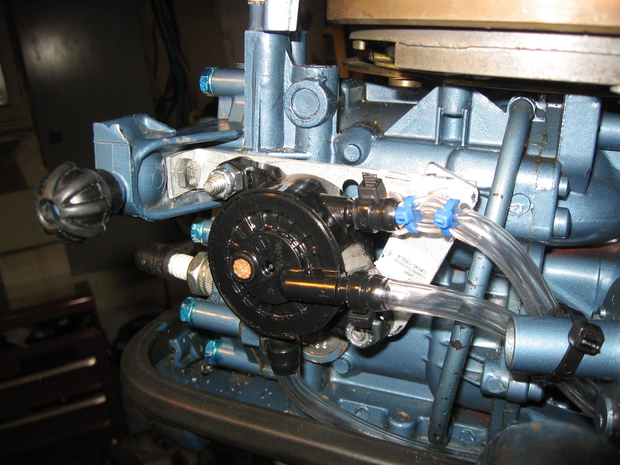

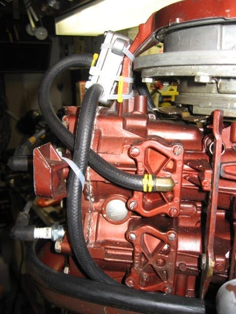

October 4, 2019 at 6:42 pm #184648What I was trying to do is find a pump that is smaller than what I used before.
It was little tuff to get the hood on.
I like Franks pump because it looks smaller but the barb does not rotate.
As for the Briggs – I don’t want to mount it with tie wraps.
I guess I will do it like I did before.
But I do appreciate all the input as always.

Frank in you last picture- Isn’t that pump a 380016 (no moveable barb) not 438562? -
