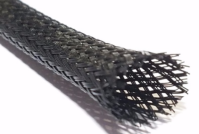

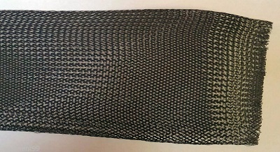

                    I found this stuff where I used to work, they used it to run their wires thru it for their Plasma transfer arc welders… I have a chunk at home, I will look to see if it has any identifiers tonight, it is very robust and I believe is cut resistant. This covering is meant to protect wires while being walked over so should do well within our scope of need…
                    #55016
                    John
                      My plan is to use the nylon braid wire sleeve and heat-shrink the ends.
                      heat-shrink is not very flexible once it is heated and shrunk.
                      the nylon braided sleeve will always be flexible and look good.
                      also, moisture can not accumulate inside the harness.
                      http://www.ebay.com/itm/151520817057?_t … EBIDX%3AIT
