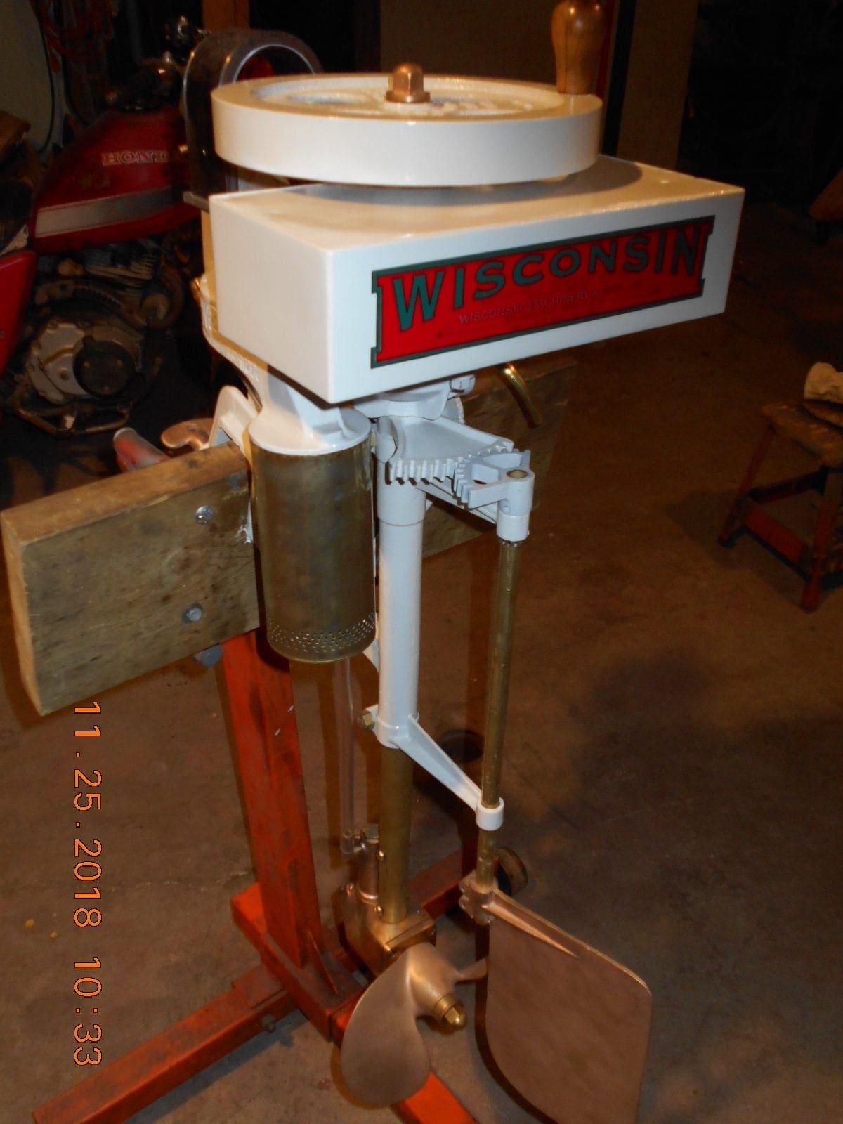

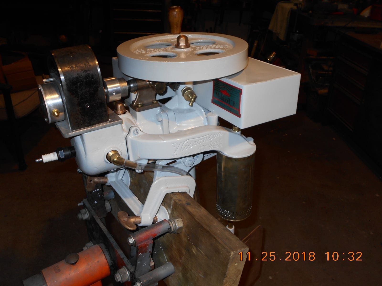

      Finally got the decals on the tank, and tank installed yesterday.
      I have to finish up details on my homemade timer, mainly
      trying to drill a couple of holes thru the horseshoe magnet
      to mount it in place, and paint. The metal is incredibly “hard”.
      Used an end mill in the drill press and was only able to penetrate the
      surface about 1/32″. Will probably have to get the torch out,
      get the magnet red hot and drill.

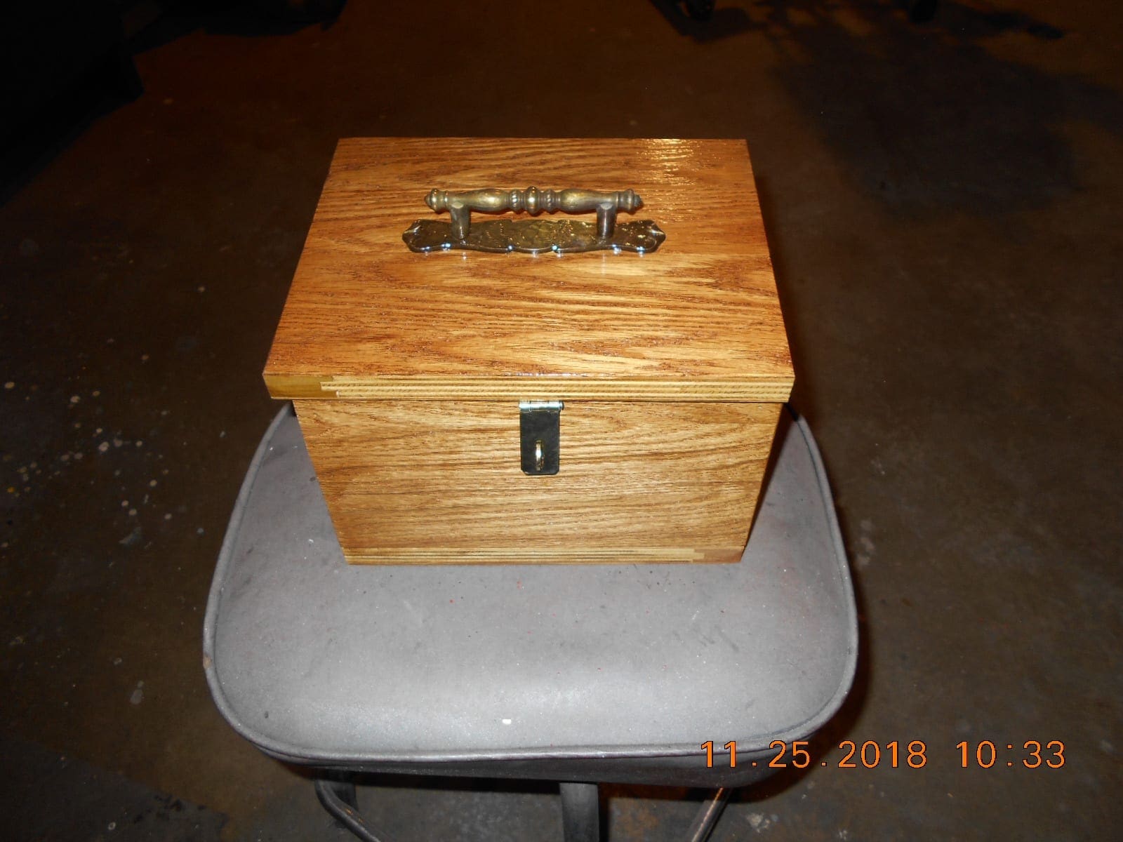

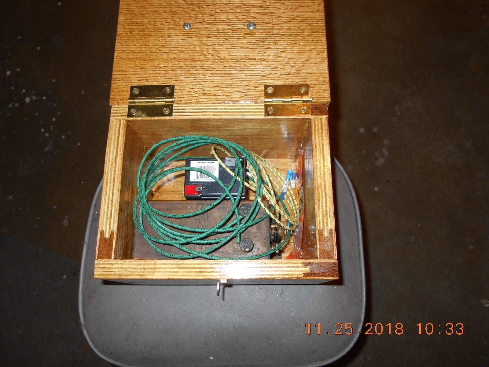

      In the mean time, I built a battery box, but am yet undecided
      on how to “exit” wires from the box going to the motor.
      I want to have post going thru the box to hook up my wires
      externally, to be able to remove them, and store them in the
      box when not used. I didn’t really see anything ready-made
      on the Internet, and yet “antiquey” looking, so guess I’ll just
      make a couple of post to hook the wires up to out of brass
      bolts and insulators of some kind.
      Any better ideas, or photos of what you may have done?
      Thanks!

          #155606
          JOSEPH BRINCAT
            so why are you attempting to drill a hole in the (magneto) magnet? The old iron magnets are glass hard, not drilable with normal tools. If you heat the magnet it will no longer be a magnet.
            Joe B
            #155619
              The magnet is just there for looks, so it looks more like a magneto
              instead of a homemade timer. I believe it was off an F-12 Farmall
              tractor, which I no longer have. The magnet is just sitting there
              loose, so looking for a way to mount it. I built the timer out
              of aluminum, so the magnet ain’t staying there by itself, lol.
              Thanks for the encouraging comments.
              Joe B
