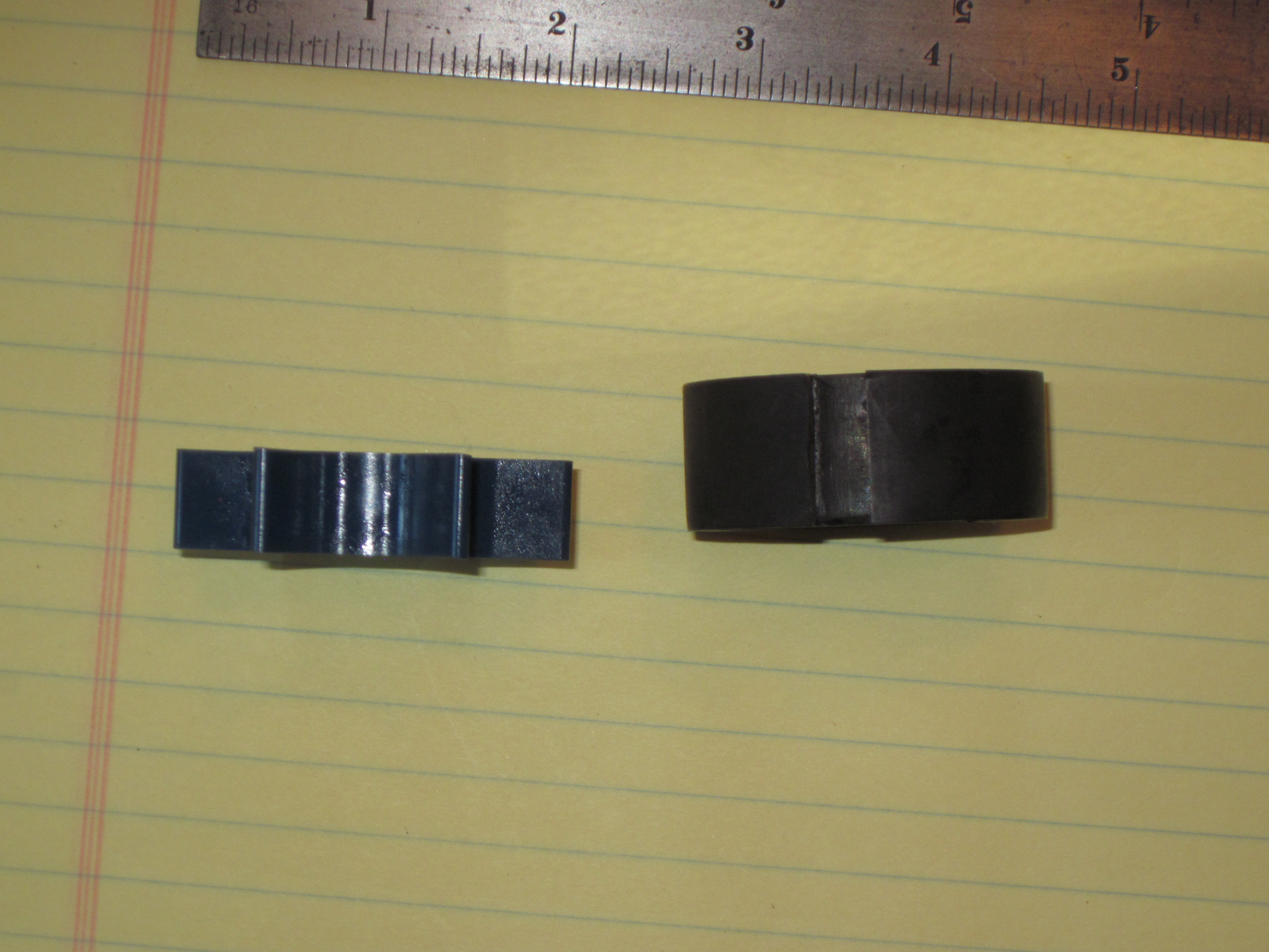

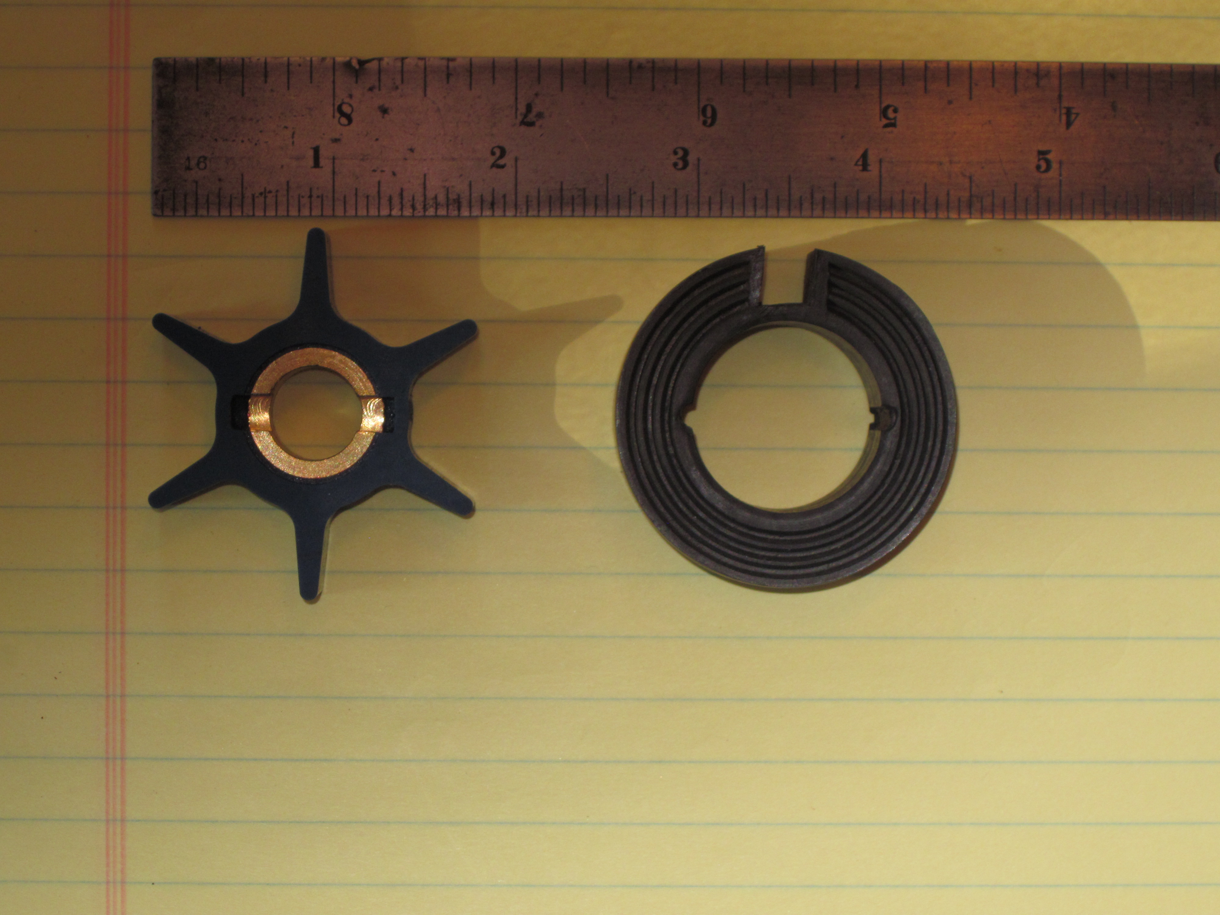

          Early K Model Mercurys and Wizards made by Kiekhaefer Corp. (Mercury) with the "3 slit" water
          pump casting use the same impeller Mercury Part # 47 -24447
          Several vendors offer the impeller
          Several impellers can be altered to be usable.
          The impeller is driven by a drive hub which has "arms" which fit into notches in end of
          impeller. If you have access to a milling machine the notches could be milled out in a
          moment or two. Using a motor tool (Dremel) or drill press might not be as neat or quick
          but, would work. Less finicky types might just epoxy impeller to shaft. skip the drive hub
          and use only the pin. The OMC impeller (and probably other as well) have a plastic core
          while the original Mercuy impeller core is brass.
          Member Brian Wilcox makes impellers on a core exchange basis which is anther option.
          Whichever option you use, it is a good idea to remove water jackets to see if a stray vane
          or 2 has wandered upstream where it may block exit at some inconvenient moment.
          Sometimes you can do this without damage to gaskets. If not, gaskets are easy to make.
          and gasket stock inexpensive.
          Impellers for antique outboards are more costly , because of low volume production and demand. Altering a relatively inexpensive impeller MAY work well enough and long enough
          to be worth the effort. Removing and replacing an impeller on this type water pump is
          not difficult. Do remember to apply water proof grease to prop shaft when servicing lower
          unit. Prop shaft seal in water pump is a bear to remove
          Louis
          Vane type impeller is used on "3 slot" water pump.(Mercury Part # 47-24447)
          Early "16 square hole" and "7 slot" use an oscillator (Mercury Part # 47- 24427)
          lby
