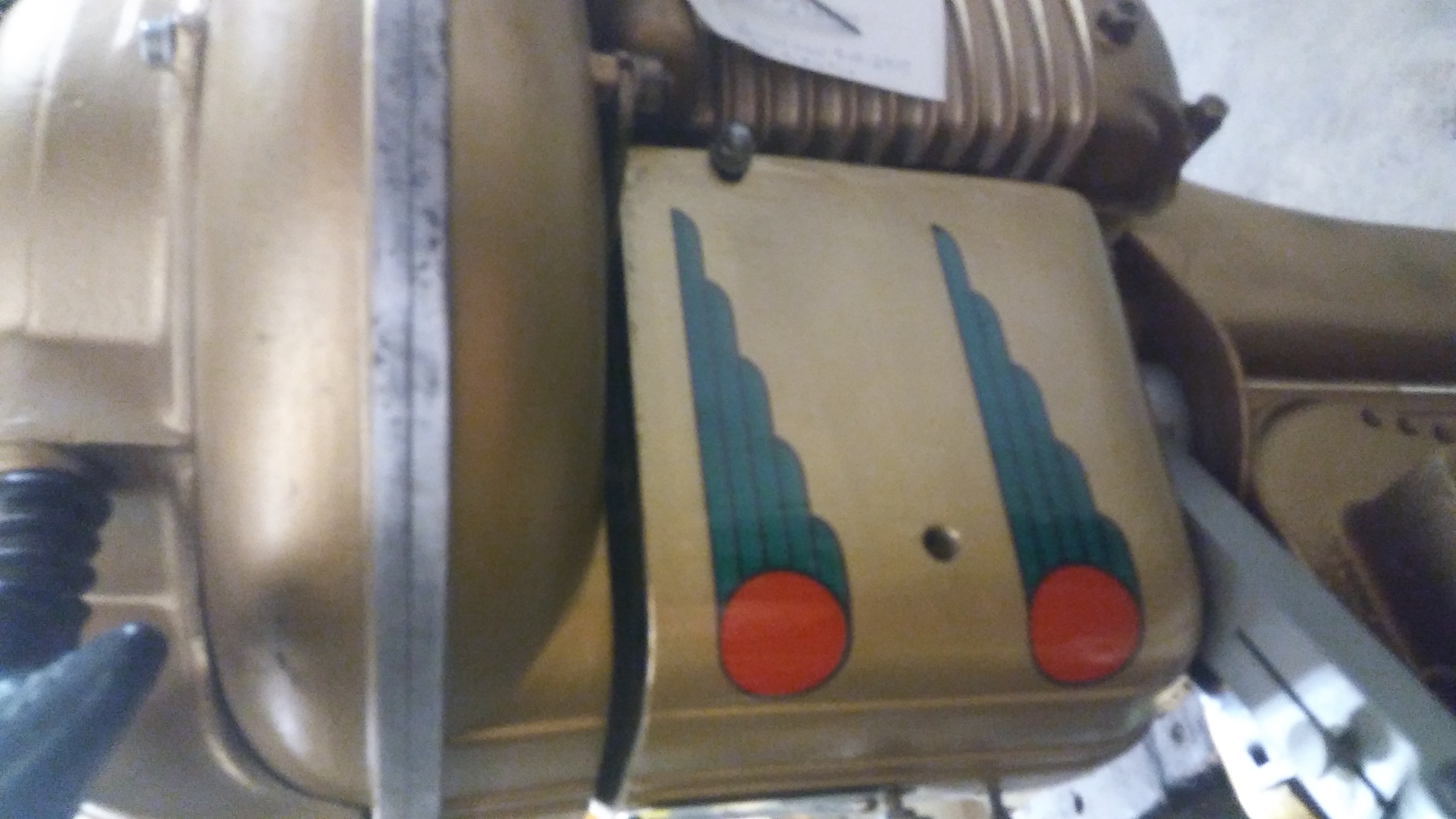

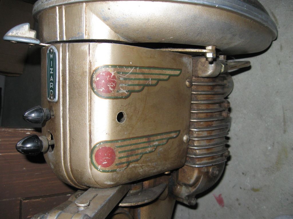

I bought the decals several years ago for this Wizard WD4S outboard. On the front shroud there is an option to use either type winged decals. This is a 1947 model with recoil starter. Would the decal with the circle in front of the wing be the correct one? The shroud was missing on this motor when I bought it. On the Mercurys, the winged decal with just the lines are the ones I usually see.
April 16, 2017 at 4:44 pm #56189April 16, 2017 at 5:17 pm #56192Amazing how different they look, I have often wondered if there were actual changes throughout the model year that were basically ignored, or the person trying to duplicate just did not notice the difference…
The red circles in the above shown pictures, in my mind, are glaringly incorrect…Maybe I am just anal like that
classicomctools@gmail.comApril 16, 2017 at 7:16 pm #56208I was told a while back that one went to the motor with the recoil and the other for the motor with the rope shieve. Of course I am one of those people that don’t remember stuff. Those covers often get discarded and the new owners use what they can find.
April 16, 2017 at 7:20 pm #56210Now if I can only locate that plate on the front of the cowling that has the word Wizard on it.

Went out and looked at a Wizard cowl that I bought for my WD4S. It has the decals similar to the motor at this site http://joeoutboard.com/component/phocag … d=category
Didn’t realize that there were possibly two types of decals depending on starting configuration.

Yes you are correct the reproduction decals are wrong in style and size.
I will check with the other decal suppliers to see if they have the correct decals in stock.
