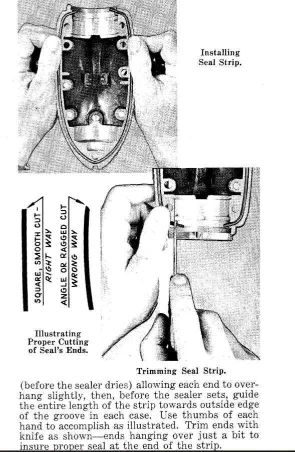

        I have done a few  and .103 spaghetti  seems to help along with a  full smear of Permatex aviation sealer on mating surfaces  and  under   under  screw heads.   Very spaghetti
        important to square cut the spaghetti so it butts  square (see manual)
