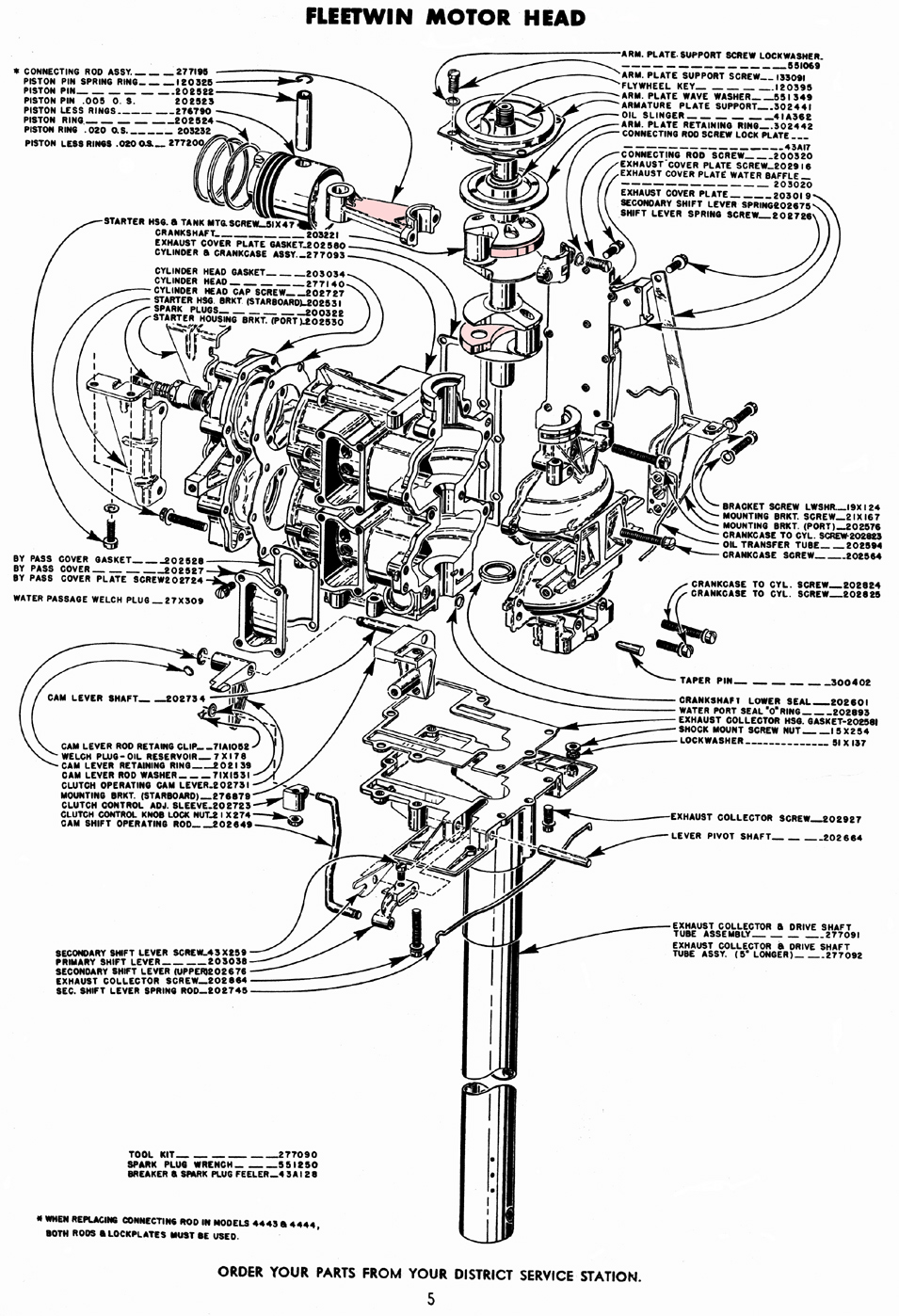

                    Garry, thanks for the information. It’s nice to see the "evolution"
                    in the Fleetwin. They probably got the bugs out of the neutral shift
                    units, then switched over to the F, N, R models!
                    Would you happen to have the 1952 Fleetwin power head
                    parts blow up? 20Mercman is wondering if the rods ( # 277195) in his
                    1953 Fleetwin are the same as my 1952 parts engine.
                    Thanks!
                    #59169
                      Glad to help. They had problems with the top counterweight robbing the top rod of oil. That is the reason for using the rich fuel/oil mix. (Quart to 4 gallons) . . . 😀
