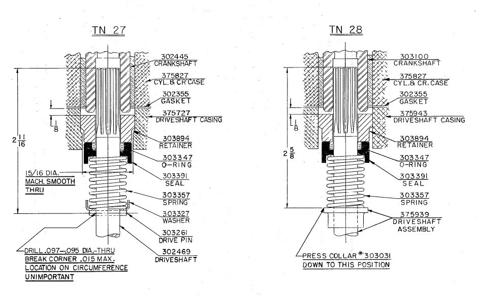

I have the following for the drive shaft seals on the TN 27, 28.
I also have a "parts" pdf file on the TN-25, 26, but I don’t
know how similar they are to the 28.

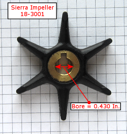

The impeller photo is for substituting a more modern impeller
into the TN-28

Checking it over today i noticed the collar on the top end of the drive shaft has a crack in it. The above diagram list the number as 303031, I’ve been surfing for one not having any luck finding it.
