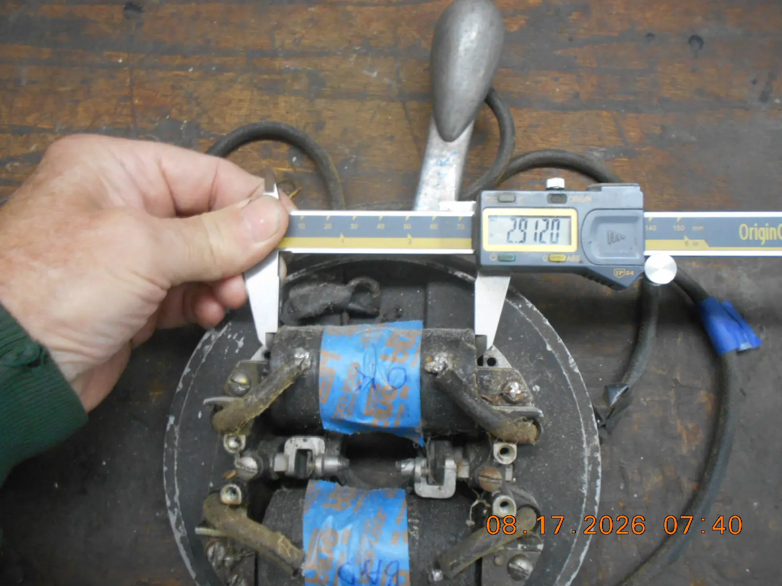

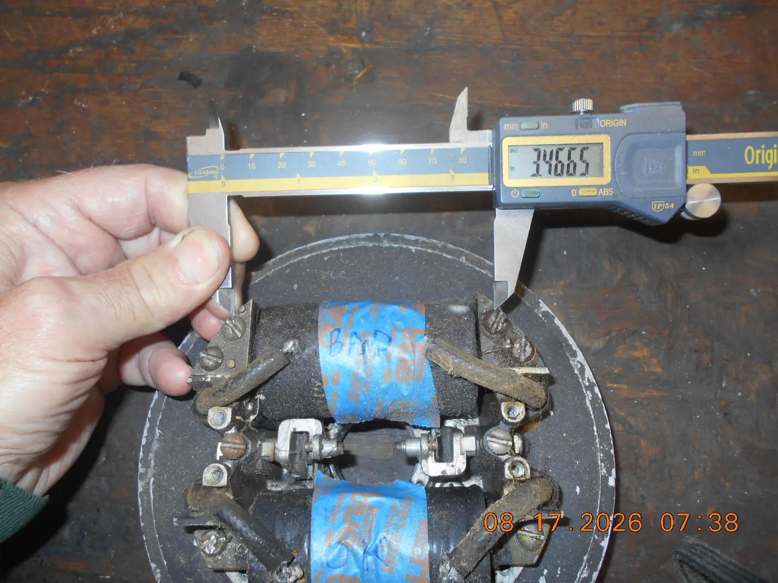

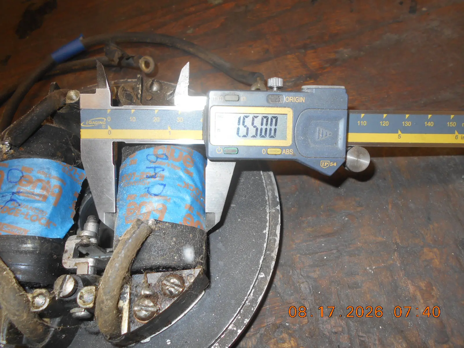

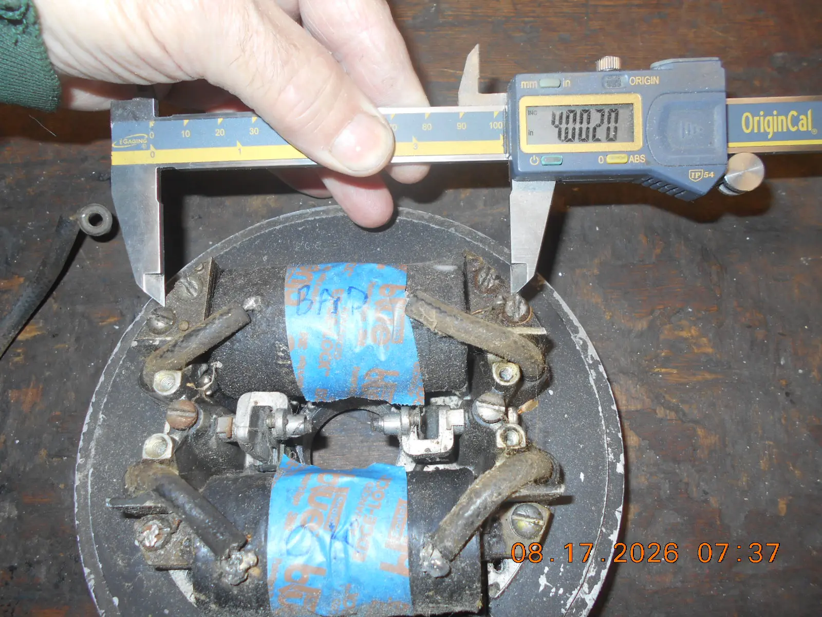

Ok so as it turns out i do have resistance on the coil itself of 0.5 ohms but I have no resistance between either of the spark plug attach points and each other or to either side of the winding is this normal. This engine was made almost 60 years before I was born so I’m doing a lot of learning haha the coil measurements from mounting hole to mounting hole are 4 inches for the wider holes and 3.5 inches for the narrower hole the coil itself is 2.85 inches long and 1.6 inches in diameter. Thank you in advance for all the help.

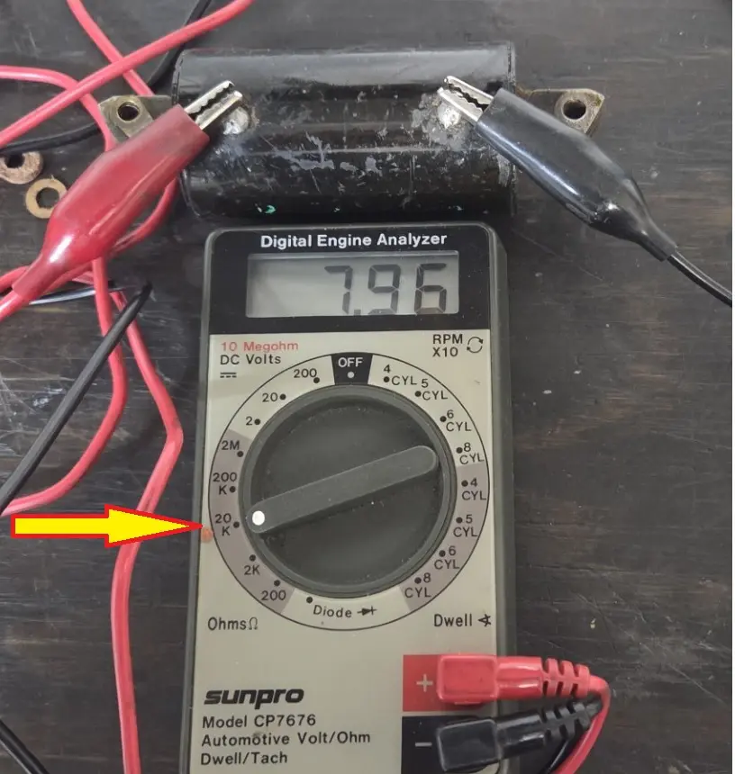

August 16, 2026 at 9:51 pm #326507August 16, 2026 at 10:29 pm #326510Test the secondary (high voltage) winding as depicted in Tubs post. On a good coil you should see about 7, 000 to 8,000 ohms. The reading of 0.5 ohms that you saw was for the primary ( low voltage) coil. 0.5 t0 1 ohm is good. Extremely rare for the primary winding to be bad
