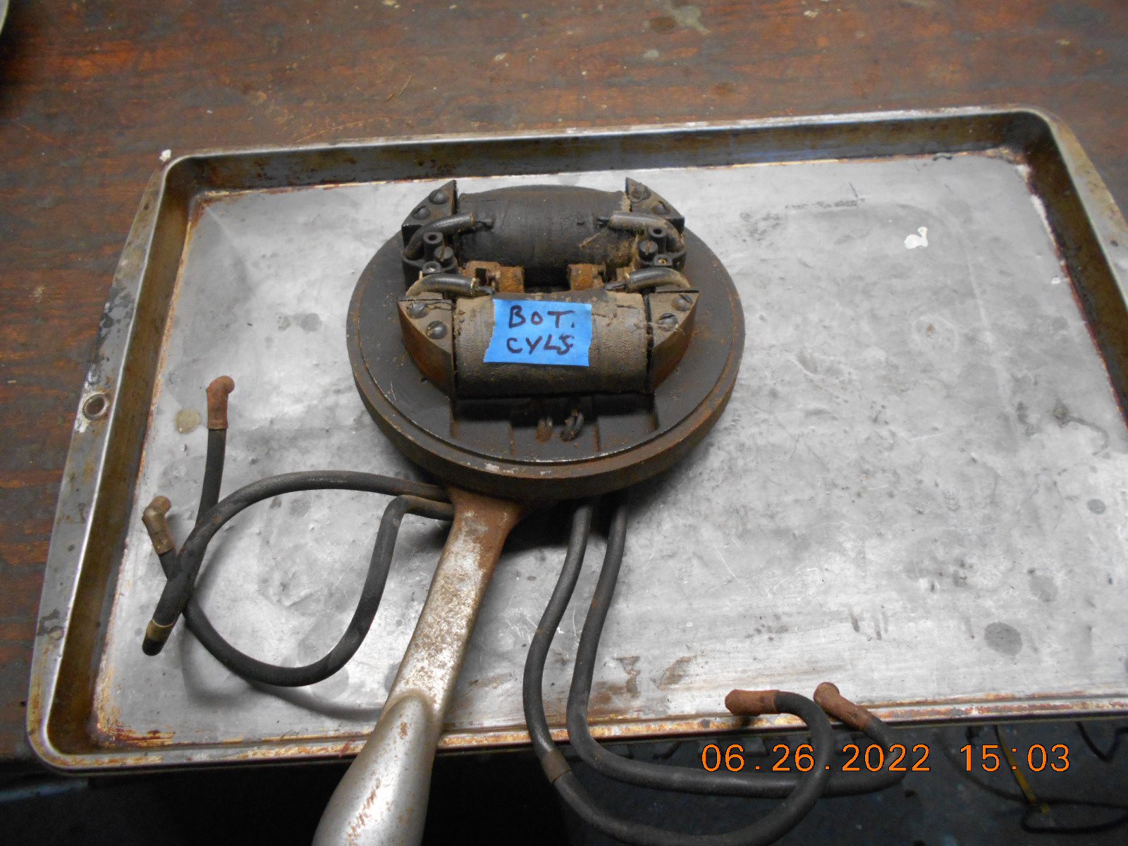

        Well I got it all back together. I e gotta figure out something on the throttle linkage as the old one is broke, bit shouldn’t be much trouble. How do the plug wires go? I put the 2 wires from rear coil to top cylinders and front coil to the bottom cylinders, sound right?
        It's a jungle out there.
        #262479
          You’re correct.

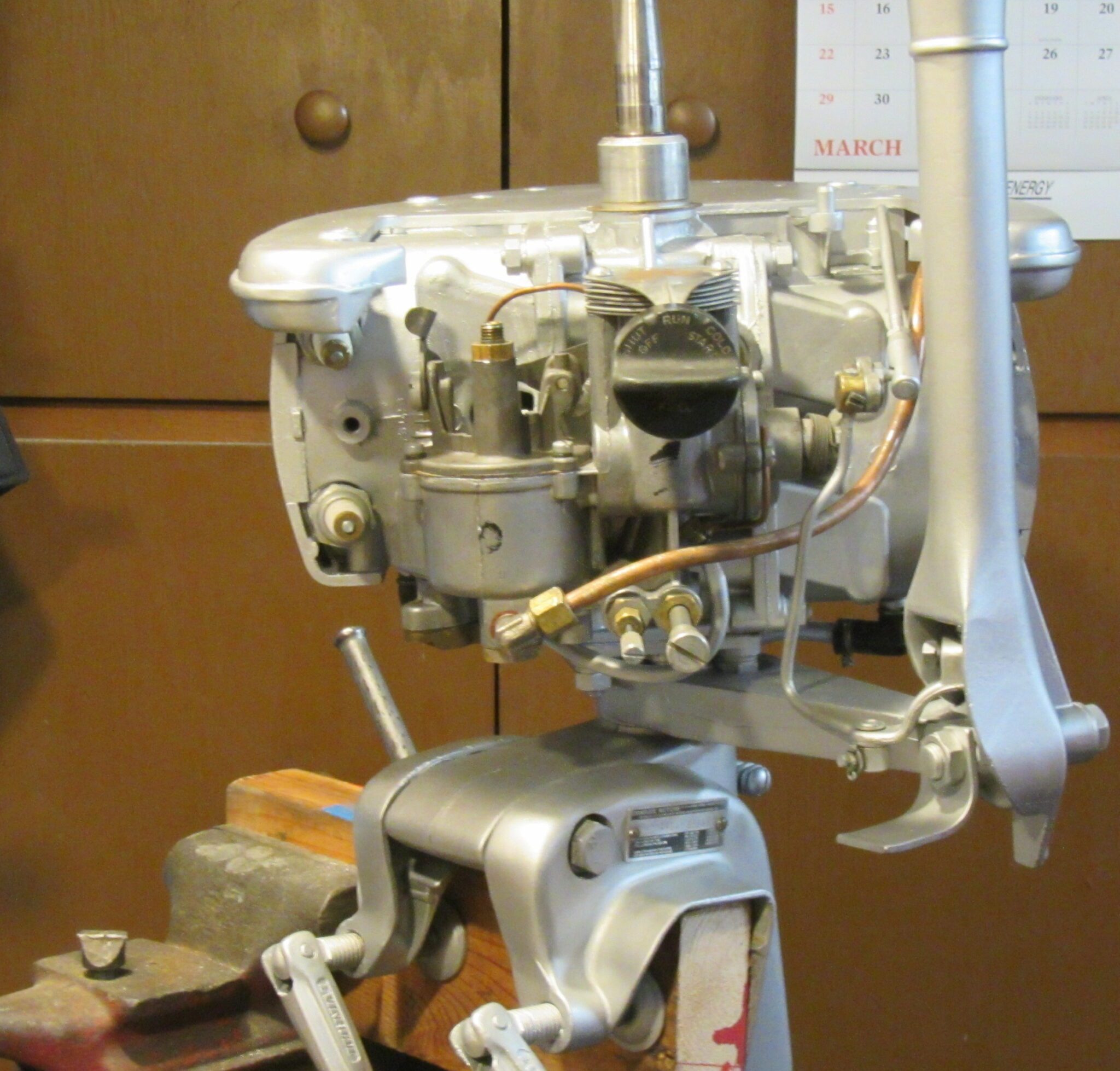

              Also does anyone have a picture of what the original linkage from the tiller throttle looks like? I tried to salvage mine but not having any luck yet.

                Here is a picture of a Zephyr throttle hook up.  I have 32 pictures of my light four but non of the throttle.   Maybe it will help.
                dale

                  That may do it. Very much what I had pictured in my mind for the lightfour. You only have the narrow slot in the front cover to work with
