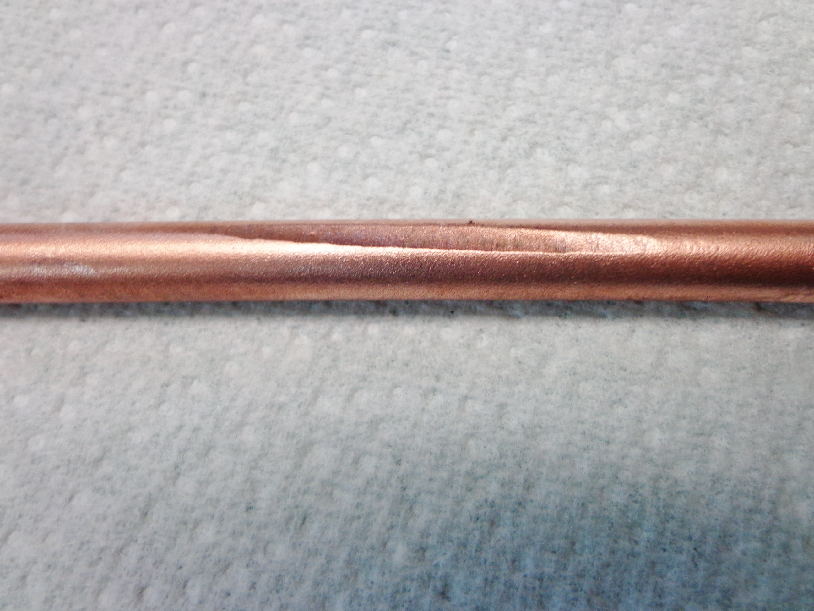

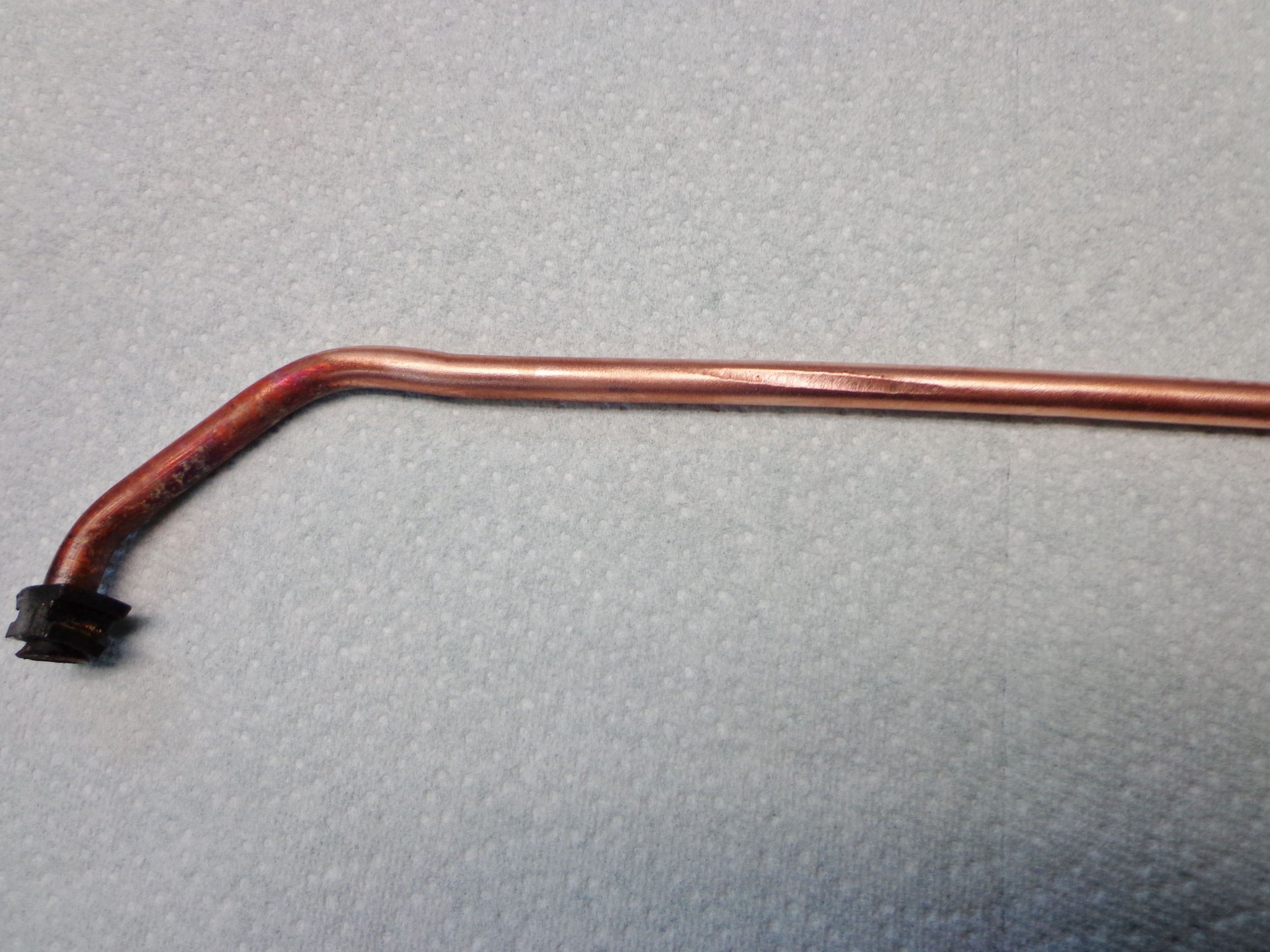

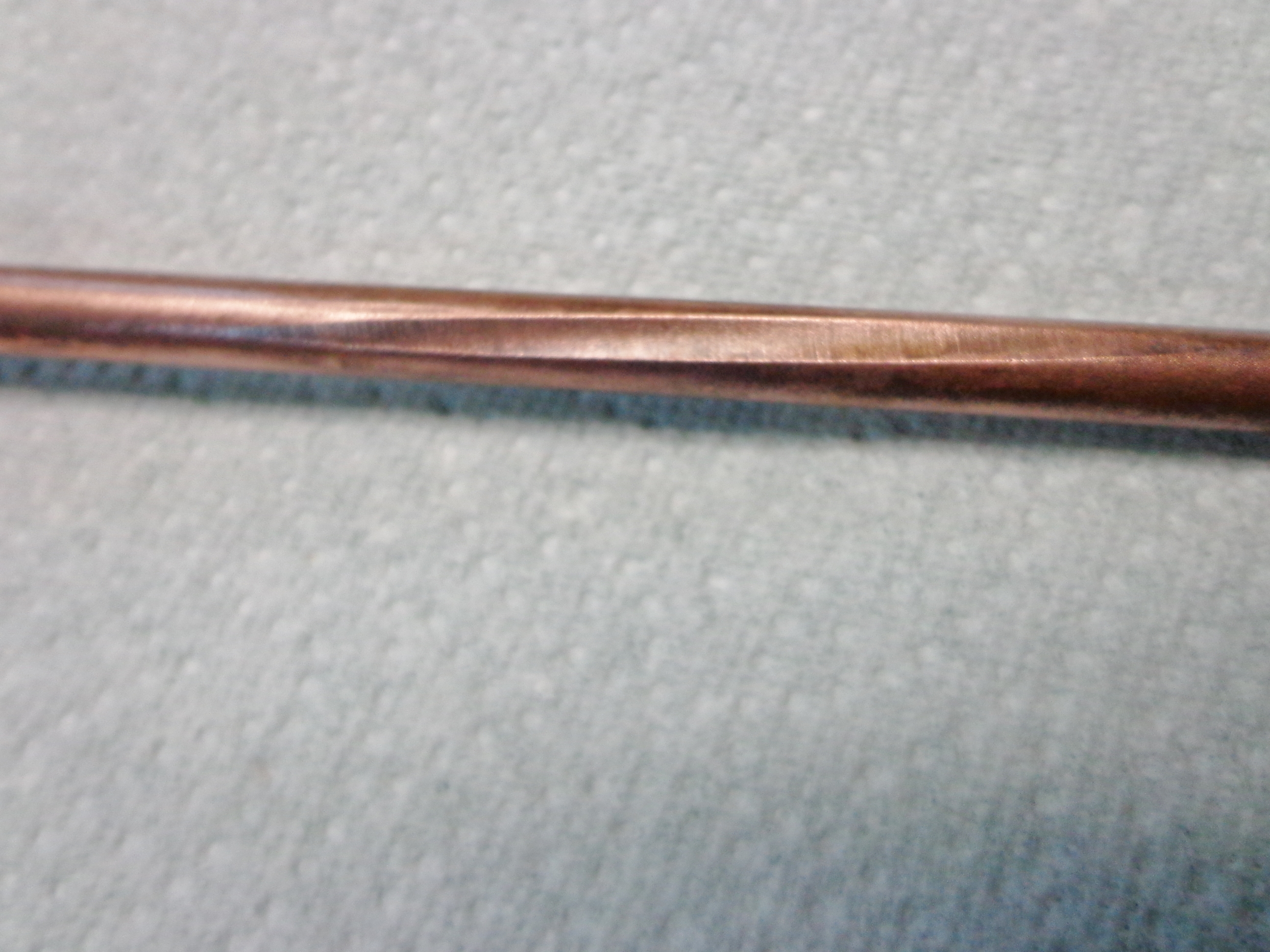

              Something else to watch out for on the smaller motors is the water tube. Being made of soft copper, it can get bent quite easily while reinstalling the gearcase and then rub on the spinning driveshaft causing a worn spot which will eventually wear right thru causing a massive water leak. Water meant for cooling purposes can’t do its job if it’s hemorrhaging out of the water tube.
              #79749
