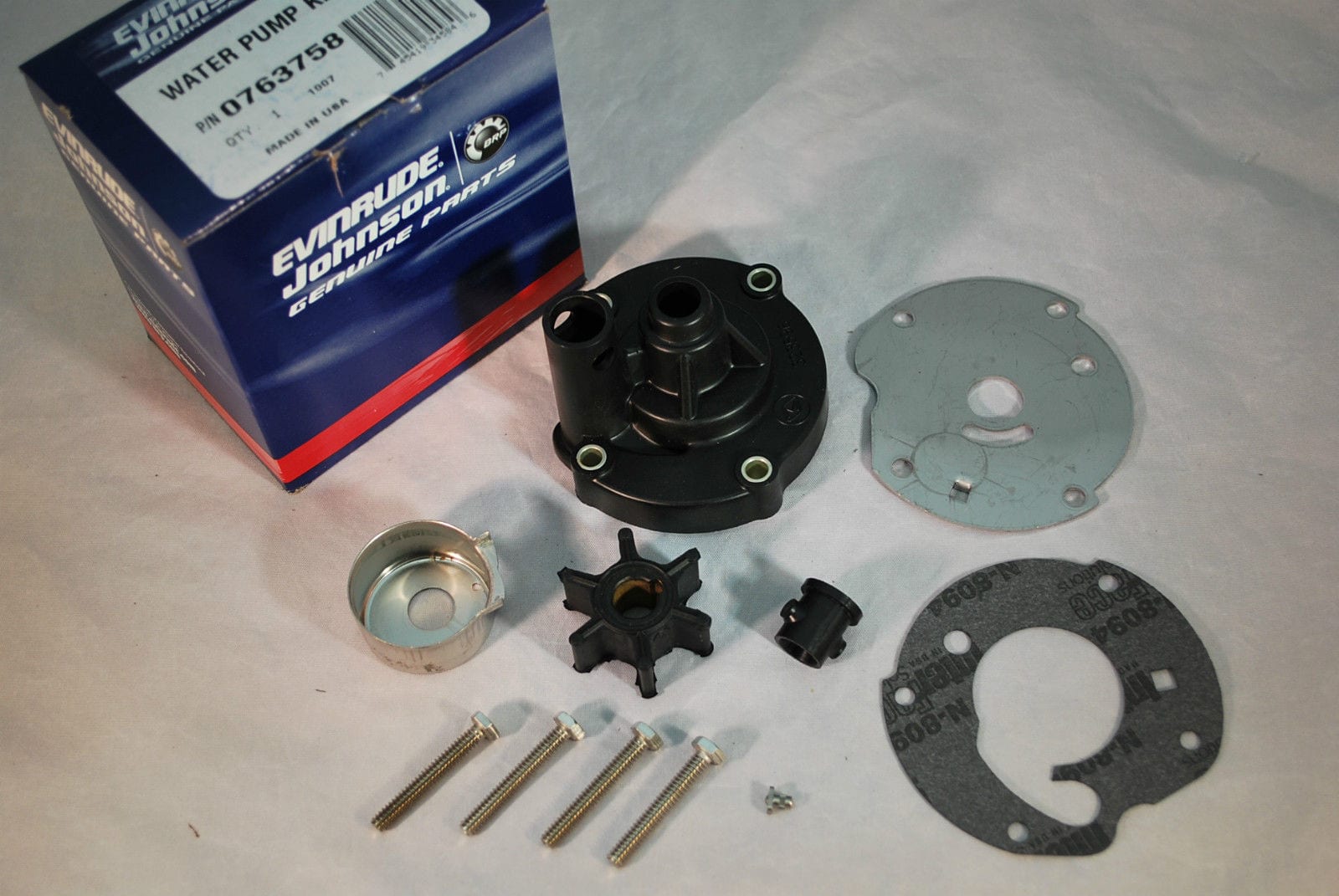

              The gearcase and water pump sure resemble the ones used on ’77-’79 six horse motors. If you can give me some measurements of the liner and shaft size I can compare them to some 763758 six horse pump kits I have on hand.
              CD-Water-Pump-Kit-763758

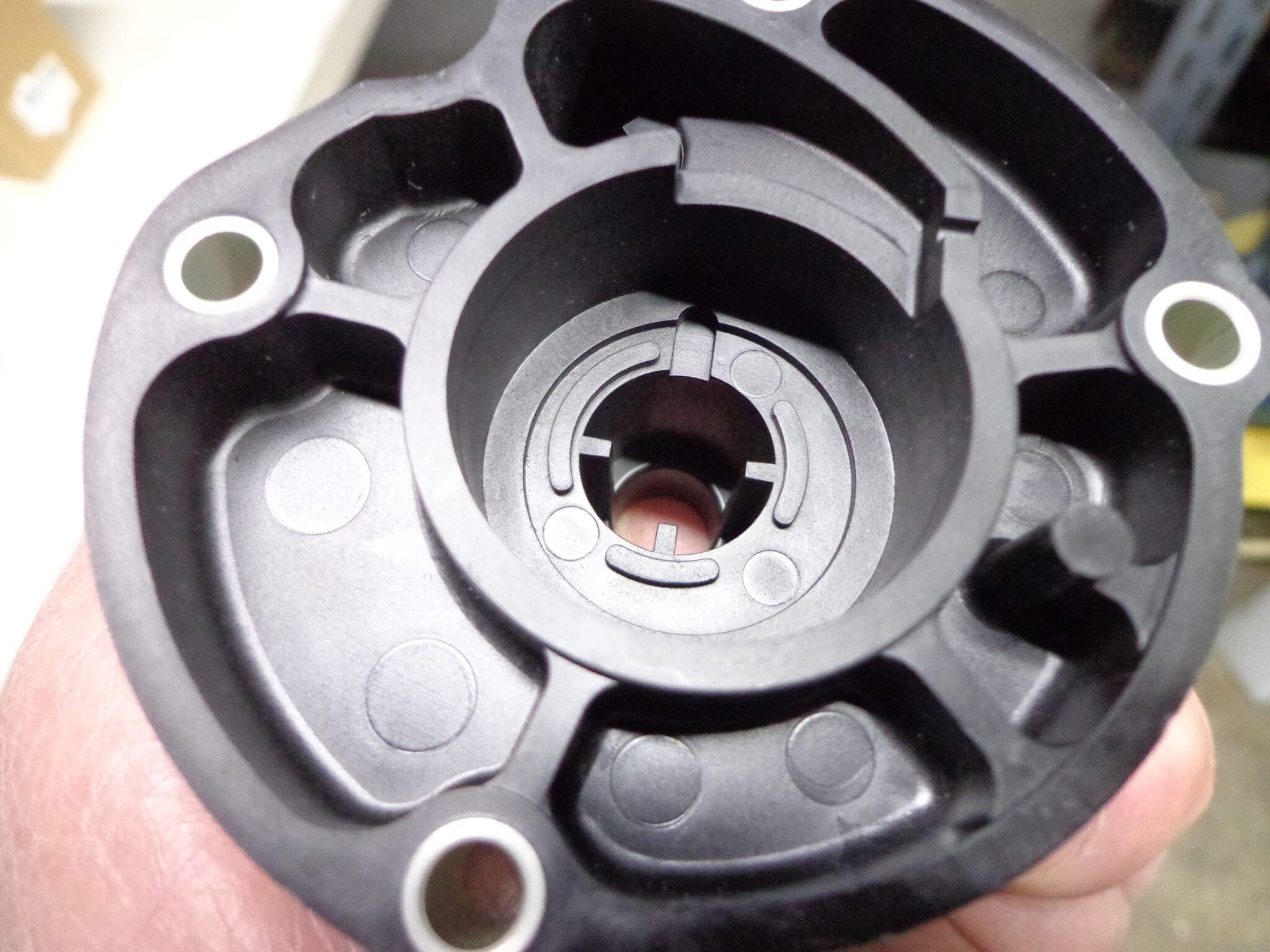

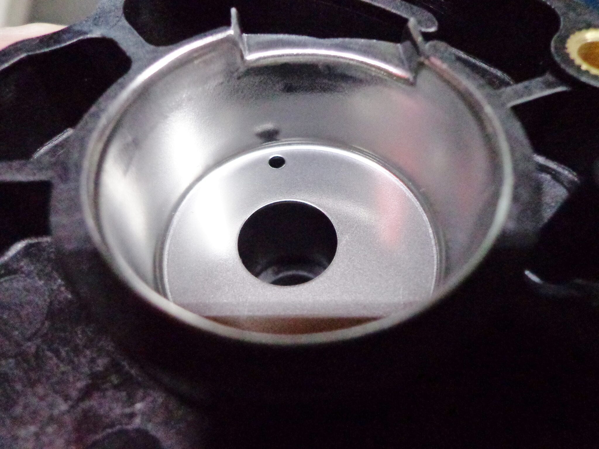

                Well, I have not had any luck finding a parts list for this yet, but will keep looking… I think the driveshaft on this one is thicker than the 6hp, will try to find the part number for a complete updated kit for the 10hp models…D
                #240922
                  I think you are right as OMC might have updated the ten horse style water pumps used on these motors like they did on the 77-79 six horse motors. A plastic housing with a liner and small diameter impeller.

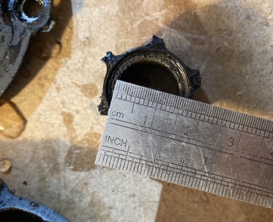

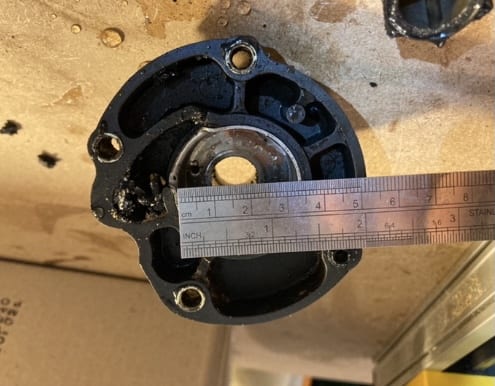

                      I have attatched some photos with a ruler for scale.
                      2C7804C1-B961-4371-846F-0471E637F48F
                      DC685D8F-C855-4A96-A04C-10B54A770483
