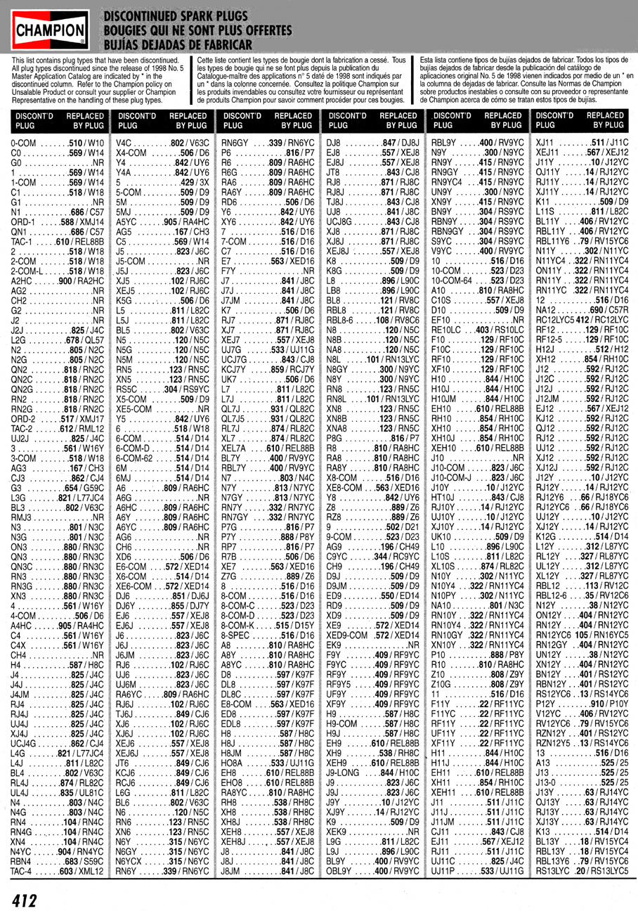

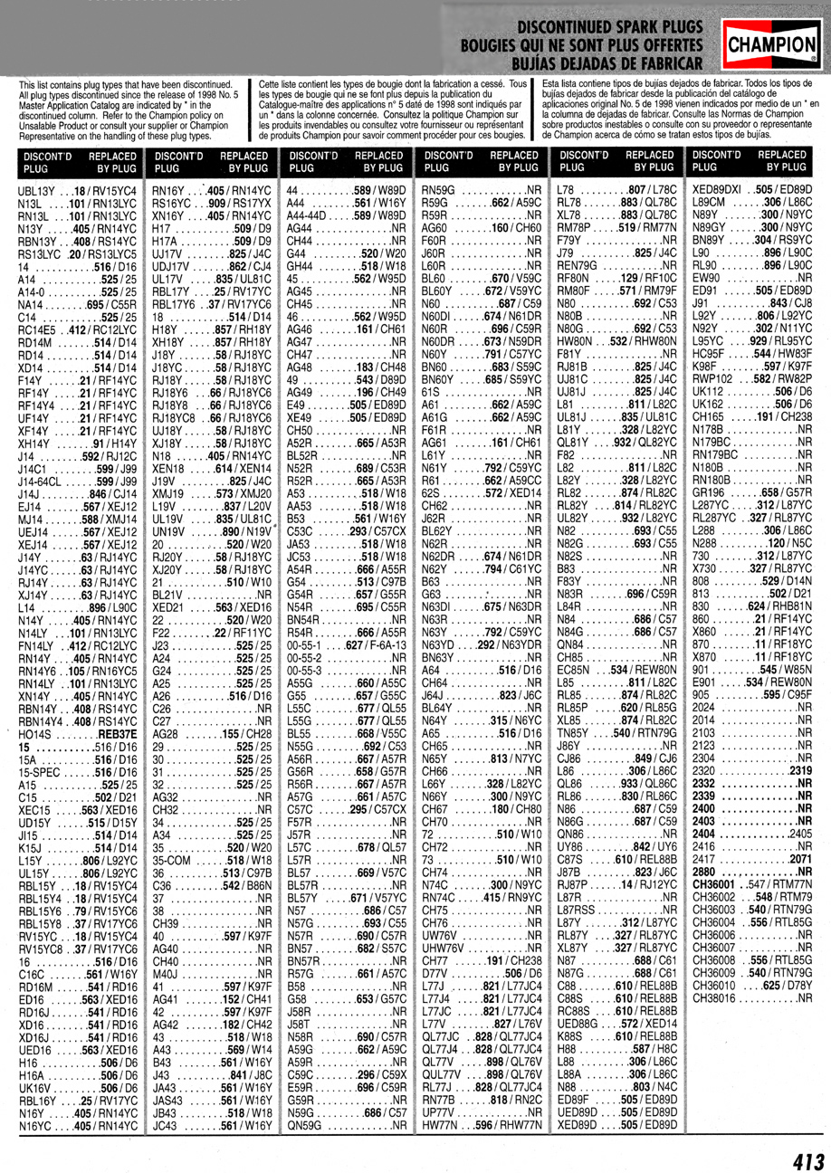

      Dose anyone have a chart that shows what sparkplugs the 40s to 50s OMC models take. So I can get the right plugs for some of my motors.
      #63764
        The Old Outboard book has two charts in the back of the book. Could you list what motors you need info on ?
        #63767
        David Stanton
          Just about all 1950s OMCs used Champion J6J plugs. Today’s offering is a Champion J6C. The C stands for Copper electrode. When you get into the 1960s, the bigger motors (40 HP up) mostly used the cooler J4J.
          I sent you a PM with more info.

              good thing is just bought a bunch of J8C’s and J6C’s got 14 and 24 respectivly for the H10 as i think my FD10 takes H10’s could i sub in j8C’s as i see they are between J7J and J8J and people have for other motors said to sub in j8’s for them.
              #63787
              chris-p
                No. Keep the J8Cs out of them. Too hot.
                As stated before, for 50s OMCs, in general use J6C or if you can find them J6J. Not sure what H10s are , never seen them in a motor before.
