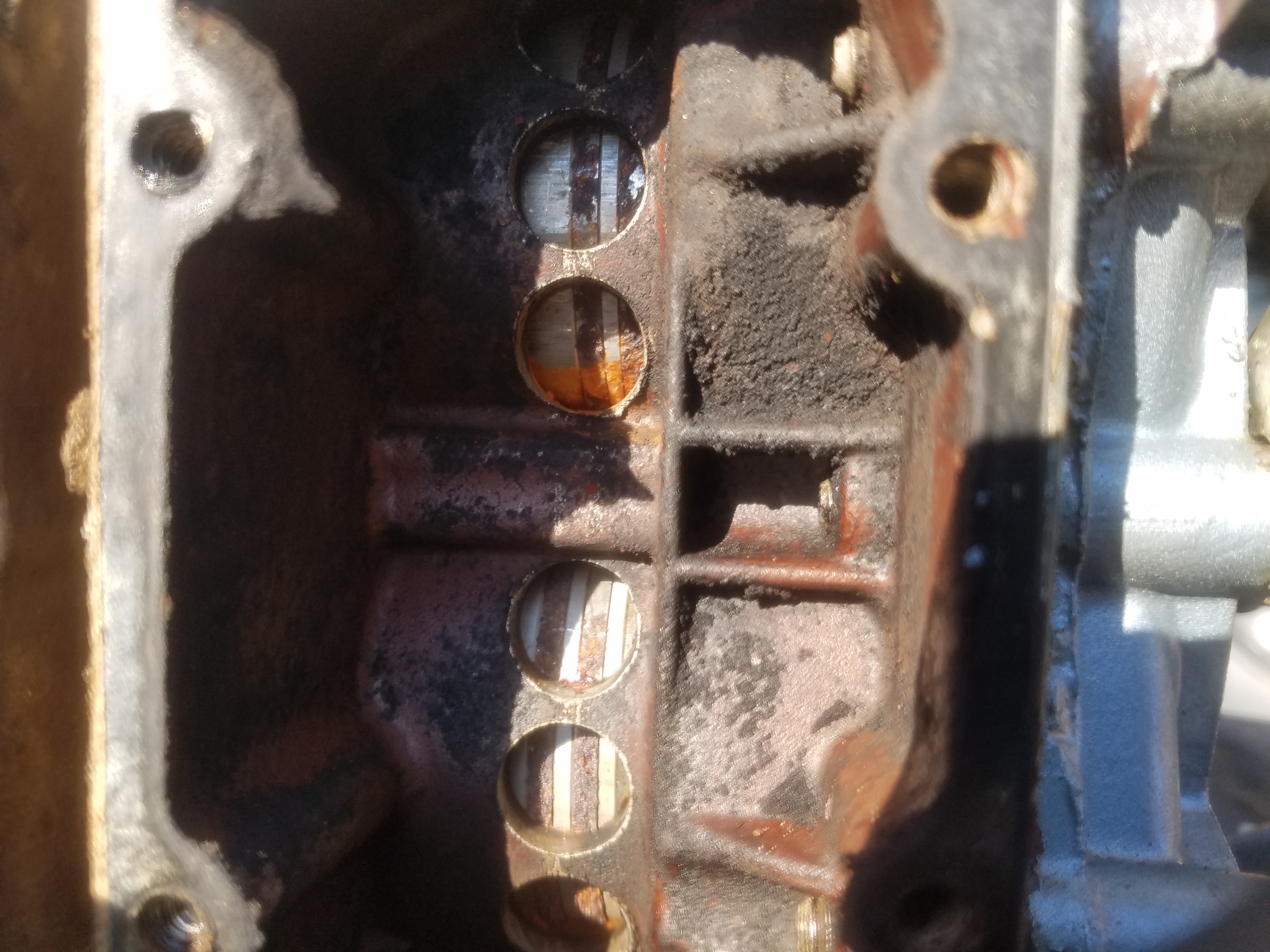

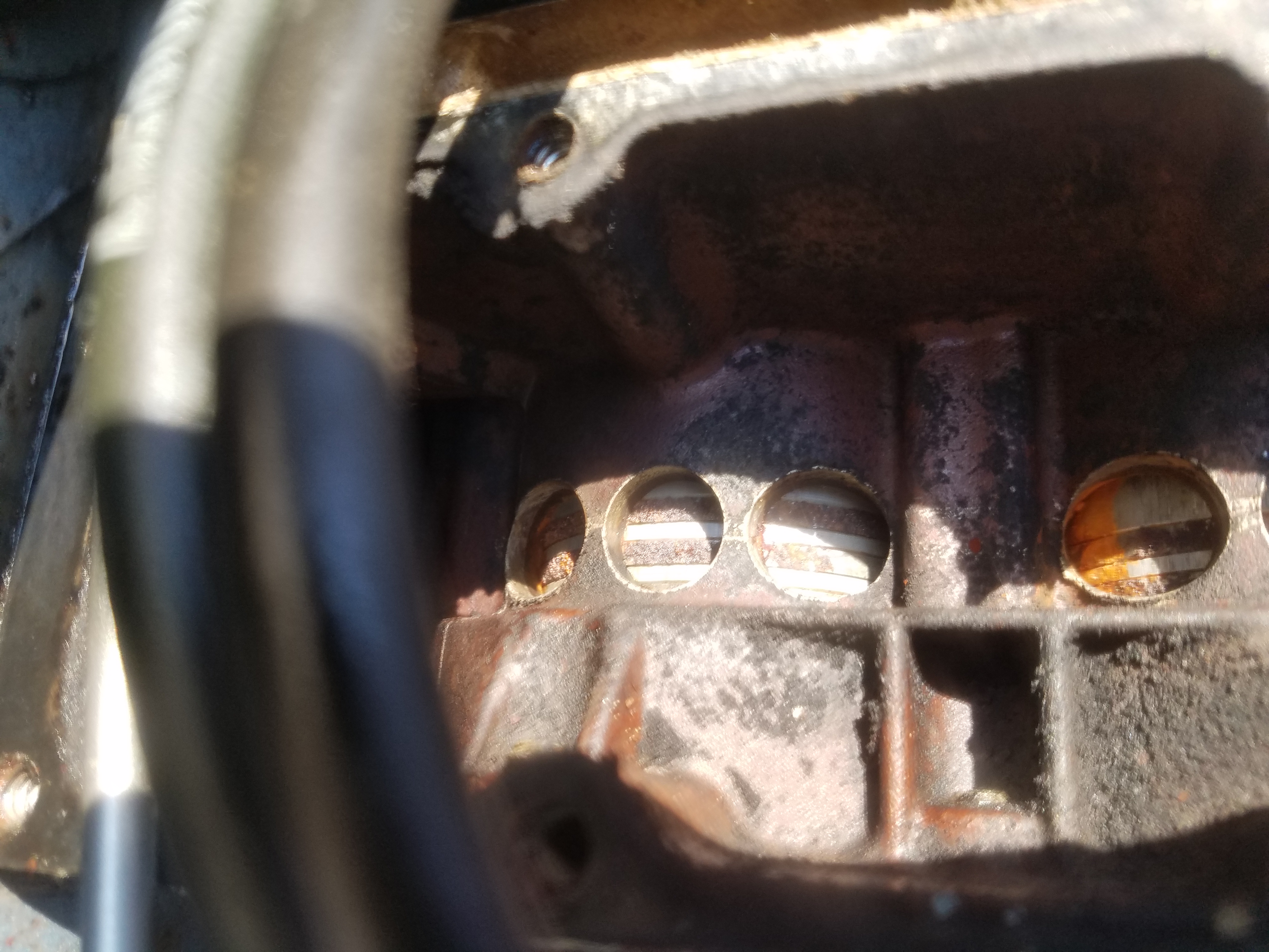

Will try to hook up a water source to see what the actual flow looks like. Bob DJuly 23, 2023 at 4:36 pm #278413Ok did a few water tests.
In picture #one the bleed hole under the exhaust cover drains properly into the water jacket around the cylinders. From there it’s flows out the from the cylinder water jacket (bleed hole in picture two) into the water discharge. Nothing clogged everything working as it should. Still not finding any way for the water to cool the exhaust.Bob D

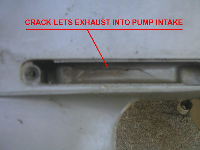

July 23, 2023 at 8:20 pm #278421OK, at fleetwin’s request, I’ll jump in and look. Seriously, I think y’all might be barking up the wrong tree. The water passages in those motors are big enough to throw a screaming cat through. Original post says it was steaming out the water discharge, I suggest you revisit the water pump, looking for exhaust leaks into the pump. And of course the pump housing.
Posting a picture of a problem that I’ve seen.

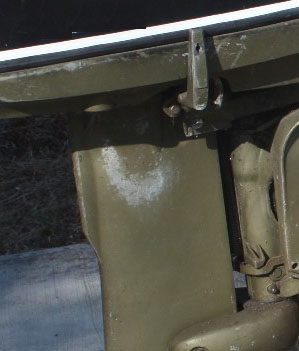

July 23, 2023 at 8:55 pm #278424The exhaust housings on those motors do get pretty hot. Ok maybe not this hot. From a junked motor. Just sayin’
