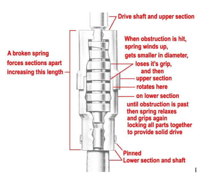

        Sounds like a classic example of the spring loaded shock absorber below the water pump has done its job and is now longer than the 6 11/16″ it should be.
        Here’s a link to an older thread about this problem:
        https://www.aomci.org/forums/topic/omc-pinion-shaft-shock-absorber/
        #246826
        kayaker2
          Didn’t know what the problem could be. Thanks! if I cant get this shock absorber thing to go back to dimensions, I do have lead on another one. Maybe a water pump base also.
