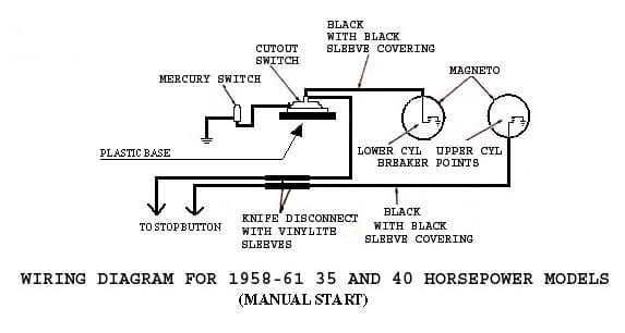

        Well the first thing you need to do is pull the flywheel and add a wire leading to the upper cylinder’s breaker points because the ’57 models didn’t have a kill switch. By adding the extra wire, you will be updating it to the ’58 model which did have a kill switch. Here is the ’58 wiring diagram for the kill circuit. You should already have everything except the one black wire leading to the upper cylinder breaker points.
        Wiring-1958_61-35_40hp-manual-start-1
        #206371
          by linking the 2 points to a normally open switch should allow you to kill the engine by just shorting the points together with a small button switch (console mounted or engine mounted)
          you could also be fancy and hook up a remote kill button by just just installing a set of normally open contacts… controlled by a small remote …wireless switch
          you have the 12v to feed the remote wireless controller tucked away close to the engine .. or inside the cowl
          https://www.amazon.ca/eMylo-Channel-Wireless-Universal-Transmitter/dp/B01A6VOI6Y/ref=sr_1_49?dchild=1&keywords=Wireless+Switches&qid=1592822555&sr=8-49
          that way you can kill the engine from anywhere in the boat when the big fish strikes 🙂
