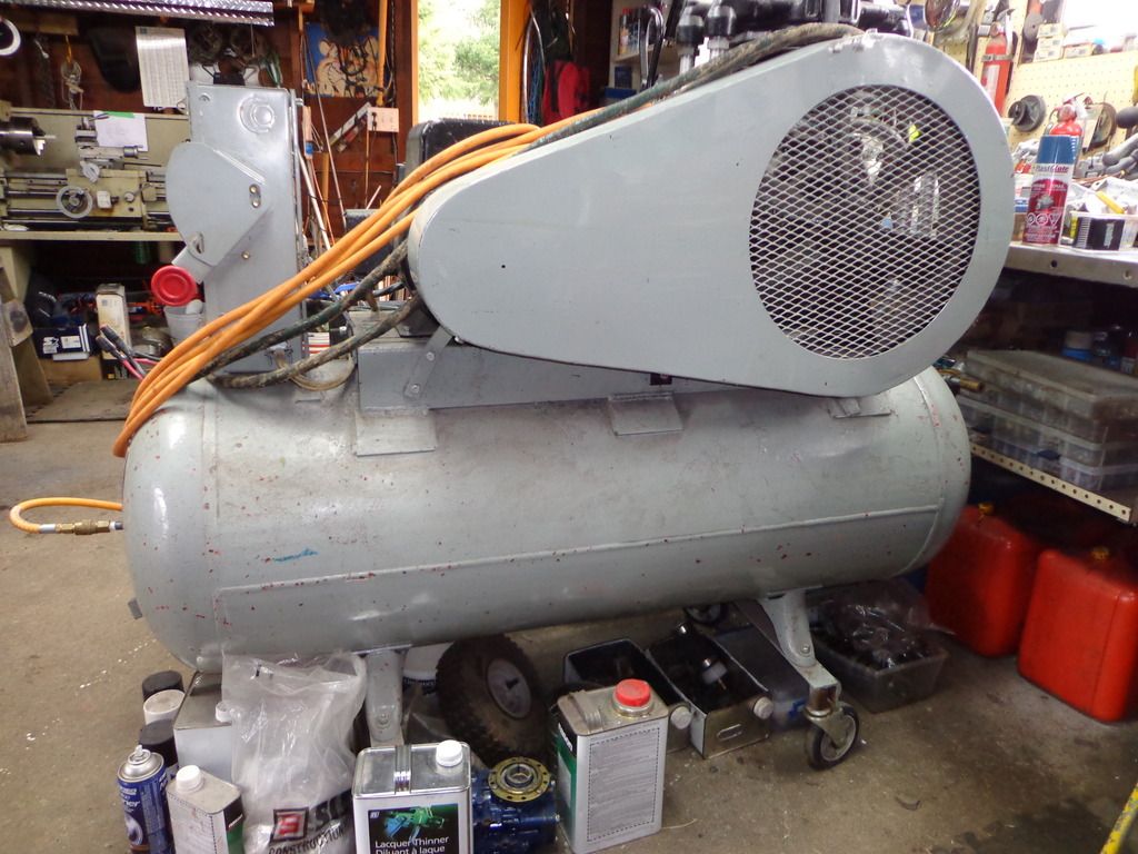

              Exactly! You can never have ‘too much’ air but it’s very easy to have ‘not enough’. ☺

                Holy Cow Mumbles, that will do it! That would keep up to my sand blaster lol

                    Mumbles that’s kinda over the top. LOL ๐Ÿ˜†
