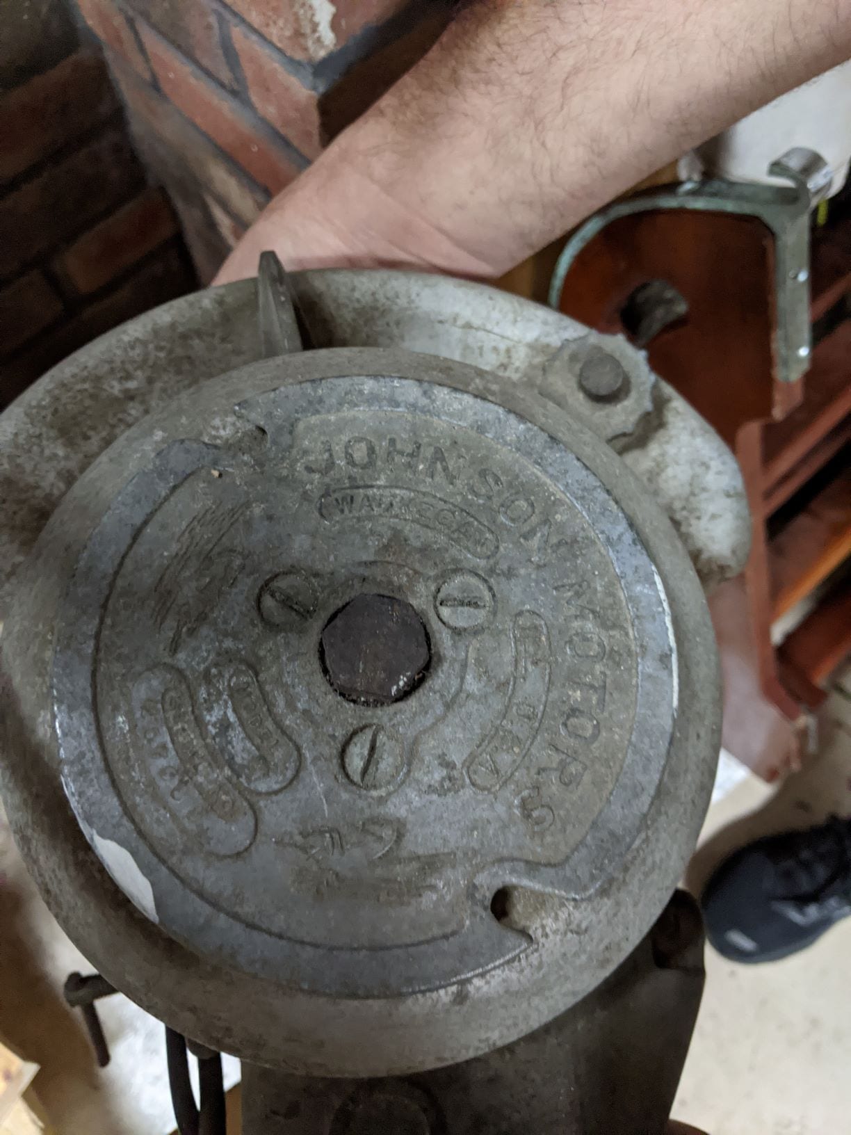

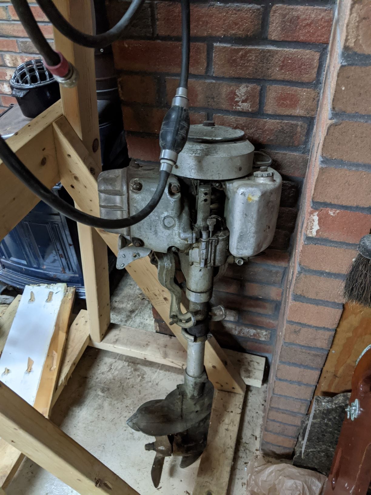

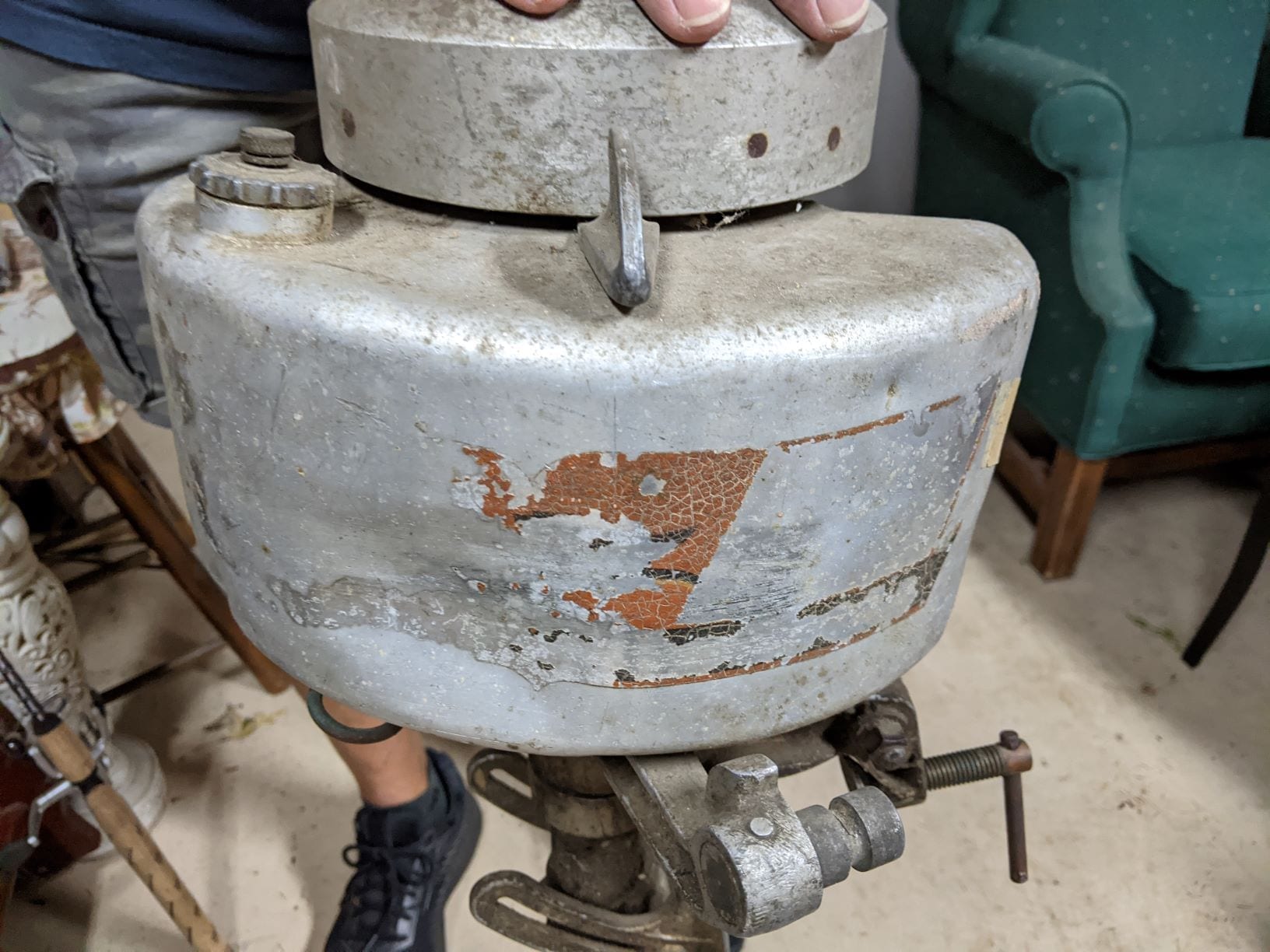

      I will be picking this engine up in New Hampshire in a few months but in the meantime here are a few pics. The serial number looks pretty bad. Is there another place on the engine I can have someone look? Or does anybody have a good guess?

        maybe a 1937 Johnson 4.2 HP Outboard Motor
        the model number and serial number will tell the truth
        if you can post it better

          I will try to get another pic but fear that the model and S/N are pretty corroded. If they are how do I go about ID ? Is there something on magneto? or other engine parts that will help solve the puzzle?

            Decal is 1937. Serial number should be on the block as well.
            Wayne

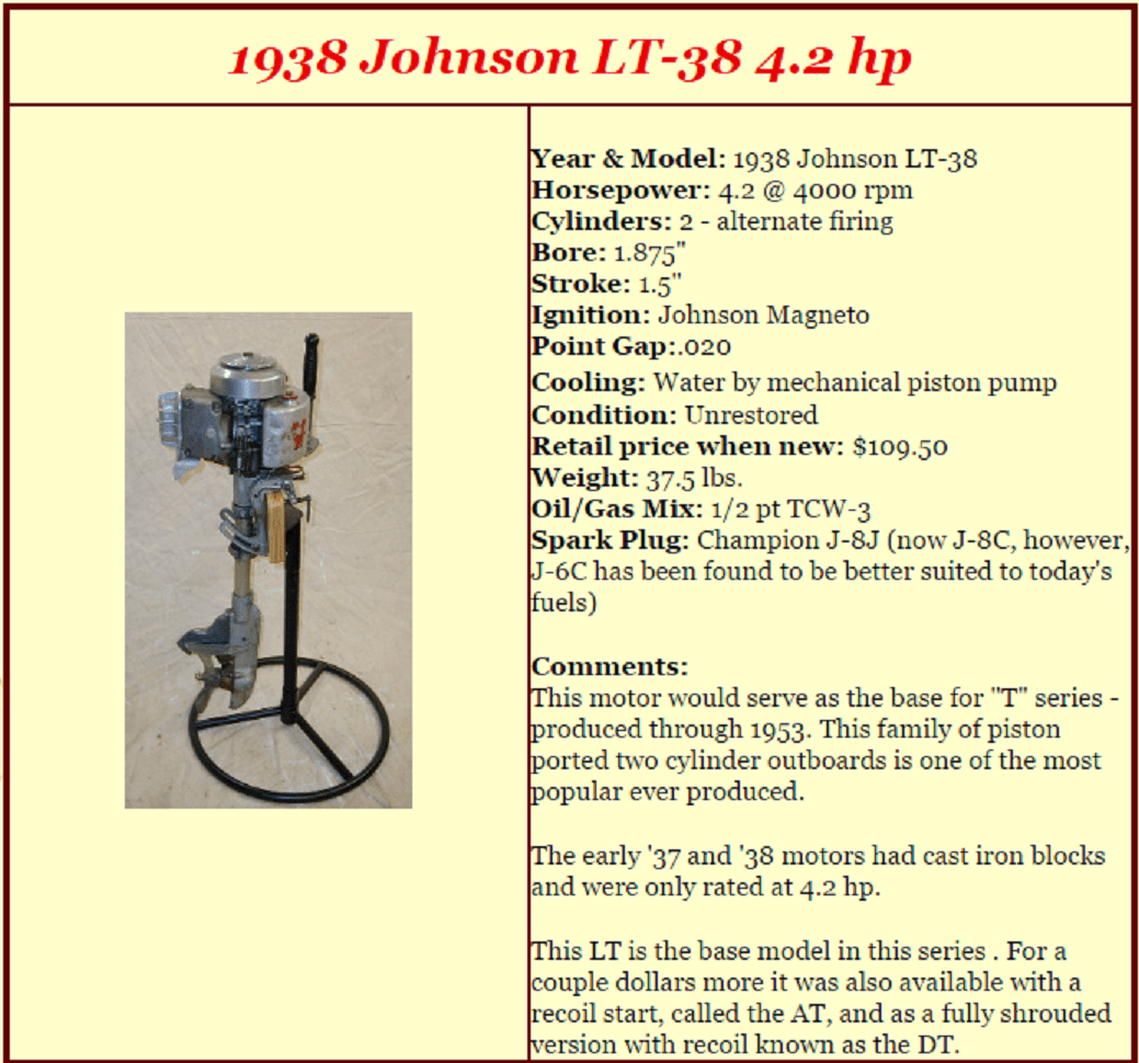

                Here’s a 1938 for comparison ….
                1938-Johnson-LT-38-4.2-hp
