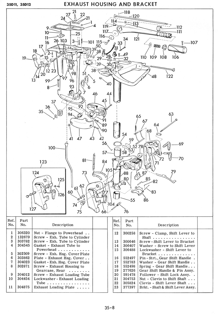

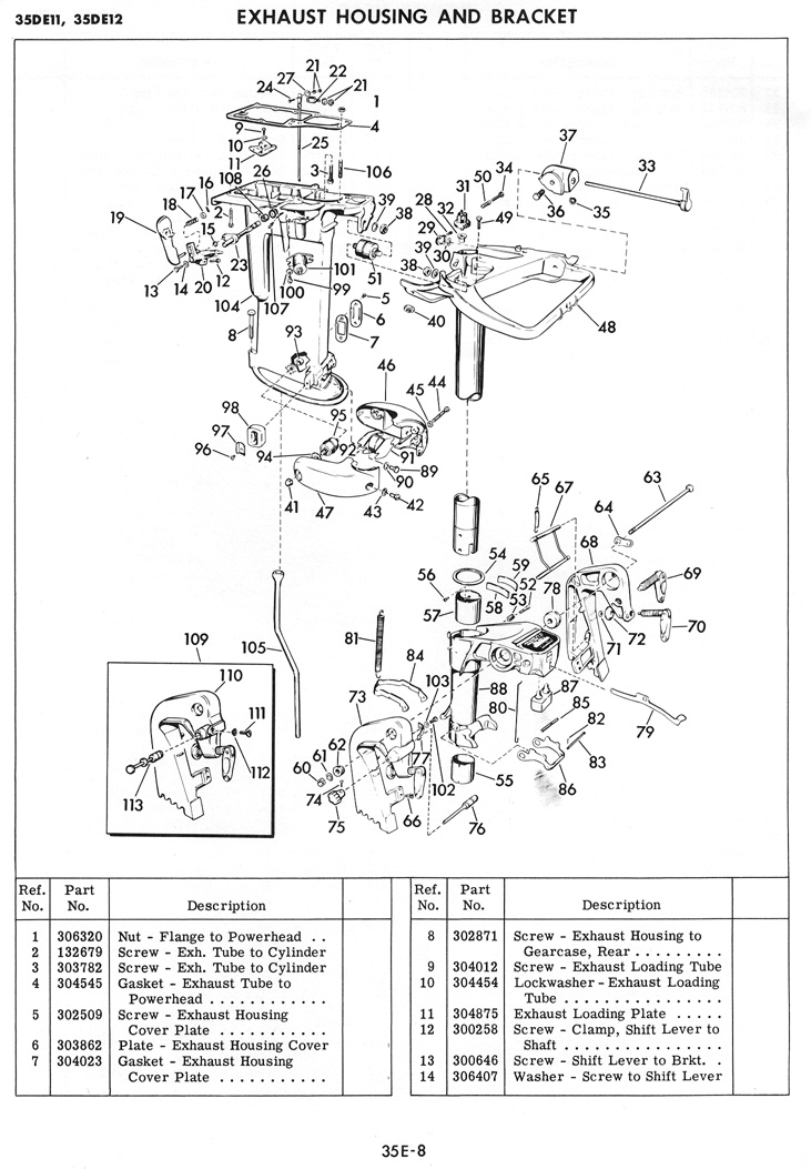

          Interesting – the electric start model doesn’t show a tiller.
          1959 35 HP E start
          1959 35 HP standard
