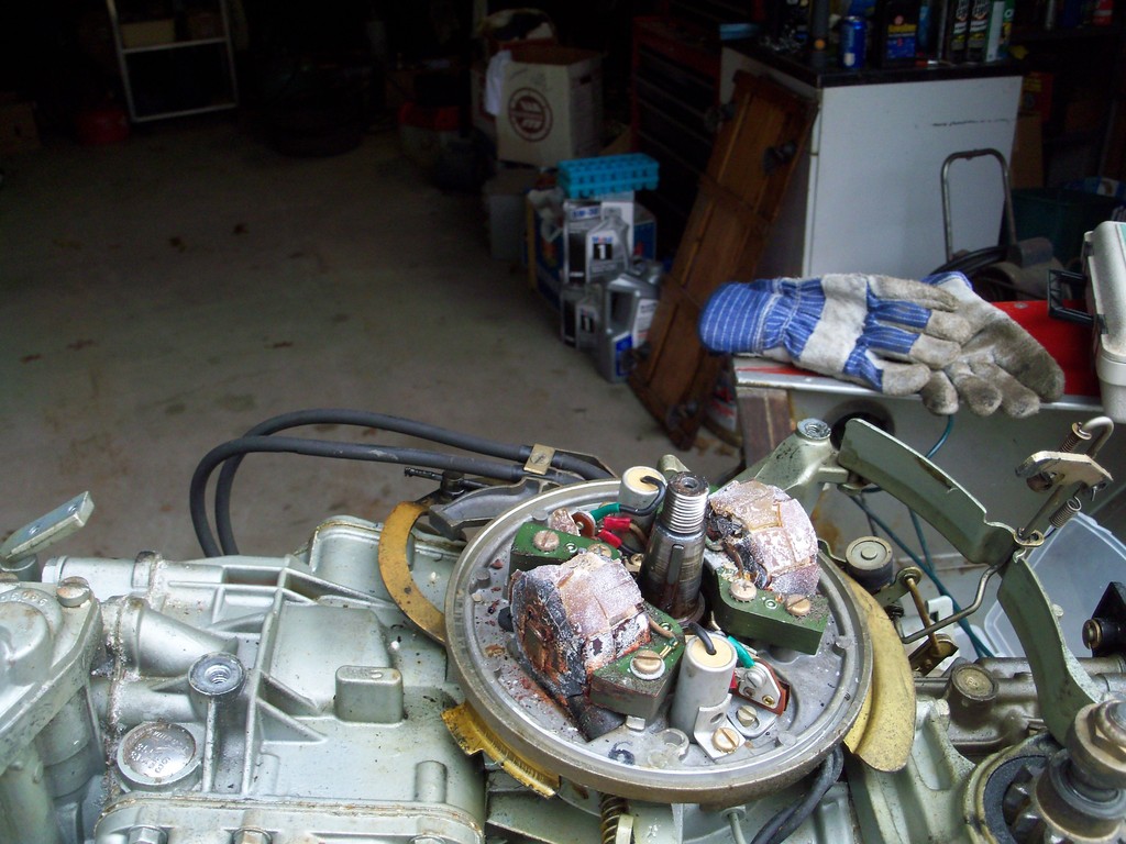

        Welp. I did that and there is good and bad news.
        Good news is everything electrical looks beautiful
        Bad news is this looks pretty bad.
        Sooo….lol about pulling the flywheel…..lol.
        Anyone have a part number for this? What next?
        Thanks

        lindy46

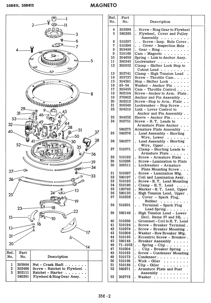

          Beautiful, eh?? You have original coils and condensers and most likely points. I’d replace everything under the flywheel including the plug wires. Part numbers are in the diagram above.

              The old coils have pins thot the high voltage spark plug wires pushed into. You will note the new coils have screws, so the wires will be twisted to thread them in place. – these pages for your information . . . 😀
              #61517
                Those coils are good news. They mean it hasn’t been run since many, many years ago. Guessing 40.

                      Take some old spark plugs (any type) and bend the gap open at at least 1/4 inch and see if you still have spark jumping. I’ve found that to be a pretty good indicator, but I’ve also seen recommended that you have 1/2 inch spark outside the motor with no compression. If you take off the inspection cover on the flywheel put there to access points, turn the flywheel and look at what you can see of the coils. Here is a photo of what Garry is talking about when those old coils age – these are really aged bad! It starts with a couple cracks in the insulation:
