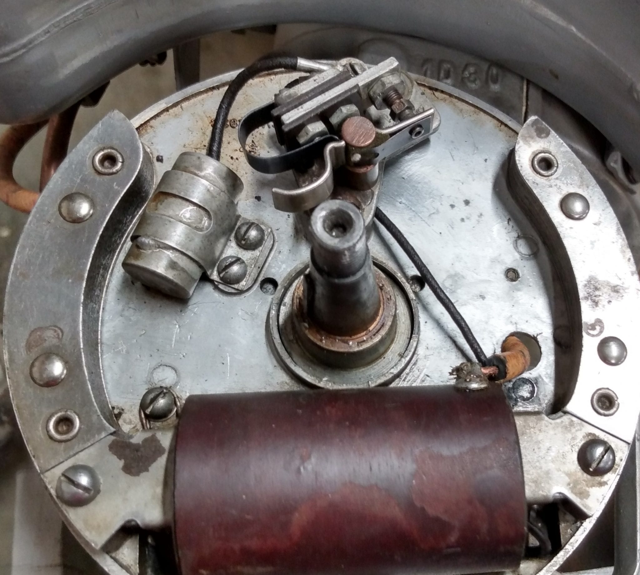

                I’ve heard of wico but don’t know how to identify one. Still kinda new to this, learning a lot along the way thanks to the club. When I get home this evening I can take a pic. And your probably right about the amount of fire, as it was just a tickle to my finger. Just thought it strange I got nothing with points hooked up.

                    Here’s mine
                    IMG_20200618_162602574_HDR2

                    JOHN D.
                      That old condenser may be bad. Go to your auto parts dealer and get one for a 1962 chevy nova six cylinder. They are a 0.02 uf capacitor. And they are cheaper in cost than most.
                      #206105
                      tinkerman
                        Thanks will try this as I’m sure it’s only a few $. Nice to know that part is interchangeable as a lot of the old outboards are .02
